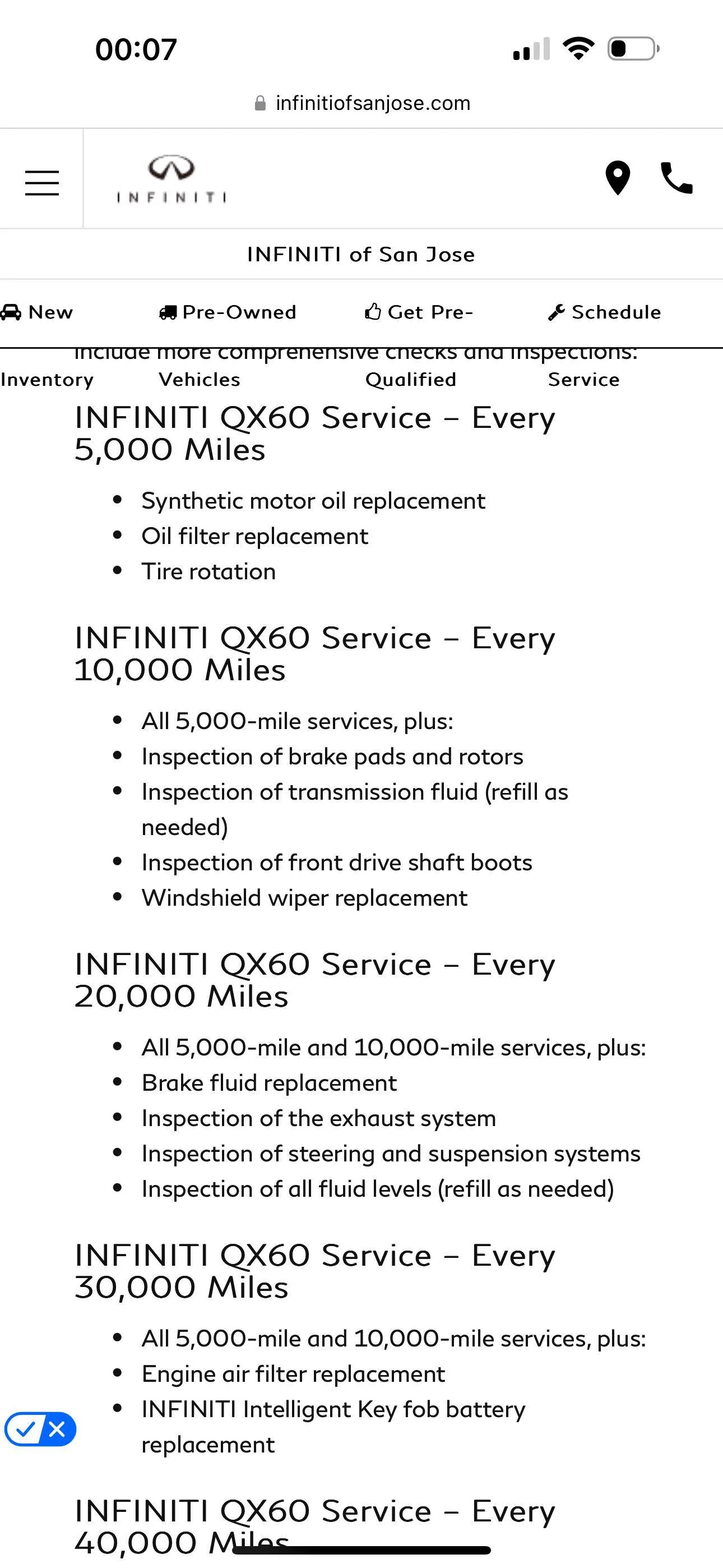

It depends on how the brake system is designed. Old American cars used to use a sealed system consisting of a master cylinder reservoir that provided atmospheric pressure in the system without exposing the brake fluid to air. You may have seen this type of system where there is a rubber diaphragm covering the brake fluid. European cars for 50 years or so have used open systems, which require periodic fluid changes. If the brake system is not exposed to atmospheric pressure, as the pads wear, space in the reservoir is created. If the system is completely sealed, that space eventually creates a vacuum in the system and vacuum-locks the pistons in the calipers.
If have no familiarity with Infinity's design, but if the system exposes the brake fluid to air, it will have a periodic replacement requirement. That said, brake systems can go years or decades without periodic fluid changes and not experience a failure nor poor performance under normal street driving environments.
Ford Mustang Mach-E Done brake fluid change anyone? IMG_3798

that's dealer premium service schedule. I never go by that.
Correct. Follow the manual. Dealers try to perform services that are not required or recommended. So bad that a few years back, Ford sent them letters to stop.
Good grief??‍♂
Really? Follow the dealer's recommended schedule, designed to maximize their revenue? Wow.
