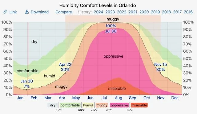

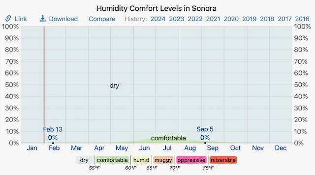

I have one of those testers also. Where I live, the humidity is extremely low and a couple of months ago, I tested the fluid in the GT500 which turns 4 years this month. My tester still showed green so I should be good for at least another year or two before it even gets into the yellow which is when I usually change the fluid. I never let it get into the red area. I haven't checked the Mach-E yet but it's only a little over 2 years old so I think I have some time.
Speaking of humidity, I checked what ours is here in Sonora, CA compared to say Orlando Florida (you mentioned Florida so I picked Orlando as a comparison) and there is quite the difference.

Yes, you now see my nightmare
