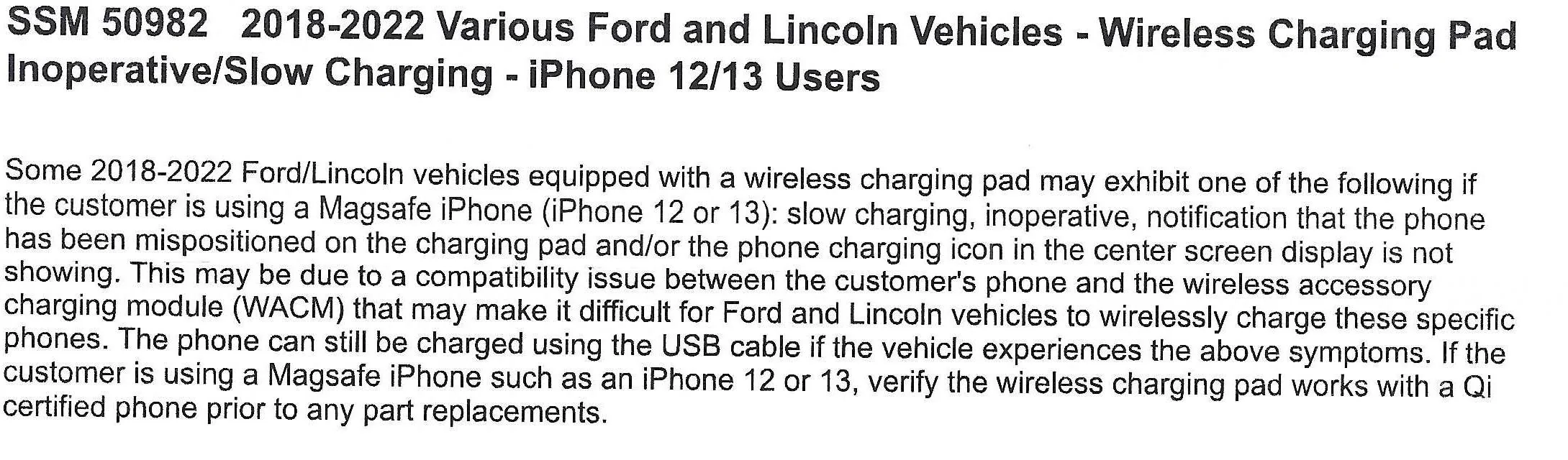

Finally - Just heard from my dealer - New SSM issued today see below - wireless phone charger in 2021-2022 Mach-e may not work for IPhone 12 and 13 users! No suggestion of a hardware or Software Fix! Just Pound sand !
New Class action suit?
