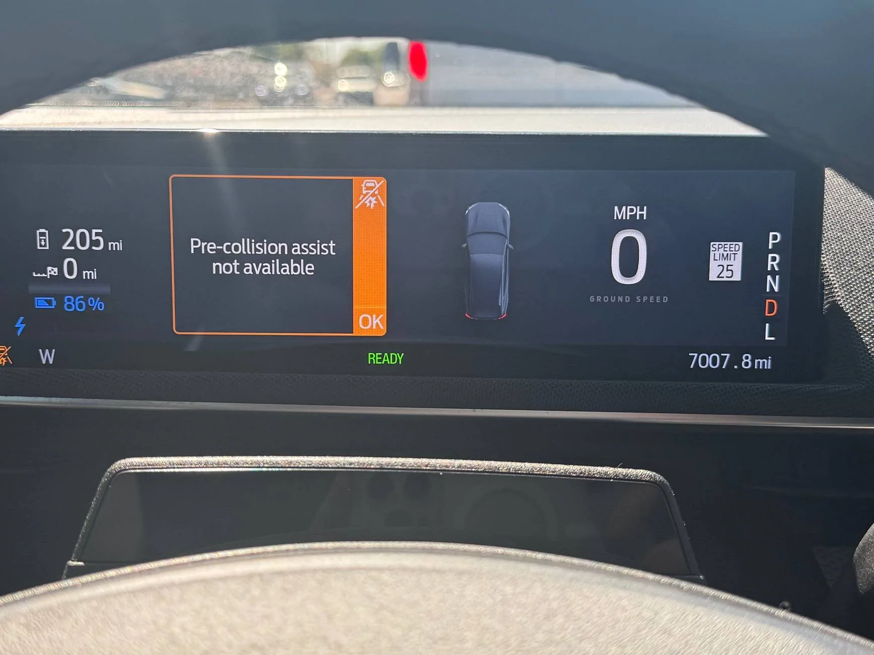

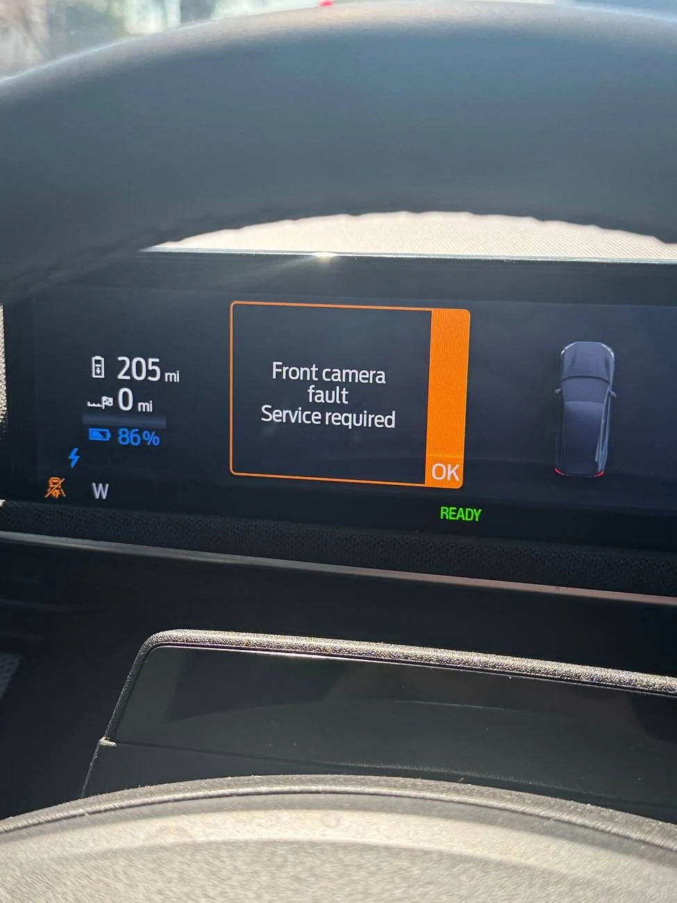

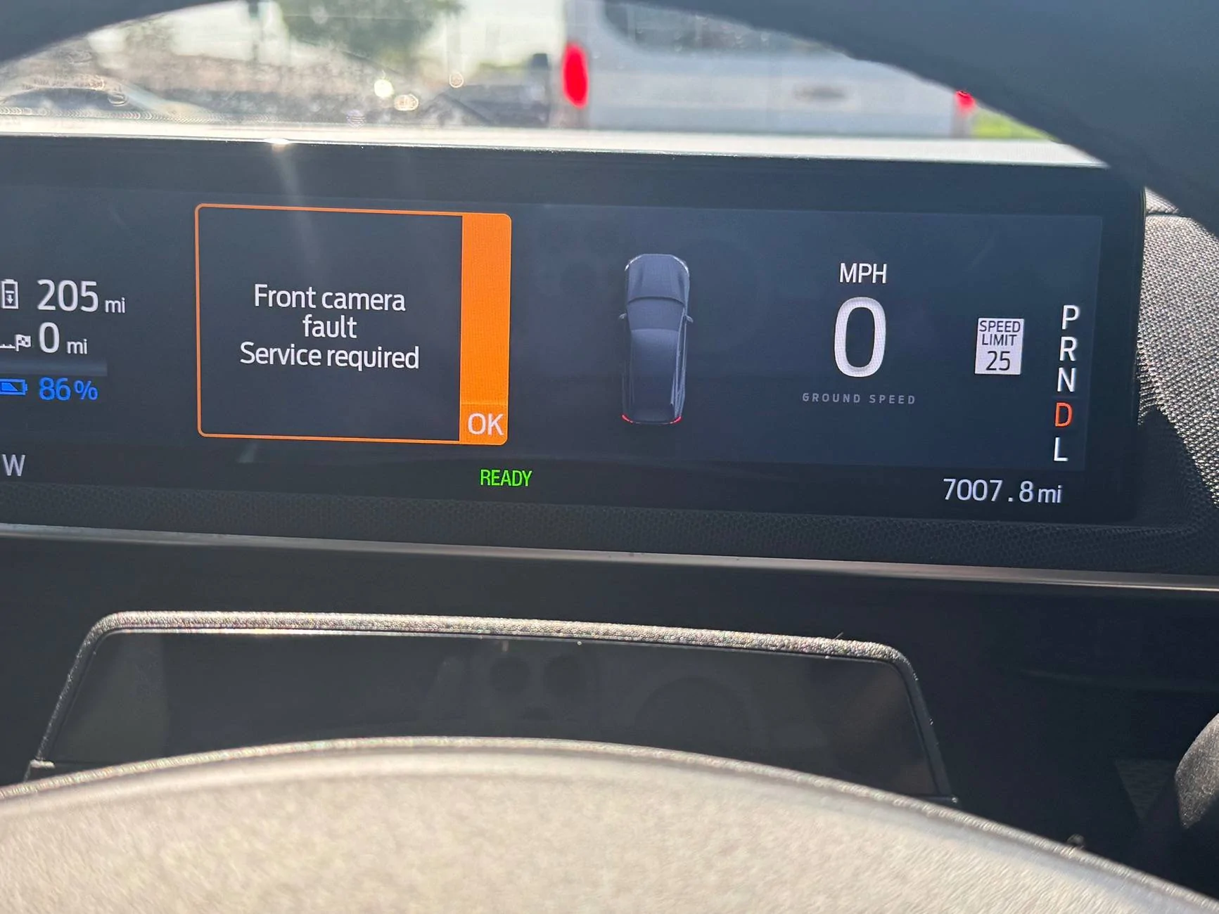

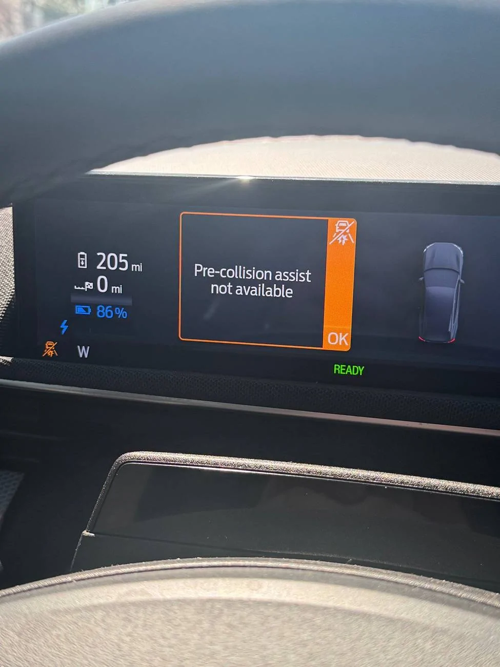

I keep getting error messages showing up and codes stored in the impa. I have taken to shop 3 times for the same problem they tell me it looks like it resolved on its own. This has been going on for over 6 months

Isn’t there some kind of common issue with the cable/harness to that camera?
And if so, wouldn't dealerships be more than aware at this point?
Maybe I'm confusing this though with another issue that got a fair amount of airplay. But this sounds very familiar.

I agree. I know the 2022 needed to reprogram the impa but this one did nothing like that

I have been getting the same camera errors for 9 or more months (started last winter). First the errors cropped up once in a while. A couple of months ago they started happening at least a couple of times a week. That progressed to daily. I brought it in last week and they “reprogrammed” the IPMA. I knew that wasn’t the issue, but W/E. It threw the error less than 5 minutes from the dealer and again twice the next day. Back in again for diagnosis on Monday. Bad co-axial cables (the same diagnosis as for the majority of the people on this forum have had for the front camera going kaput). Parts are on order, to arrive this week, so my car is back in the shop on Monday. No loaner. Rental company doesn’t open until 08:00 and I need to be at work at 07:00. ?????? Guess I am making use of the four paws that I was born with. ??

Yes, the majority of front camera errors that have been reported on this forum were due to bad co-axial cables or co-axial cables that needed to be repositioned. I tried repositioning mine and the error stopped briefly but came back. ?‍♂?

That fixed the problem I have not seen it come back and FDRS giving all green now
