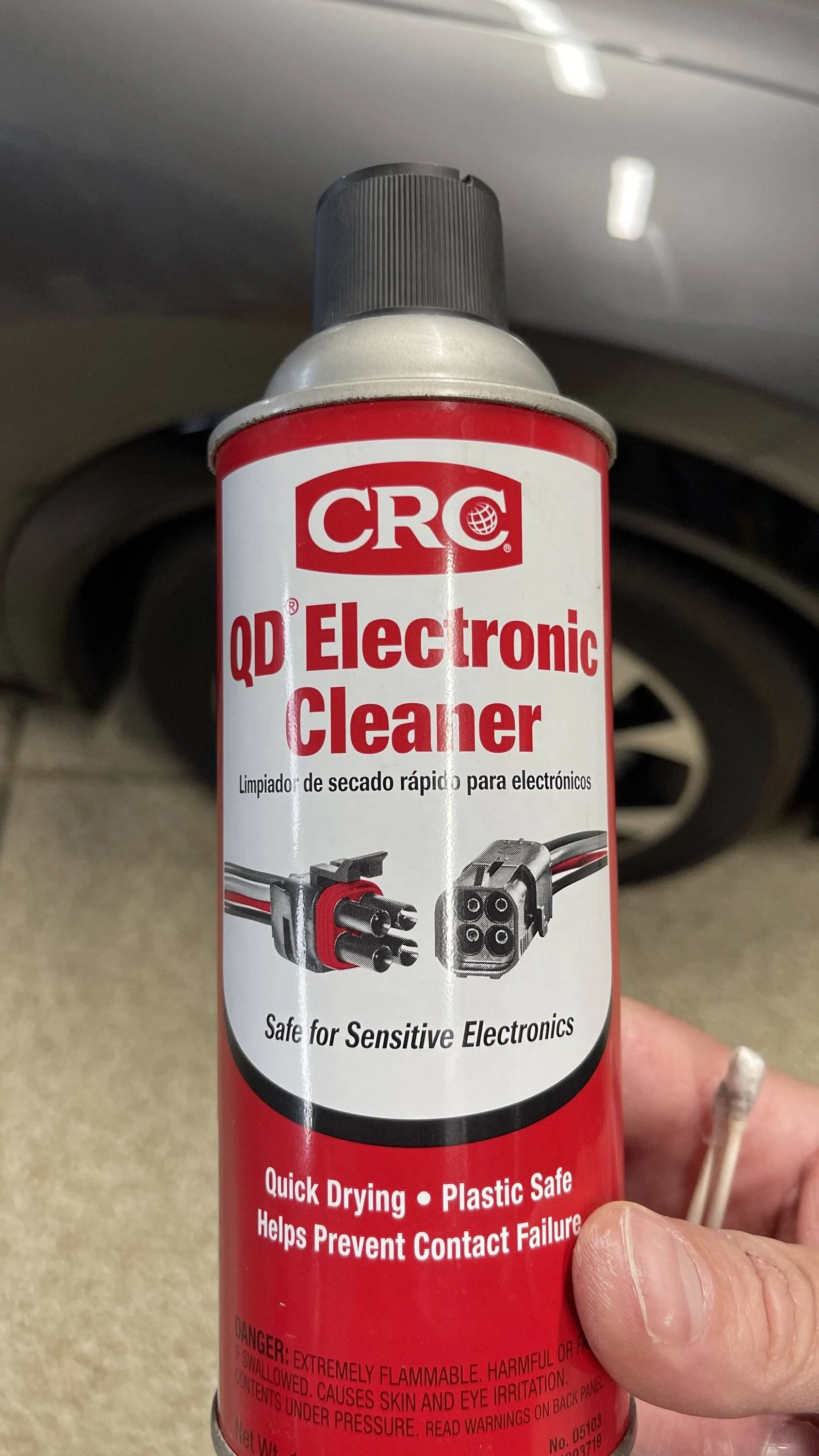

I just cleaned mine with some contact cleaner, and I'm going to drive it so I can recharge. I wouldn't say it was filthy, but you can see from the q-tips that it was dirty. It might have been corrosion somewhere else in the port, but I figured this was easy enough to try.

I have the same contact cleaner and used it on both the car charger port and the EVSE. Did not help mine at all.
