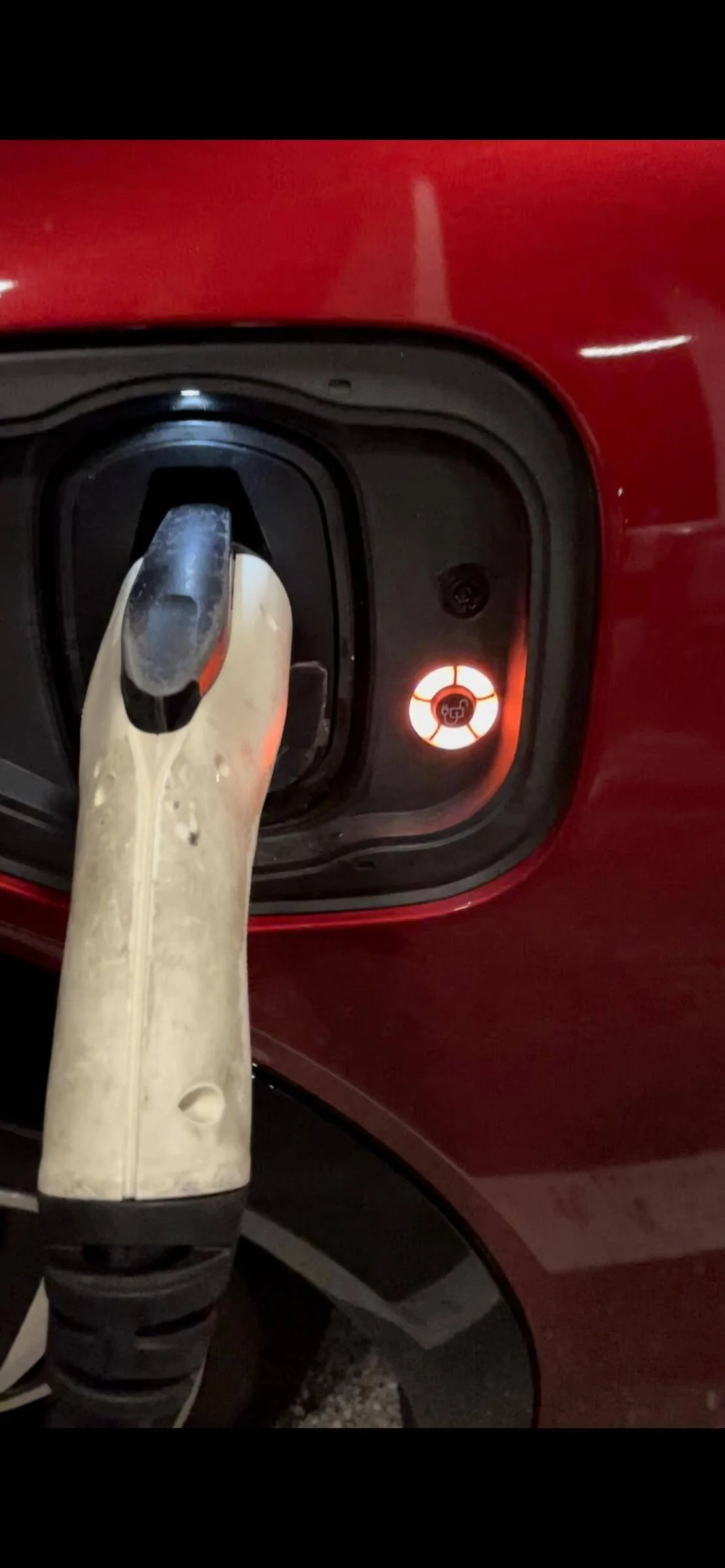

I’m having issues where when I plug in on any level 2 charger the charging stops after 45 minutes to an hour.
when charging stops I have continuous flashing amber lights on the charge port of the car

Mine does this as well but only if I'm charging higher than 32 amps. I have a Chargepoint Homeflex on a 60A breaker and if I try it at higher charge settings it will randomly stop charging and flash the orange lights around 30 mins +- after plugging in. If you're able to lower the power on your EVSE, I'd suggest trying that.
It is at the dealership right now for the windshield recall and they're taking a look into it. I'll let you know what I find out.
I read in another thread to do this on my Grizzl-e. I charge at 40A but just switched to 32A. Will test tonight when the electric goes to off peak pricing.

So since the day of my last post I have not had any issues at 32A charging. Grizzle is sending me a new unit to rule out it's the unit. Once that one comes in, I will use it at 40A like before and see what happens. Ford Engineering emailed me separately and are looking into it too. One time it stopped charging, I noticed the plug was pretty hot. Uncomfortably hot so I left it unplugged as to not start a fire. I think they took notice to that observation.
