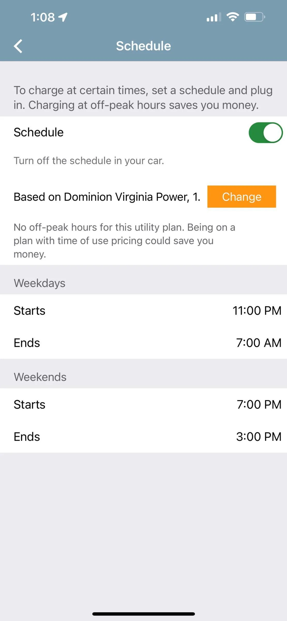

Get a smart EVSE, here is my ChargePoint App, it will override anything that is set in the vehicle.
Ford Mustang Mach-E Car ignores charging schedule! 1639872630277
