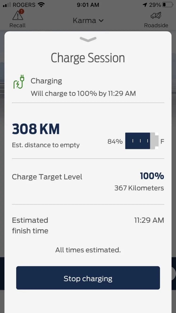

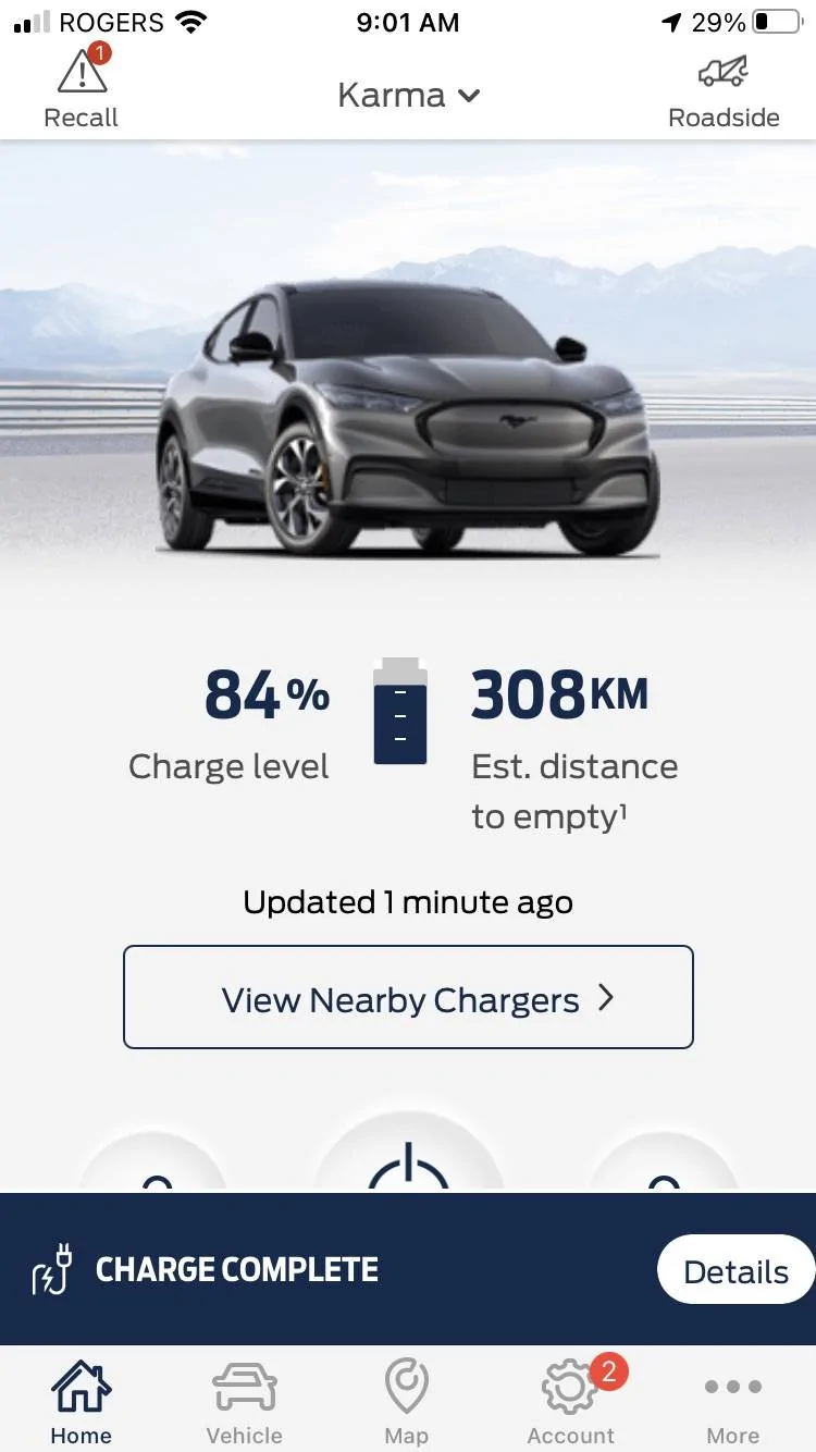

Here is the logic I get after plugging in when on (note the same time stamp).
Ford Mustang Mach-E Car ignores charging schedule! Screenshot 2021-05-06 at 9.01.12 AM
Ford Mustang Mach-E Car ignores charging schedule! Screenshot 2021-05-06 at 9.01.41 AM

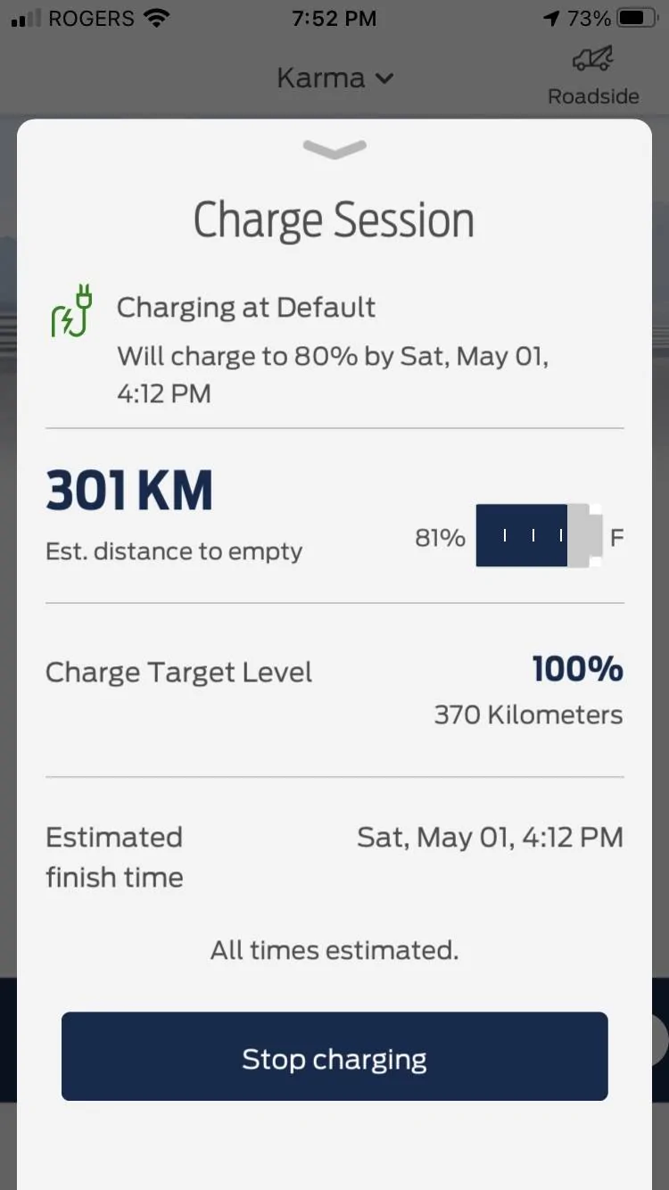

This from last Friday. Karma has brought a bit of humor to our lives also.
Ford Mustang Mach-E Car ignores charging schedule! Screenshot 2021-04-30 at 7.52.30 PM
