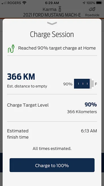

So is this not a sight for sore eyes. My first successfully completed home charging schedule!
Ford Mustang Mach-E Car ignores charging schedule! Screenshot-2021-06-25-at-6.29.57-AM.png
Screen cap this morning. It finished around 10 last night. Still tethered. ? Initial signs is it is working.

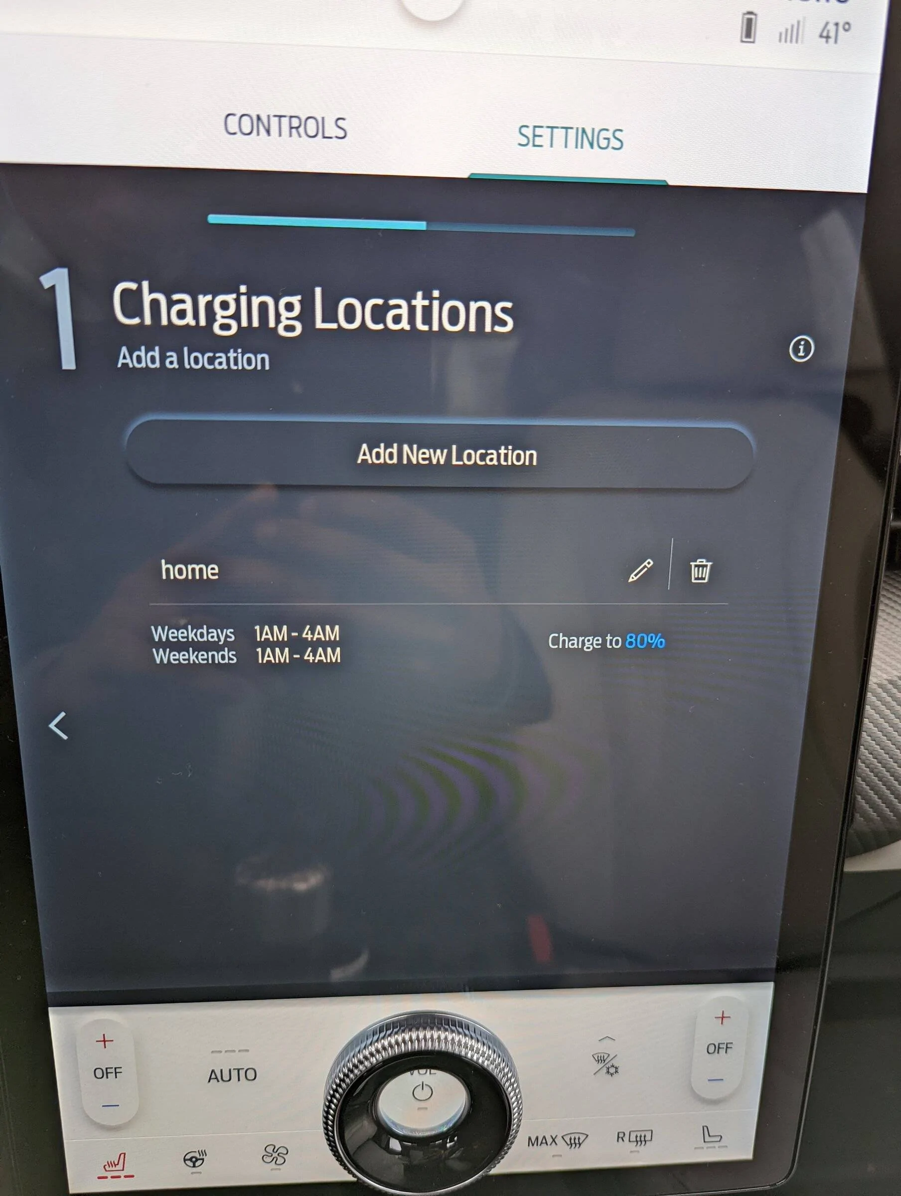

I have my home location setup like this. Charge from 1-4am and max charge to 80pct. See below:
Ford Mustang Mach-E Car ignores charging schedule! PXL_20211218_151028881

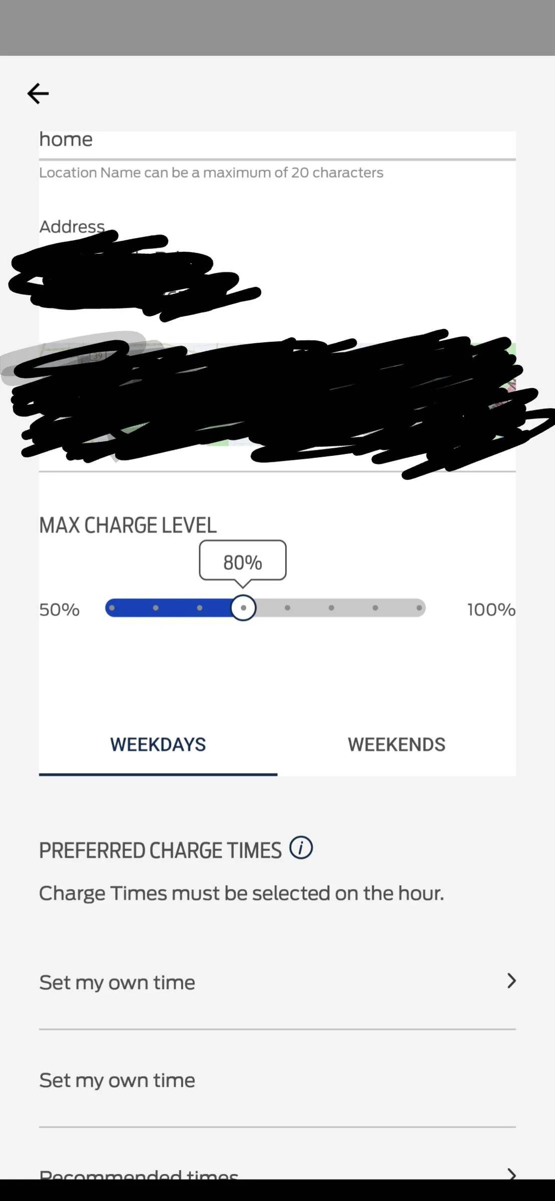

However in the Fordpass app I can't see any of the charge times I have set up for home location (I'm a pixel pro 6 Android user):
Ford Mustang Mach-E Car ignores charging schedule! Screenshot_20211218-101444

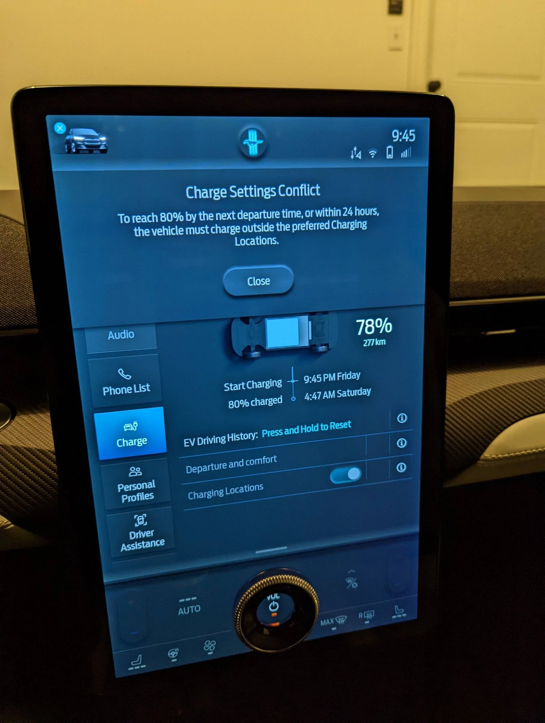

And yesterday I got this message. I have no departure times setup in my car:
Ford Mustang Mach-E Car ignores charging schedule! PXL_20211218_024553425
So my car recognizes it's home and will charge to the 80pct limit. However if I plug it in it will charge immediately - it won't wait for the charging window.
If it estimates that your charge window isn't long enough to reach the target, it will start when you plug in. Not sure if that's the issue there, but it could be.
Maybe try extending your schedule out to noon or something (well beyond the likely finish).
the car will override your schedule and begin charging right away if it determines that it can’t get to your set charge level within your set window.

Note from user manual: Reaching your max charge level by your next departure timeis always the priority. When charge times are set, charging outside your preferred charging time windows could be necessary in order to finish by your next departure time. In this case, the vehicle will typically begin charging right away after plugging in.

@RedDragon, the problem is you're thinking logically. You figure you are at 78% state of charge, and want to go to 80%, and that you have 3 hours to do so (1 - 4AM). Unfortunately, as demonstrated by the car showing you that it wants to charge starting at 9:45PM Friday, and won't finish until 4:47AM on Saturday, it's clearly not seeing that you only have 2% to go.
Why? Don't know, but it's pretty clear that's the issue.
