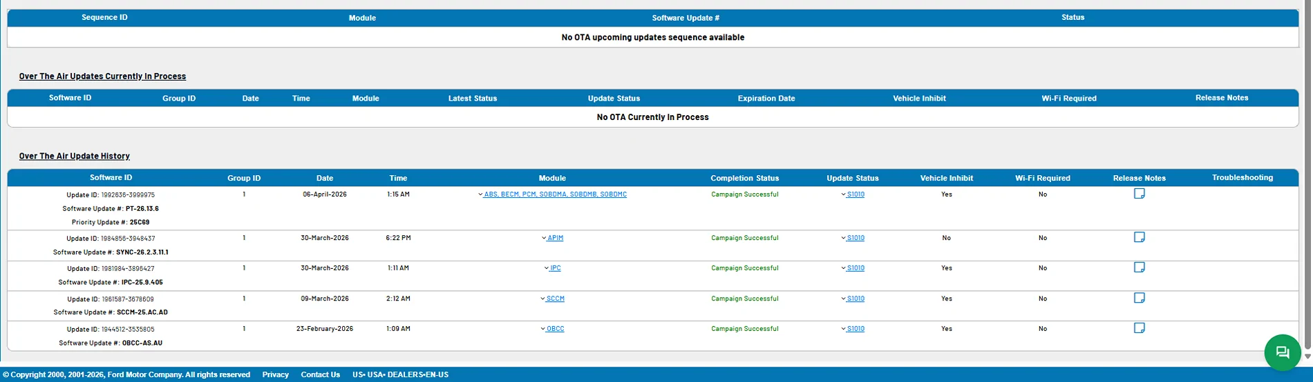

I’ve been researching solutions on the interwebs. It seems like a pending SYNC software update is a fix I need. The last update my SYNC says it received is PT-26.13.6. Which means I’m about 5 updates behind? How can I push the newest updates?
I was also told to share my VIN with you guys, in hopes you can look up my OTA update status. VIN: redacted, answered below
Thanks for your help, and look forward to contributing to the forum.
OTA dashboard does not show and pending OTA's in your queue at this time.
