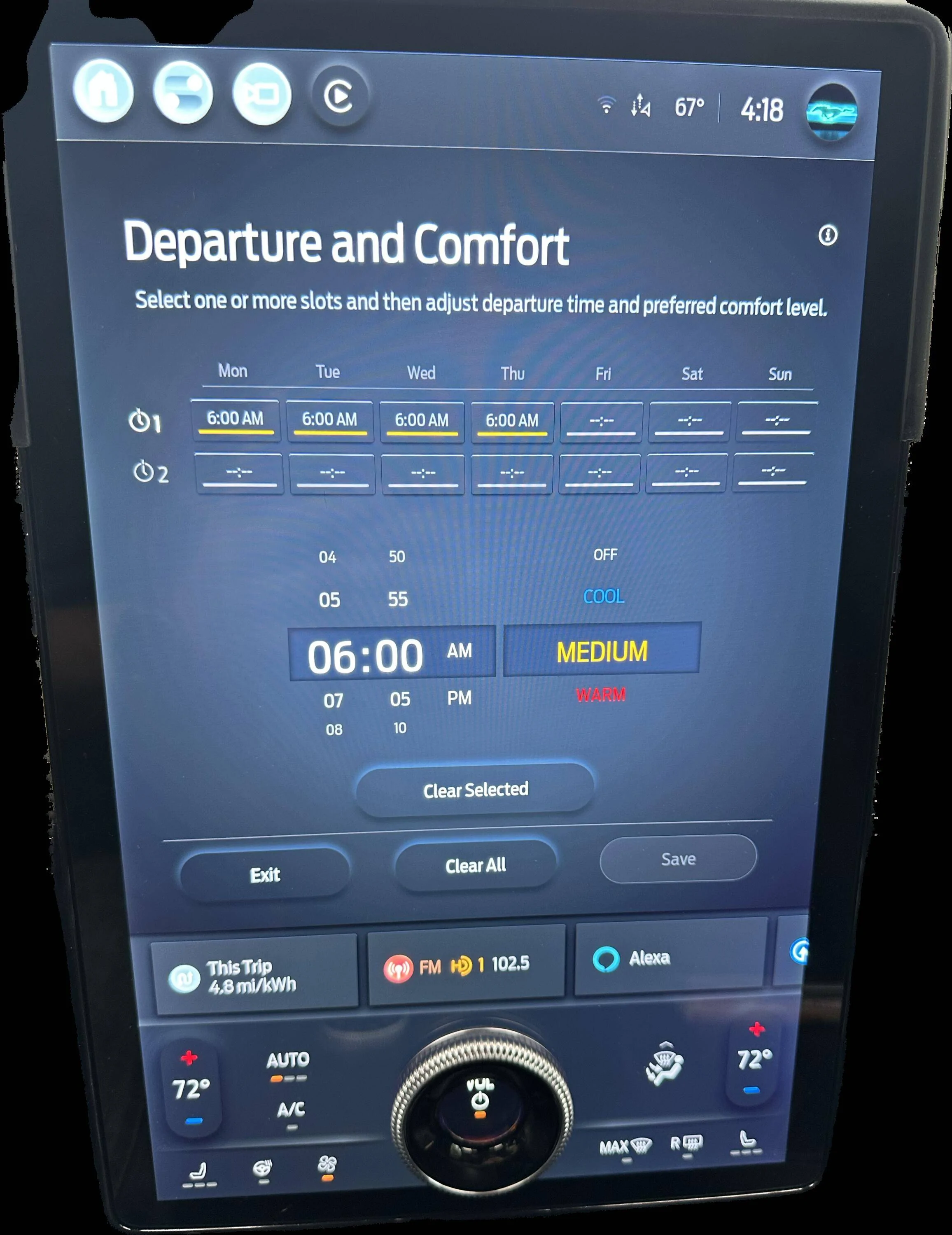

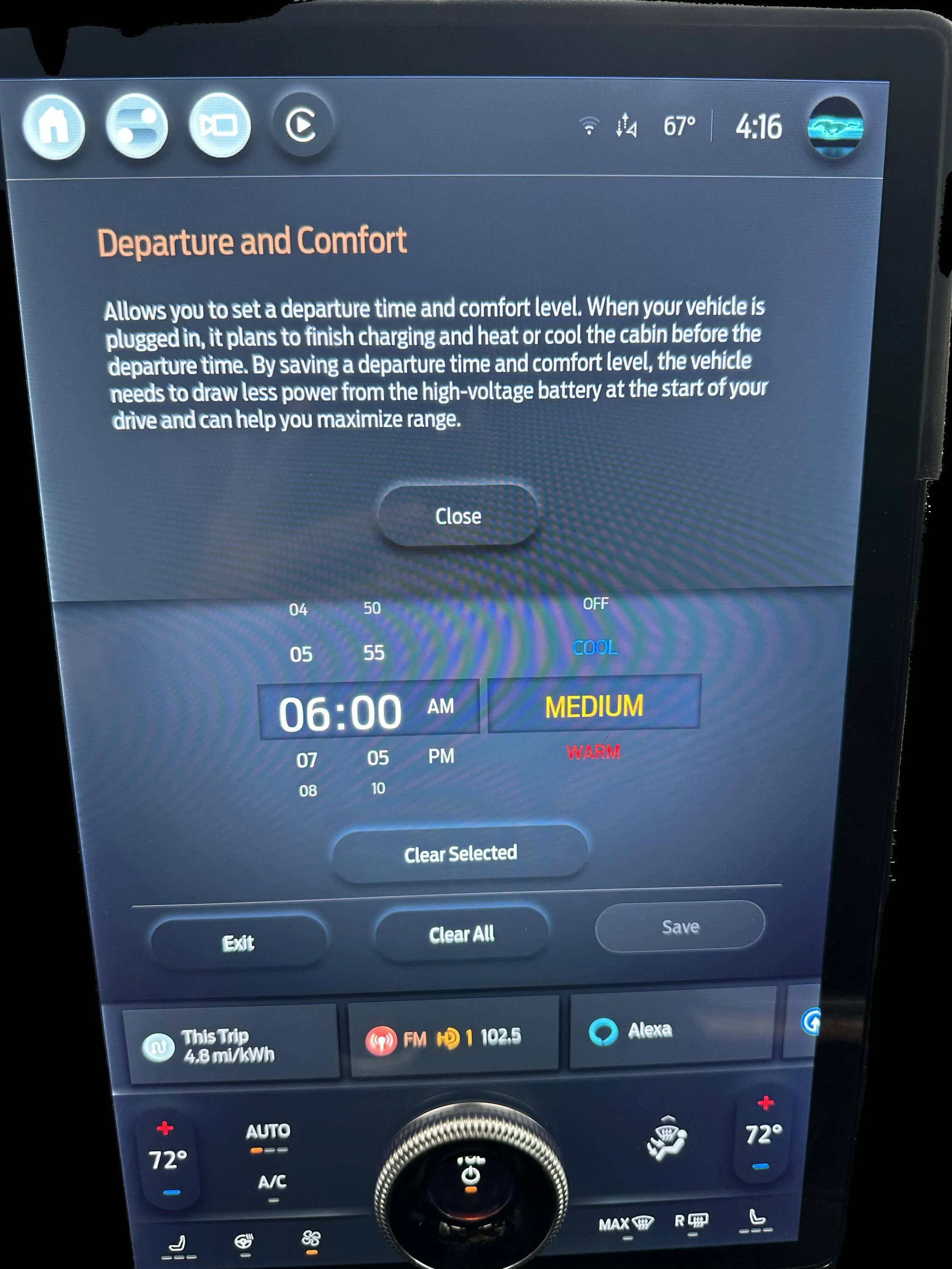

I did not see any toggle that allows the cabin to pre-warm/cool when unplugged. I had to go out and check. Didn't grab a photo, but pretty sure it says it only will condition the cabin when plugged in. Is that new for 2023 or maybe a software update?

Setting a departure time ALWAYS cools or warms the cabin, whether the vehicle is plugged in or not. It has been this way since the Mach-E came out.
There is a toggle, that shows up once a departure time is set, "Pre-condition cabin when unplugged". If you set a departure time, it will shows as on.
Underneath it says "Note: Remote starting when your vehicle is unplugged may deplete your battery". While it says "remote starting", it is on the departure time page and refers to a departure time draining the battery just like a remote start does, when the vehicle is unplugged.

I see no toggle with no departure time set. If I set one, then on the screen after I save it it shows up.
You should note that the purpose of the switch, which has never worked, is to be able to set a departure time, toggle it off, and have the battery precondition but the cabin not precondition, while unplugged.
People have watched, via OBD adapters and Car Scanner, and verified that unplugged the battery is not warmed with a departure time.

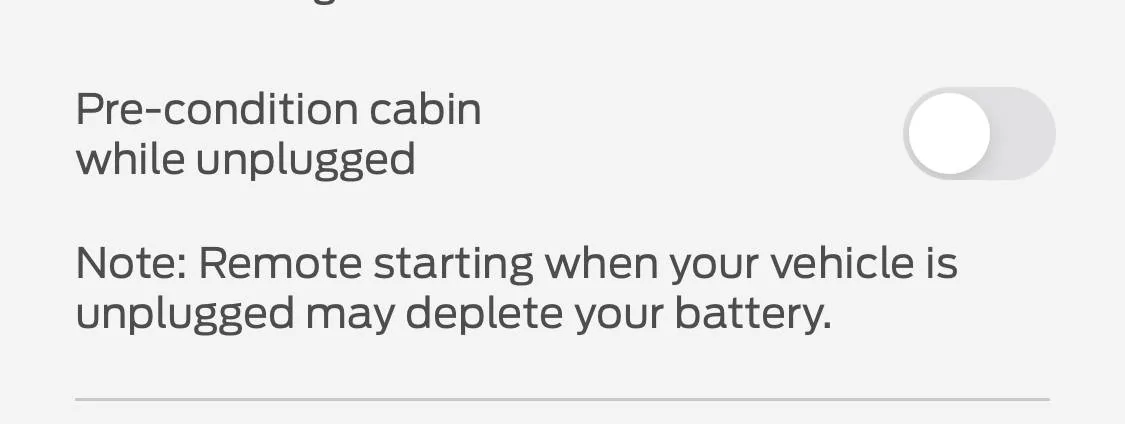

My FordPass won’t work for crap for days to set charging. I have to do it in car. And I don’t see any option there to condition while unplugged.
Ford Mustang Mach-E Charging concern 1692822722400
Ford Mustang Mach-E Charging concern 1692822786915

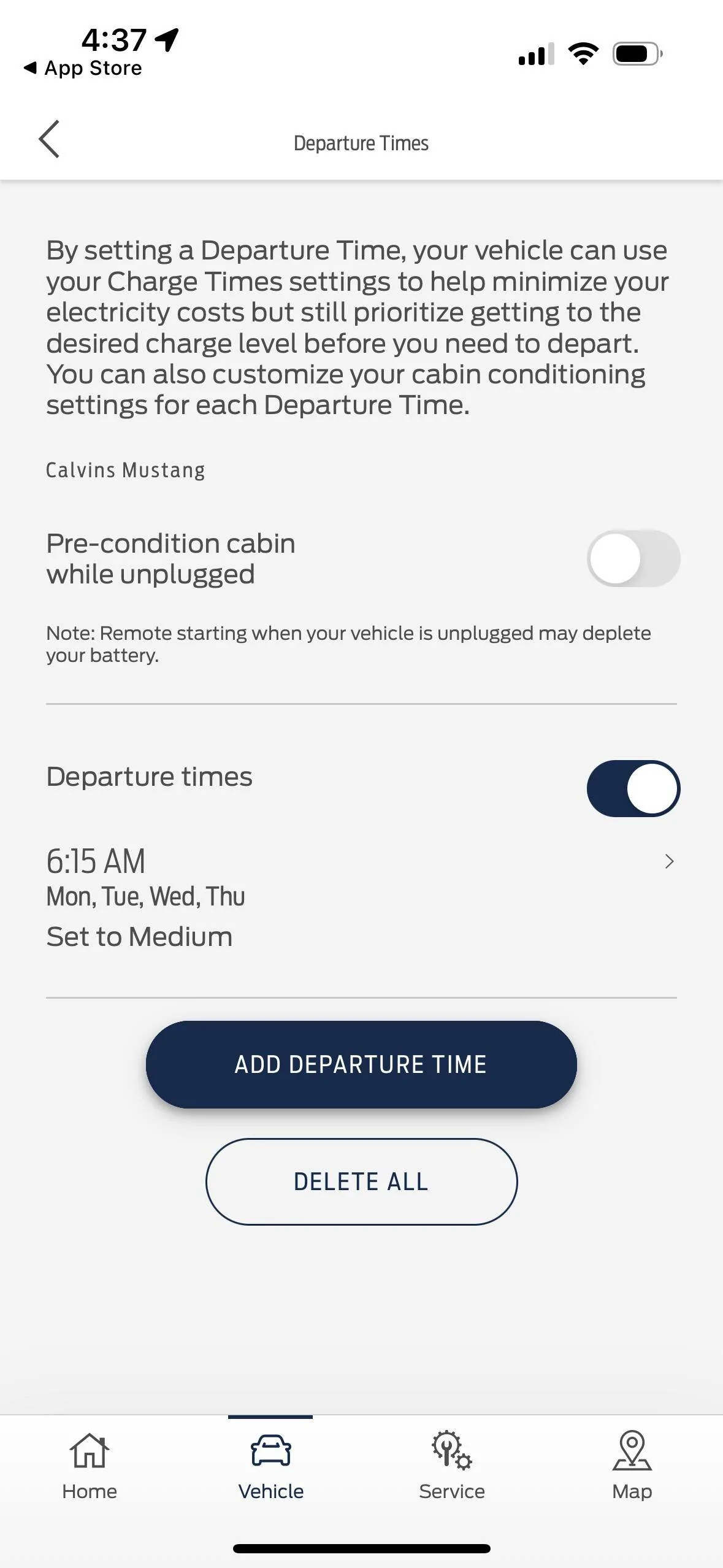

Well shoot. I uninstalled and reinstalled and got the app working. Turns out it is an option in the app. Can’t find it on the car menu. But it’s turned off.

Yeah that toggle defeats the entire purpose of departure times, which is meant to condition the cabin for you. So I can understand why the toggle won't work. It's some left over code someone forgot about in FP. Which you'll learn doesn't actually work to schedule anything through. But does work as a remote fob.
