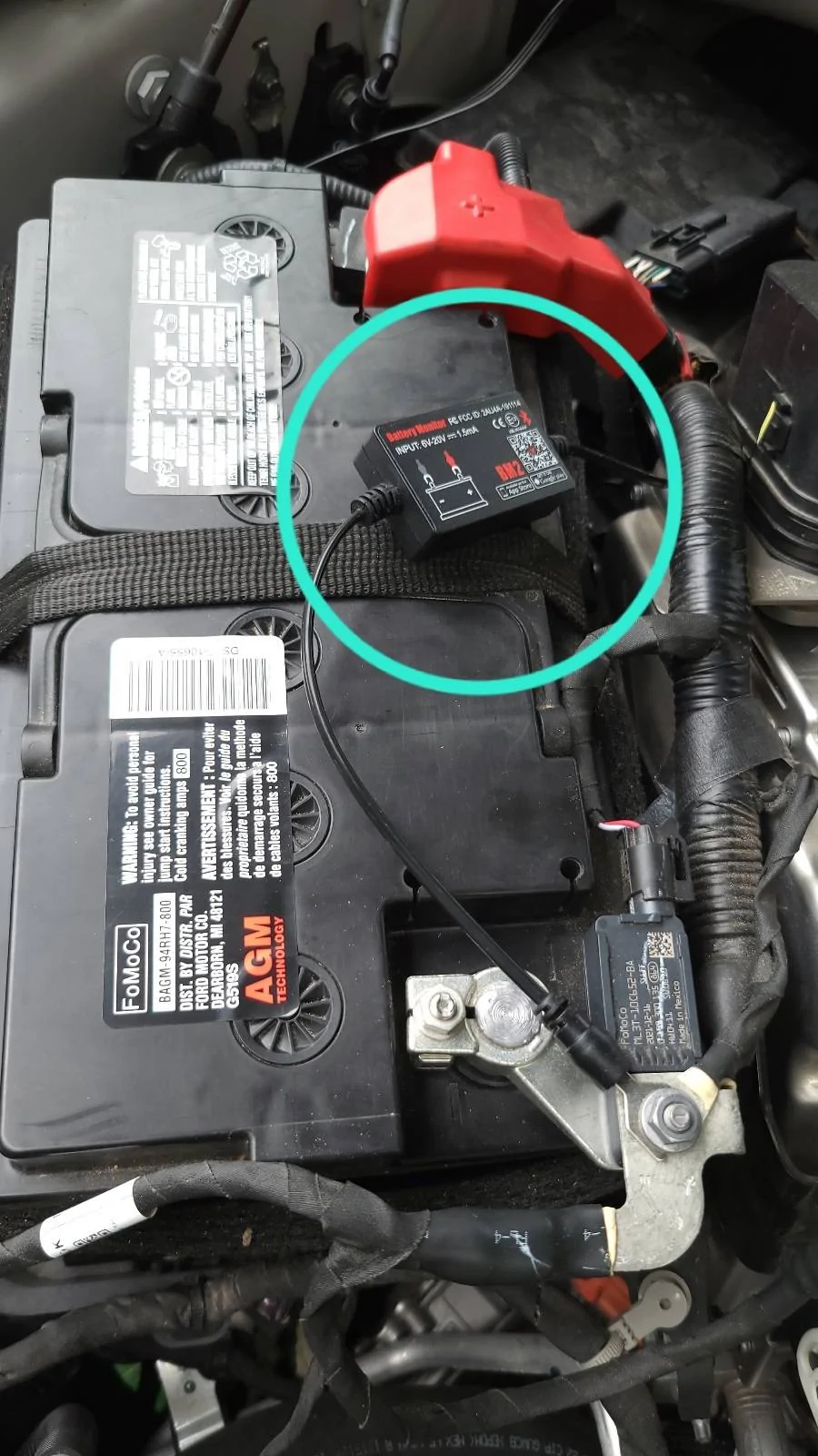

It's attached straight to the battery posts and uses Bluetooth to report to the smartphone app.
The OEM low voltage charging strategy was very anemic on the Powerboost when I first acquired one 3 years ago. It was impossible to get a true reading of the battery since just approaching it or opening the door would tax the battery and give a misleading value.
The Mach-E is very similar in that it's not really ever asleep and waking it up does the same thing.
With the Bluetooth voltmeter I can get a static voltage reading and log without approaching the vehicle. And it's interesting to see just how active these modern cars/trucks can be while you are counting sheep. :)
So far the Mach-E has shown a very healthy low voltage charging strategy. Especially with my personal use case. I'm daily-ing it for 50 miles or more.
