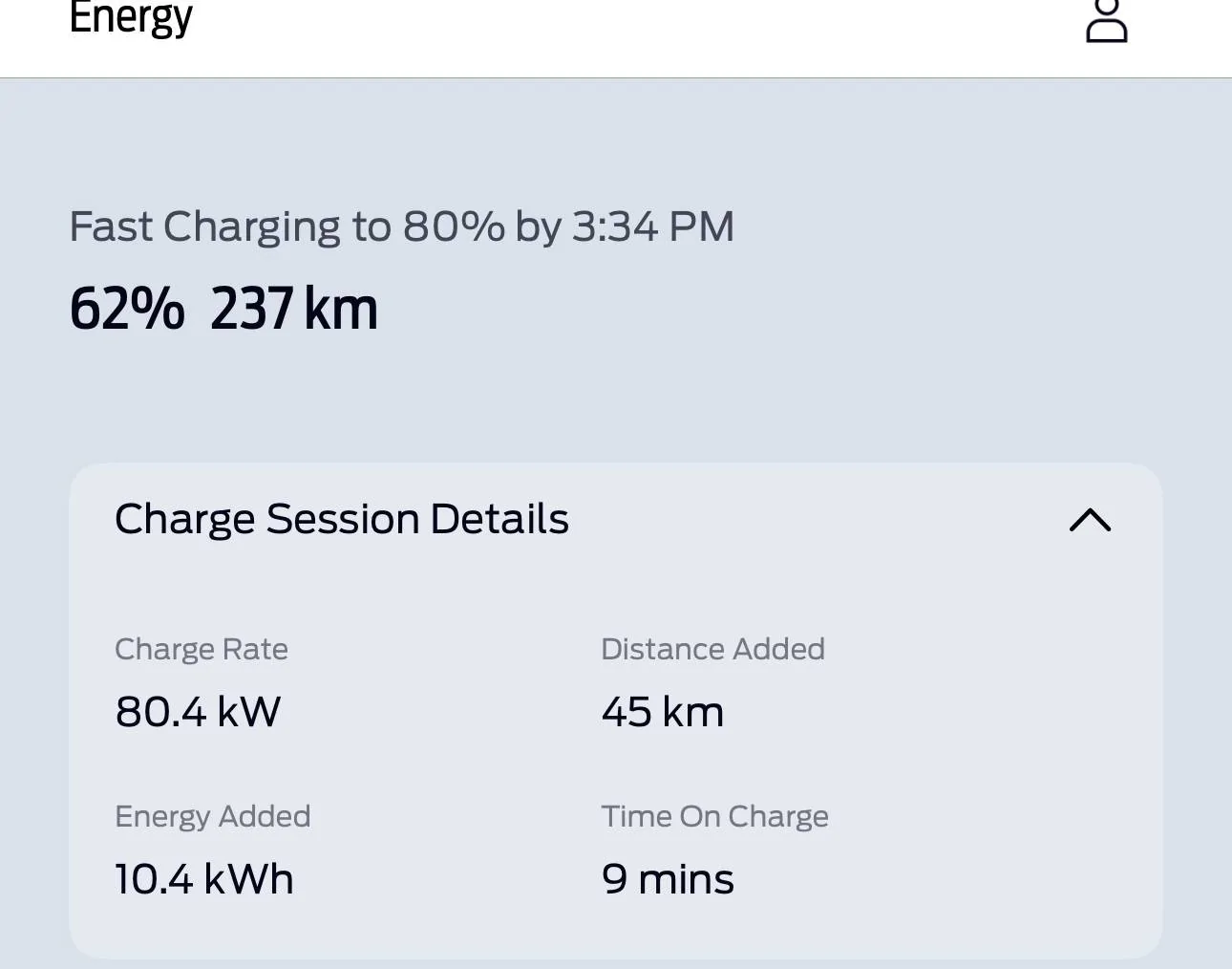

Yesterday I pull-up to charge from 45% SOC on a 120KWh (Circuit électrique). I said to my wife now we will see if the charging speed will cap at the 112KWh max speed ( I have a standard range awd). Unfortunately before it reached the 80% it never went higher than 81 KWh speed. Should I assume the 2 main contributing factors were :
1- it was 11 degrees celsius (assuming hotter weather would allow the battery to accept faster speed)
2-I was not using the onboard NAV so it did not precondition the battery before I arrived?
Any other reasons I missed ?

{EDIT: Missed which screen you were showing.]
While those might have made a difference, there are two other possibilities:
  1. That 80.4 KW is the average for the session. You likely started at a higher value.
  2. There is also a current limit in addition to a power limit. The current can be limited by the dispenser, the cable, or the power module. There is also a max value the car will ask for. Some of the lower power chargers are limited to 200A which will limit the charge on a Mach-E to around 80 KW.
It is highly likely you did not see the peak power your Mach-E can support with a 45% start.

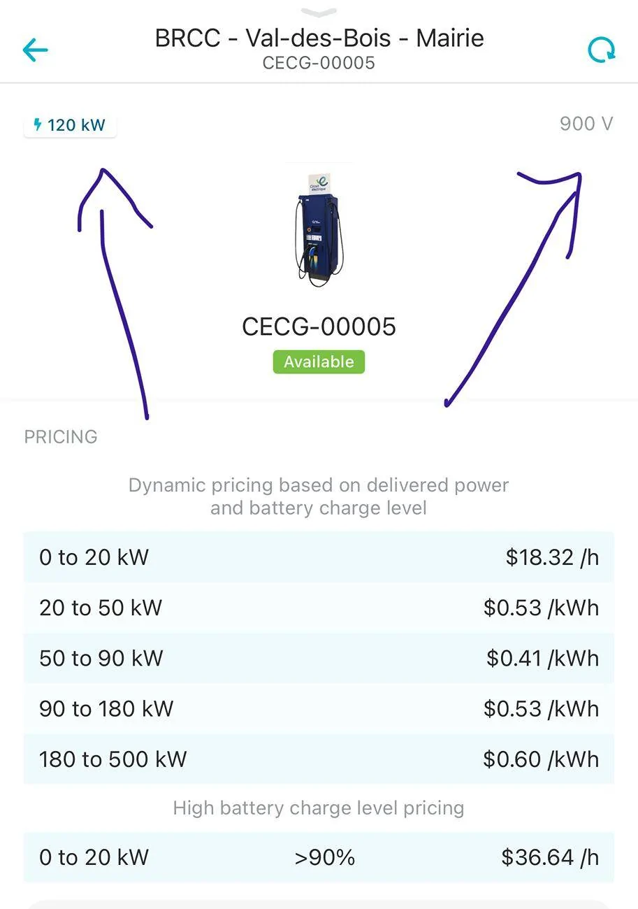

Just providing additional background : This is the details of the 120KWh charger I used yesterday.
Ford Mustang Mach-E Charging speed question 1728931607215-4a
900v ?!
so clearly the MME can’t do that so I guess only a few car manufacturers can hit that 120KWh ?‍♂

If you look that up on PlugShare, you'll see feedback from one Lightning that got 118 and then 113. Lightning is going to charge faster than you. Nobody else got fast speeds.
Also notice the LARGE penalty for going over 90% SOC, $36.64 an hour! That's a big penalty.
https://www.plugshare.com/location/563890

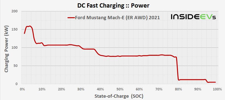

The charge speed you got at 62% matches exactly with the charge curve you have. You can look at multiple examples by Googling for it.
Below 40% you would have been higher. Between 100 and 110 at 10 - 25% SOC, then dropping below 100 at 30%, below 90 at 35%, ...

And your right seems my experience does match the charge curve. I guess I would be spending most of my charging speed between 50 and 75 KWh
