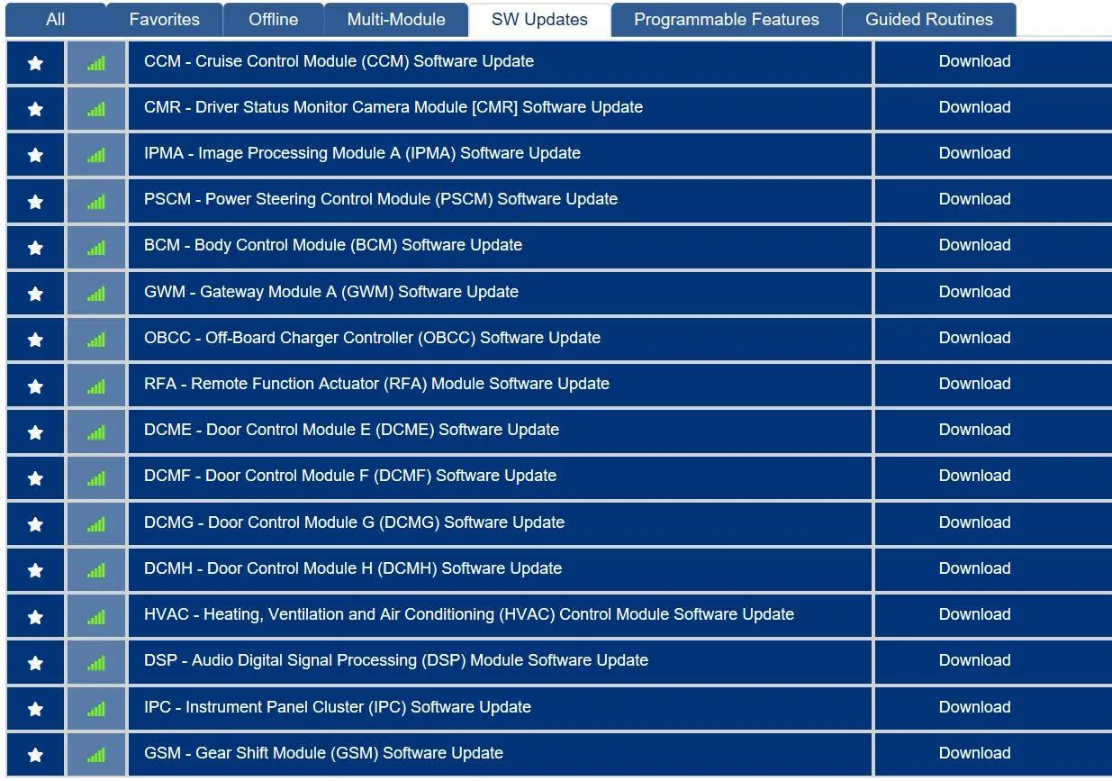

Thanks! I got it back and I have all the "Bells & Whistles" (i.e., Blocks, Notes, Tetris) but when I go to Updates it tells me Nothing. Just that my car is up to date. Any way someone can tell me what version I am on? 3FMTK3RM0MMA36655
generaltso
15,389
28,696
Vermont
2024 Kia EV9 GT-Line
Unfortunately, there is no one version number for these cars because there are dozens of modules each with their own software versions. I can tell you that these are the modules in your car that still have updates available:
