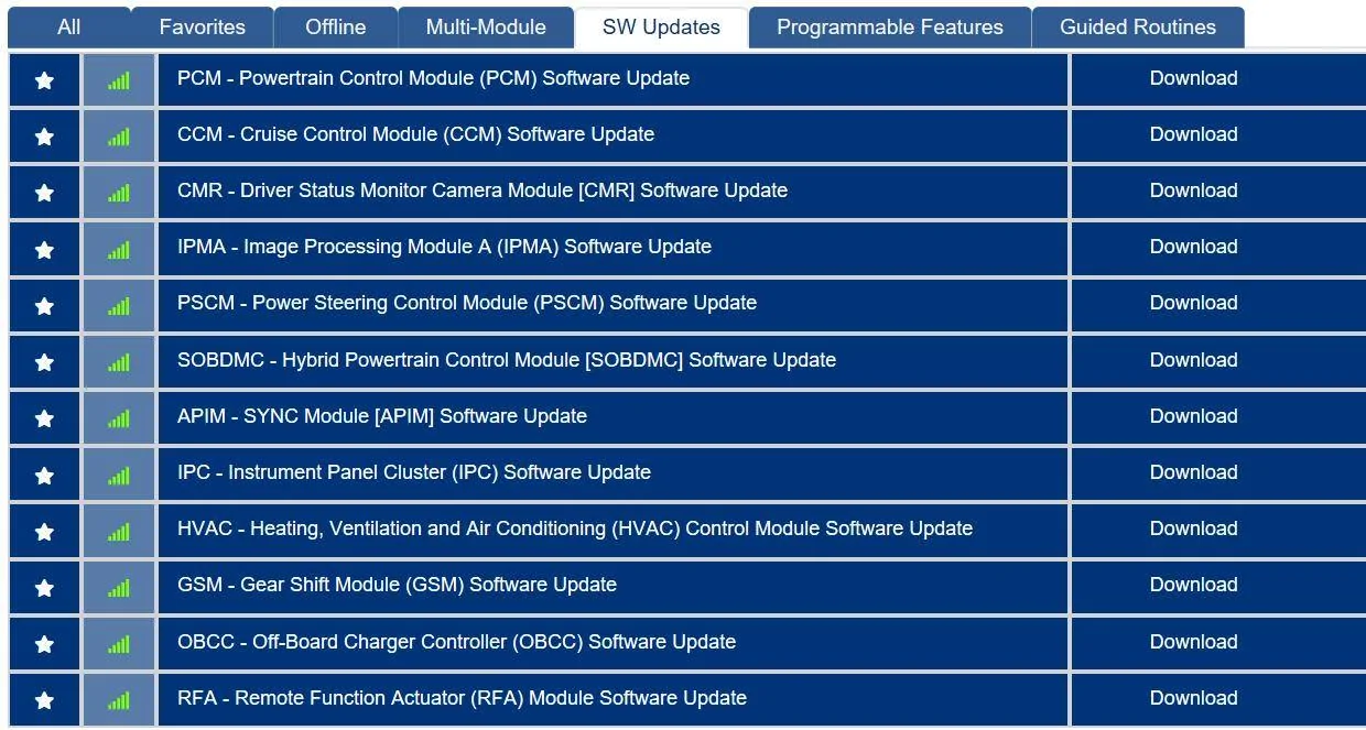

What application provides that output? They claim this website is fake
Lol, FDRS, the same system they use to update the car. I don't know why you've kept your car there that long if they're giving you such long timelines to do absolutely anything. Call Ford Support and at least get a case manger to push this along, hopefully. @generaltso first picture is of all currently available updates specific to your VIN. Tell them to do those.

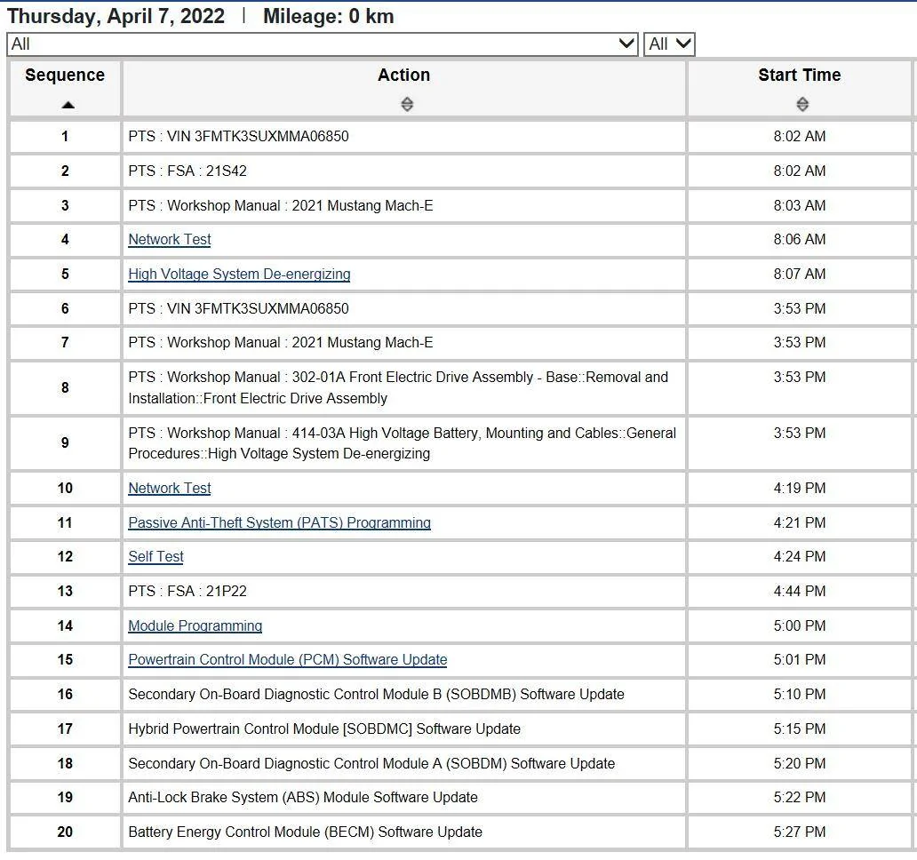

So they finally acknowledged that the minimum updates were not completed and they were doing them as I left.
so, now to find a dealership that will do all the work still needing to be done

Some of them, but the didn't do them all. It looks like they probably stopped at quitting time and then just never went back and finished them. This is what they did the one day they appeared to work on it:
