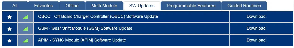

Looks like they're still doing updates today. This is what's left:

The OBCC module should have been updated during step 19. It's part of the 21P22 updates.
Code:
19. Mach-E vehicles ONLY. Not required for F-150.
• Does FSA 21P22 need to be performed?
Yes - Perform FSA 21P22 then proceed to step 20.
No - Proceed to step 20.
I don't think it's required for the BlueCruise, but it is part of the charging curve update.
The APIM (Sync Module) is the one that makes me think they aren't done yet. Completing the APIM may trigger another GWM (Gateway Module) update as well. Depending on where you started, there may have been 3 APIM updates that needed doing, and each one can trigger other updates that need doing.

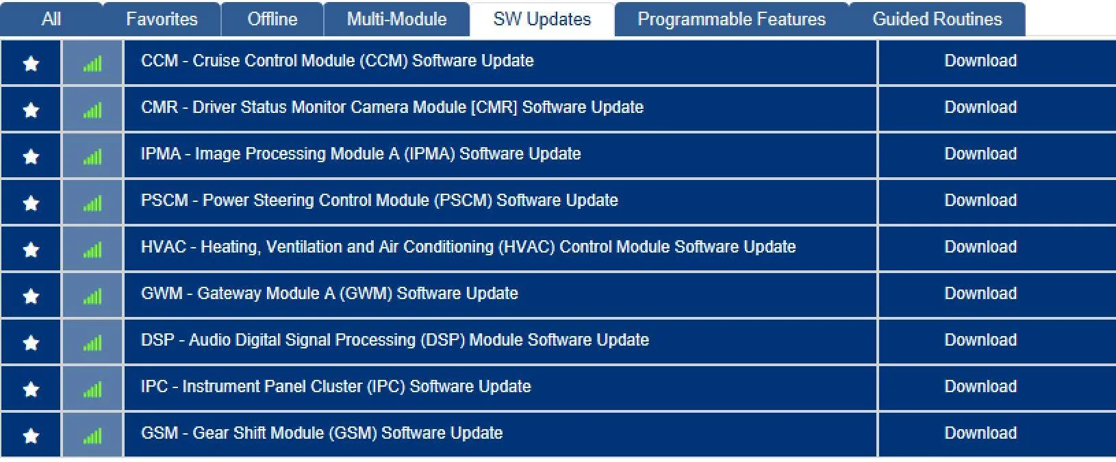

Looks like they are working on it today.
So far they have updated or are currently working on:
IPMA (Image Processing Module A)
PSCM (Power Steering Control Module)
CMR (Drive Status Monitor Camera Module)
CCM (Cruise Control Module)
IPC (Instrument Panel Cluster)
They still have a little ways to go as some of these haven't reported back to FDRS as successful yet. In addition, once some of them complete it will probably trigger another round of APIM and GWM updates.
