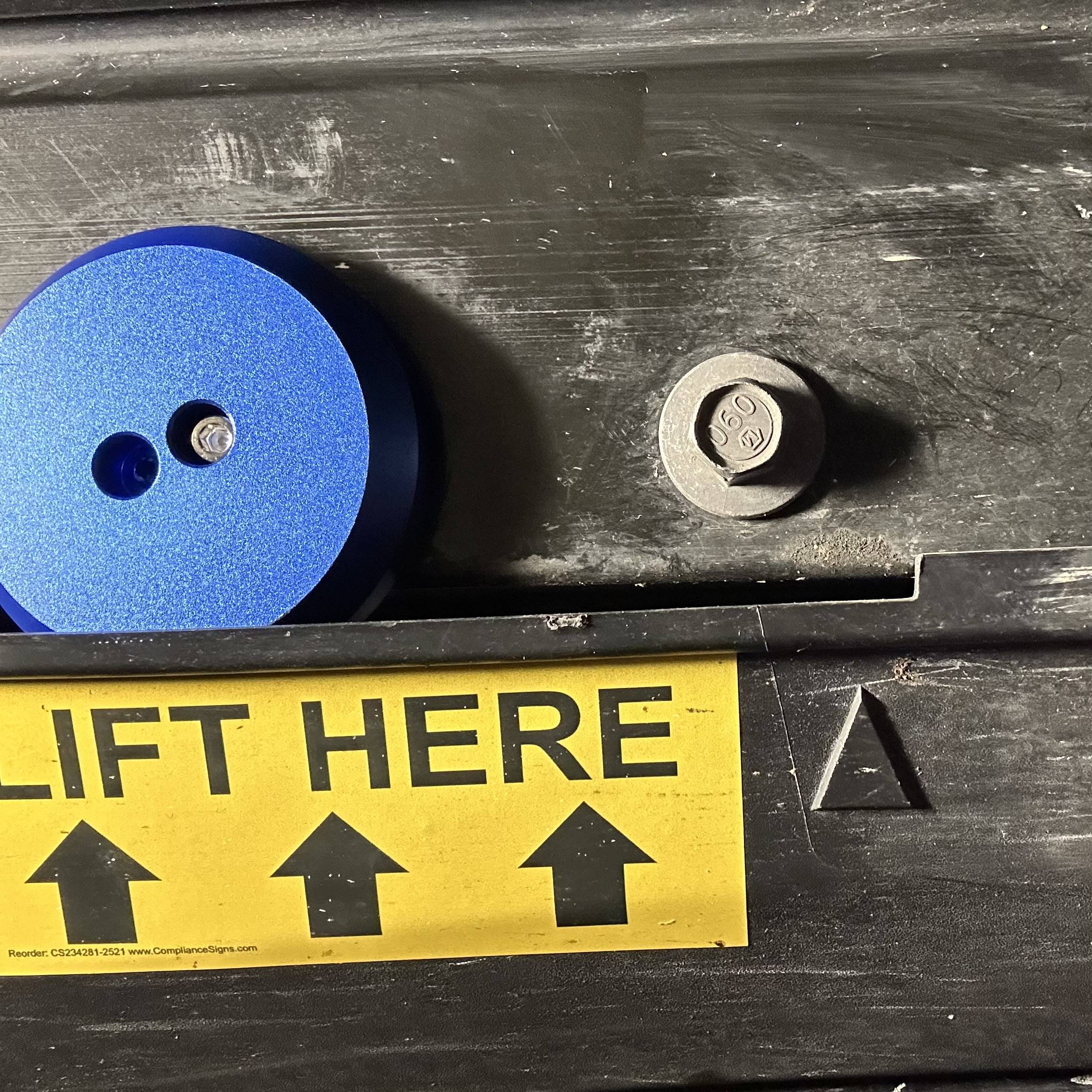

OK, so I got the the pucks removed! Once I had a system figured out, it wasn't a big deal. (Having to do some of it in my slanted driveway complicated matters, but that's another story...)
[[ As a reminder, I stupidly used Loctite red on the pucks figuring I'd never need to remove them, but then Mark Boris pointed out that they likely need to be removed I case the battery needs to be dropped... ]]
It was essentially a four-step process:

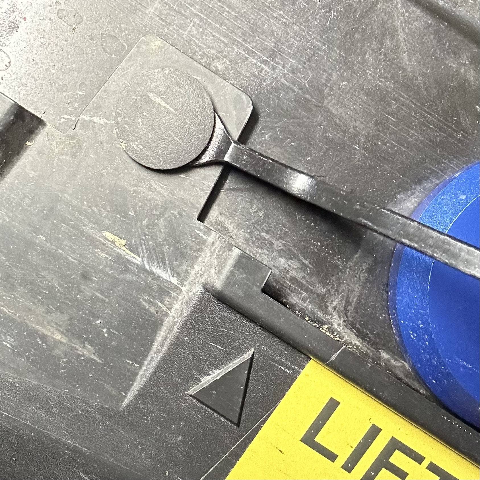

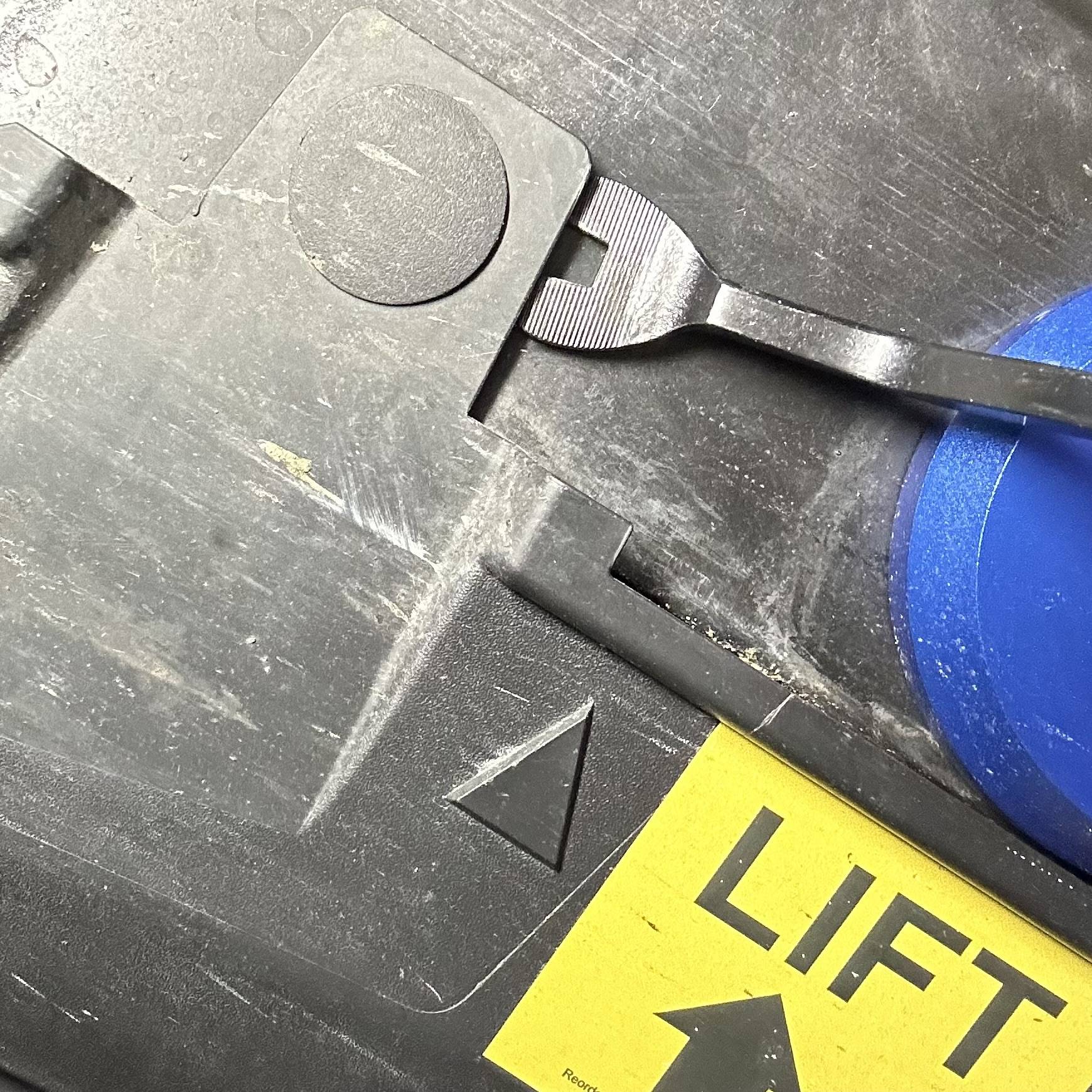

  1. Remove the rocker panel trim fasteners on either side of the puck. (I loosen the fastener first by slipping the trim tool between the trim tab and the rail....
    Ford Mustang Mach-E Corvette Jack Pads installed IMG_1415
    ...and then move it to under the fastener alone and remove the fastener.

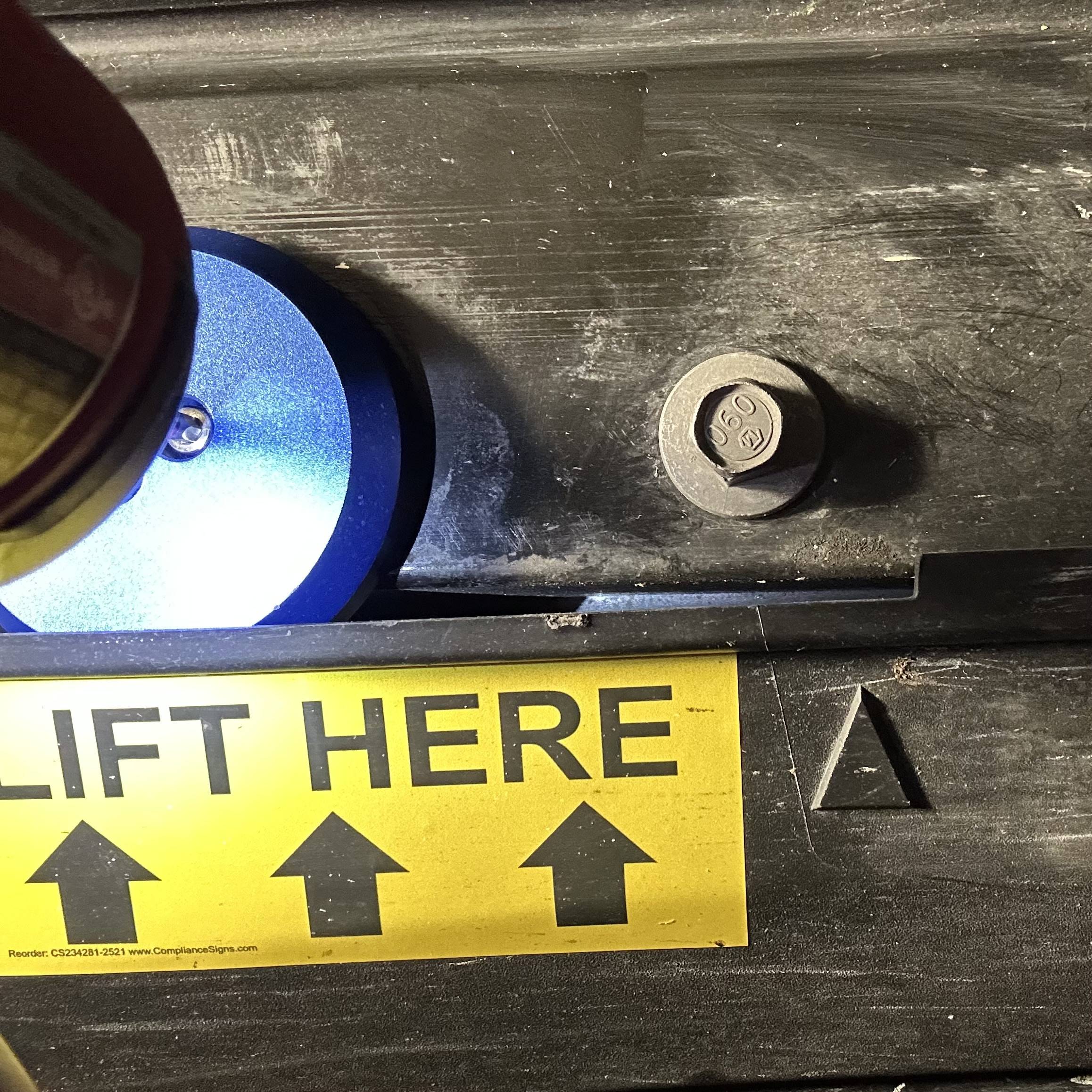

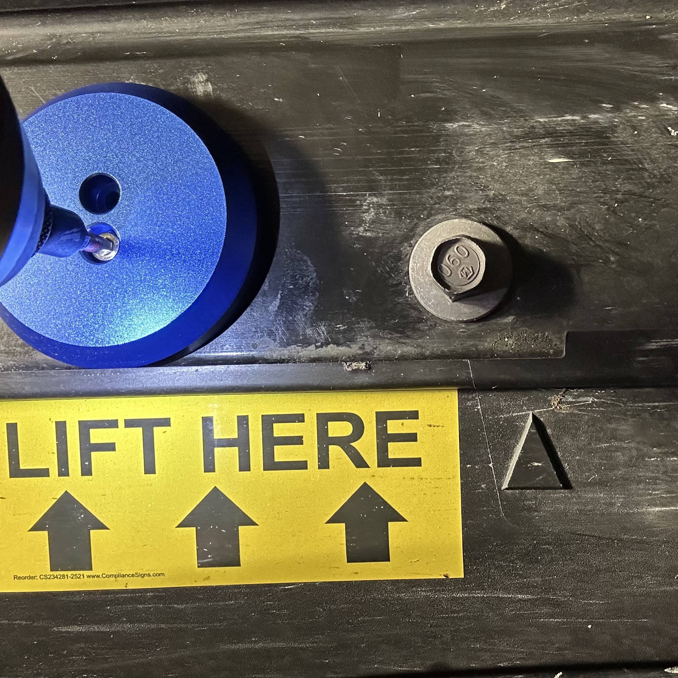

  2. Use a driver to back out the bolt as much as possible. The aluminum bar will spin inside the lift rail, but that's ok. The process will loosen the bolt somewhat (either from actually backing off the bolt, or from shaving off a little of the aluminum bar as it spins!).
    Ford Mustang Mach-E Corvette Jack Pads installed IMG_1417

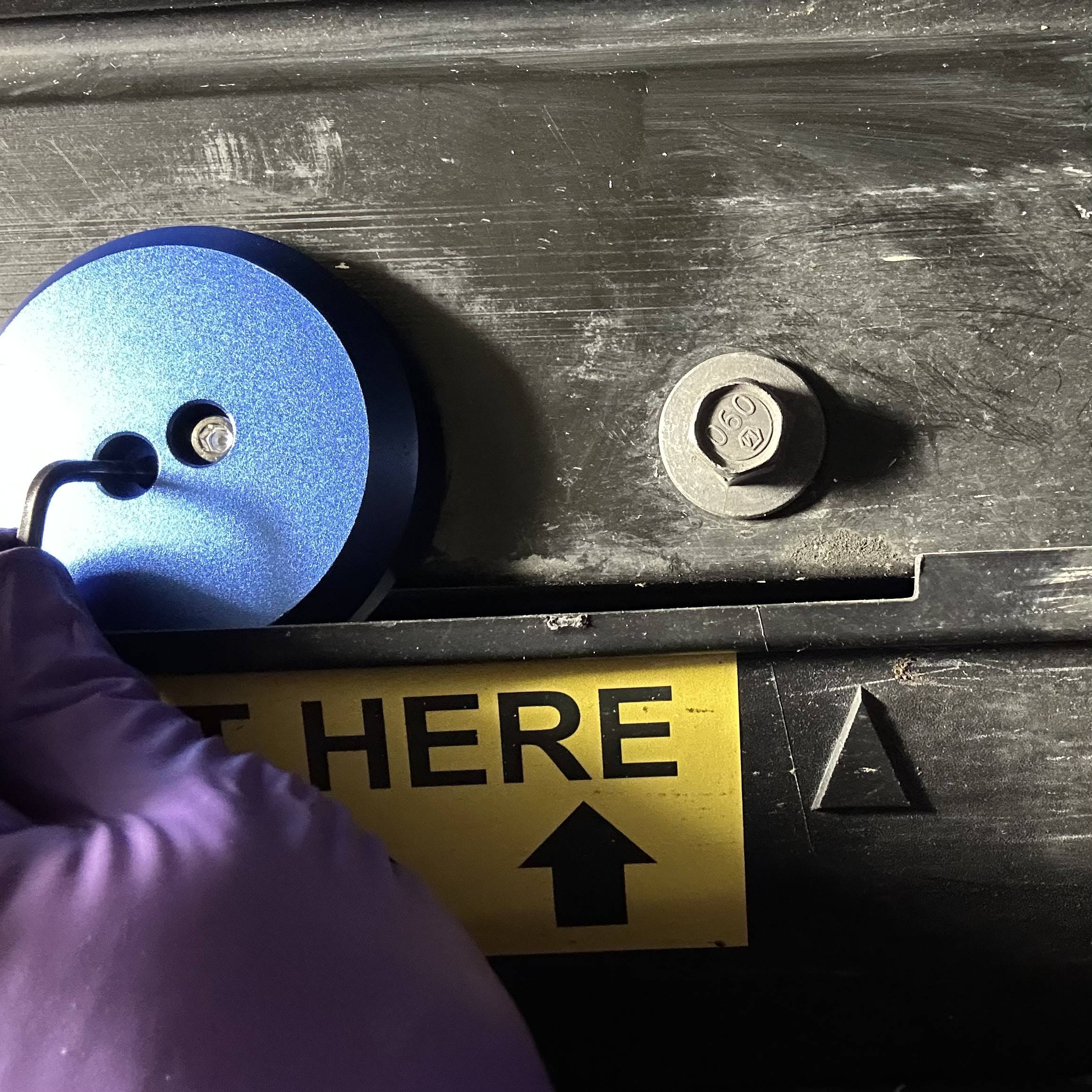

  3. Rotate the puck, maneuvering it under the loosened rocket panel trim. (This likely won't be easy, but it should be possible - if not, then repeat step 2 until it is.) Insert a piece of metal (such as a spare bolt or Allen wrench) into the second hole in the puck and continue maneuvering the puck until the bolt/wrench slides fully into the hole.
    Ford Mustang Mach-E Corvette Jack Pads installed IMG_1418
    Ford Mustang Mach-E Corvette Jack Pads installed IMG_1419
  4. Holding the bolt/wrench firmly in place, back out the bolt until you can remove the puck assembly. You will likely need to hold the puck to keep it from spinning as you try to back out the bolt. Once the bolt is sufficiently backed off, you can remove the assembly from the rail.
