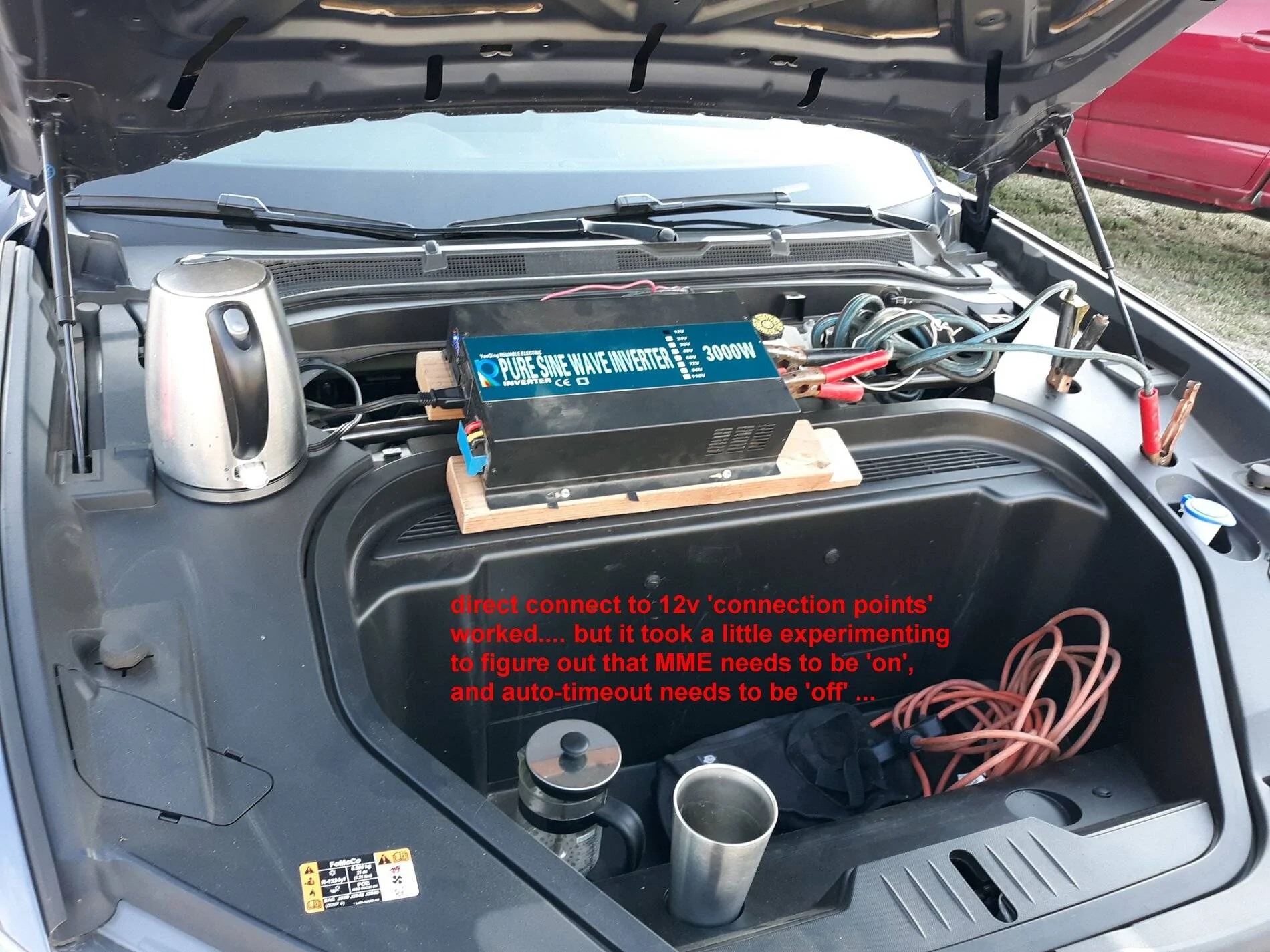

presumably you and your car would only care about a rolling brownout or emergency outage if you were home.... at which time you *could* extract energy from your MME to keep the critical loads like refrigerator, lights, computer, and phones running for days. Might not be able to run ALL your A/C, but you'd get by running at least one if you powered up a 2000-3000 watt inverter...
you *can* do this today via the 12v connections
Ford Mustang Mach-E Count your kWh... 20210623 testing w frunk teapot

I'd like to discourage using that large of an inverter, the DC-DC converter can only output 160A MAX under optimal conditions, which is under 2000W. It would be foolish to draw more than 1000W and risk burning out the DC-DC module. Also sloppy using unprotected jumper cables an inch apart from each other. Short those by accident and you'll probably be stranded and looking at a $1500+ repair bill that isn't covered by warranty due to misuse. Too much expensive hardware at stake here.
Bring a generator next time.
