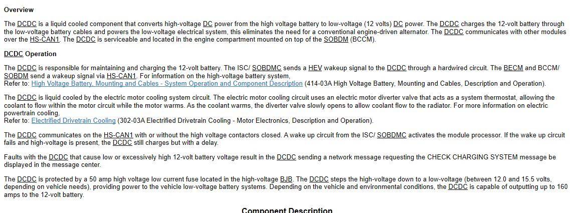

I'd like to discourage using that large of an inverter, the DC-DC converter can only output 160A MAX under optimal conditions, which is under 2000W. It would be foolish to draw more than 1000W and risk burning out the DC-DC module. Also sloppy using unprotected jumper cables an inch apart from each other. Short those by accident and you'll probably be stranded and looking at a $1500+ repair bill that isn't covered by warranty due to misuse. Too much expensive hardware at stake here.

I purchased a 1000W inverter to do this job using our Leaf. You could probably use as much as a 1500W on the Mach E as it has a peak delivery of 1920w through the DC-DC inverter.
Bring a generator next time.
jumper cables to designated 12v 'connection points' are obviously a temporary test connection.... Anderson connectors or something similar will be a more dependable/safer connection, but will require removal/modification of the 'beauty cover' and installation of better connectors.
an 'oversize' inverter shouldn't harm anything as long as continuous export is less than 2000 watts and the dc-dc can 'keep up'. Since the recharge of the LVB is thru a circuit breaker, and the dc-dc presumably has some max output designed to run all the big stuff like the cabin and battery heat pumps for extended periods. I would love to get some confirmation on the 160amp limit, where did you see it documented?
What I did find is that for loads over about 1000watts, it is best to put a second battery in parallel to prevent the voltage sagging down below what the inverter is happy with before the dc-dc kicks in, or 'start' the car or begin with a smaller load to wake up the dc-dc before hitting the little battery with a big load.

Any idea what document that came from ? I'd like to get my hands on the specs for the dc-dc, and the suggested repair/replacement procedures for access to the HV fuses/circuit breakers.

aha, I didn't see that till I refreshed my browser.
It's from one of the Ford maintenance/specification documents accessible to folks inside Ford or those with maintenance licenses.
