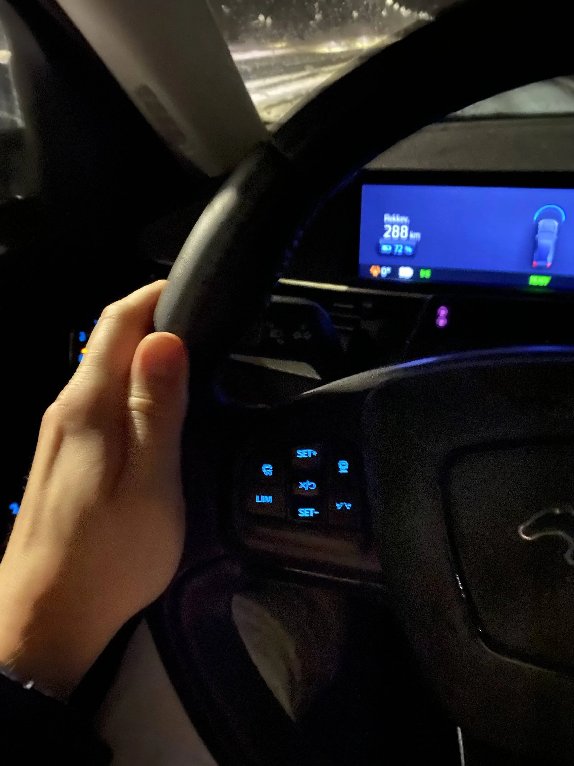

To help prevent further confusion I’ll write a shorter and more precise description:
1) See image. When car has been started I click the bottom right button to disable lane assist. In Europe you have to do this every time you start car as its default is on.
2) Click once on the top left button, to later use CC. This is the same as any other car out there like Golf’s, Leaf’s etc ., the speed of the Cc you set with the “set -+” when ready.
3) Car goes without any other inputs full throttle by itself.
Context:
1) Car is set in auto hold position and icon is still on when this happens
2) Happened about 3 times over the course or 2 years and 100 000 km. Seems somewhat related to remote start.
This is not the same on every car.
On Hondas, I have to turn the cruise control system on or off with one button, and use separate buttons to set or change or cancel a cruising speed.
On the Mach-E, when the on/off button is enabling the system, it is ALSO setting the cruising speed. Therefore, on this vehicle, there is no benefit or time savings to turn on the cruise control system prior to need.

In the USA we don't have the LIM button (which I assume is speed limiter?), can you explain how that functions differently than the cruise control button above?
Cruise control won't engage below 15 MPH on my car, so I don't see how that could happen? You can't get it to move the car from a stop unless it was previously set (and you have to press the center button). Pressing the left side button will never make it go from a stop.
Exactly! It should not be possible, yet somehow the car speeds up by itself when standing still and in auto - hold mode. It has only happened about three times over the course of two years, but it is really dangerous, hence why I try to figure out if more has experienced this.
The LIM function is basically limiting the max speed, but no CC or such. Useful when sensor is blocked or on a country road. To pass the limiter you have to push the pedal pretty far down, hence it’s hard to accidentally pass the speed limit.
