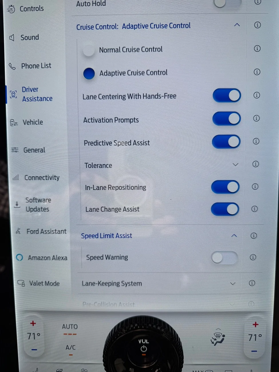

The screenshot doesn't show your tolerance setting. Can you open it up to verify?

I opened it up and verified that it was set to 0. I took the picture after closing it so as not to interfere with the other sittings in the pic. That would also not explain the sudden change in the cruise control setting change from 75 to 85MPH. I also don't think the tolerance adjustment is even close to 10 MPH ( if I remember correctly)
You have Predictive Speed Assist on. You need to turn it off.
This is a result of your newer car having settings your older car did not, because it's more updated. As I said, totally explainable.
You might want to go back and read your posts in this thread, the responses, and now the reality that it is in fact you not knowing what the new setting does that caused the problem.

I thought before you said that Predictive Speed Assist was off. With it on, and with a tolerance of zero, if it thinks that the speed limit has changed, either by seeing a speed sign or by what it has in its map data it will change to that speed.
Also, at this point it isn't clear if you were actually in BlueCruise or Adaptive Cruise control (EDIT while I was posting this you clarified that it was BlueCruise). BlueCruise is limited to 80 mph, but Adaptive cruise isn't.
Personally, I have Predictive Speed Assist off. If I'm in "windy roads" I don't use either of these, as such I don't count on them slowing me down in curves and speeding up afterwards. In other "straight highway" situations I want to be the one that changes the speed.
And how would that change the speed setting from 75 to 85 MPH? My interpretation of the predictive speed assist is to slow down the car when approaching curves and exits. NOT to instantly reset the speed. There are no 85 MPH signs anywhere in this state. Are you saying the car misread signs 3+ times in 30 minutes? If that's the case, the system is horrendous and should be deactivated from all cars. And yes, I was CLEARLY using BlueCruise unless Adaptive cruise control allows me to drive hands free for miles and all the blue indicators on the dash are completely wrong.
