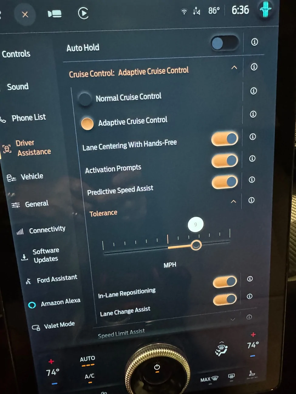

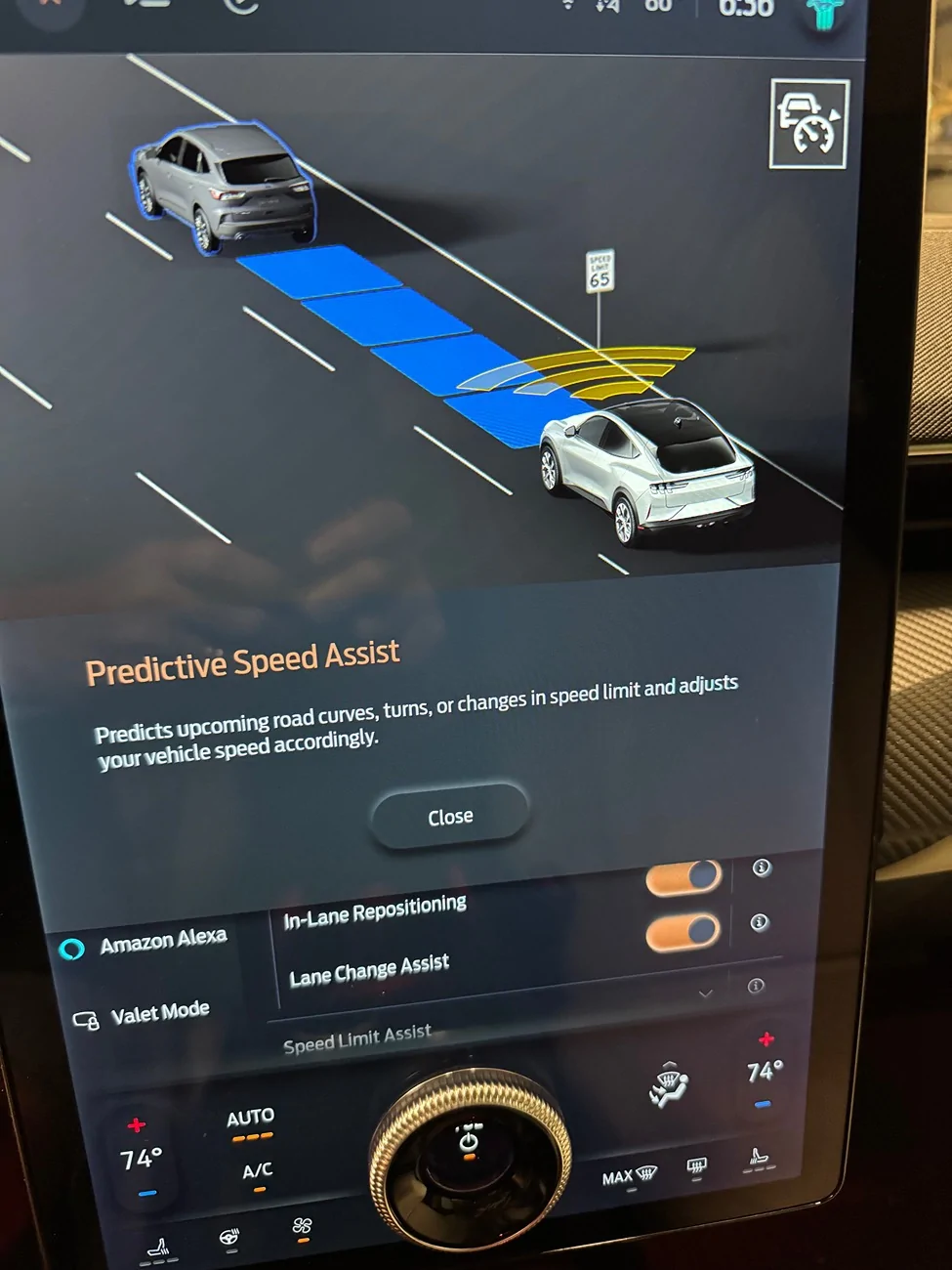

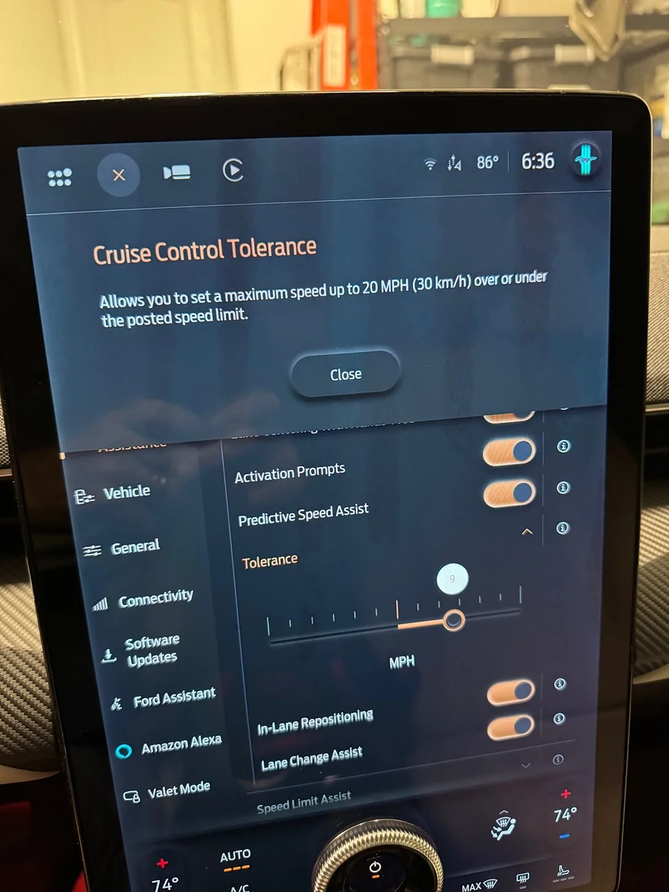

A couple points of clarification:
1) You can be in Blue Cruise above 81 mph just not hands free. In the OP’s situation, he can be in hands free Blue Cruise at 75 and then when the car accelerates toward 85, it will revert to hands on Blue Cruise passing 81, sound an alert and tell you to put your hands on the wheel and stabilize at 85.
2) Predictive Speed Assist includes both curve speed adjustment and speed limit speed adjustment (see screen shots) and can be set at any number between -20 and +20.
My guess is that there is either a sign that isn’t a speed limit sign that says 85 on it in big numbers (less likely) or the Blue Cruise database has an erroneous speed of 85 encoded into it (more likely Since it happened 3 times).
I use Blue Cruise on the highway all the time. I also use Predictive Speed Assist all the time in the highway. I’ve had it speed up and slow down because of reading the wrong signs and database changes. I’ve never come close to getting in an accident. It’s quickly and easily overridden with a tap on the brake or a press of the accelerator. It easily resumes by letting off the accerator and tapping the cancel/resume button.
