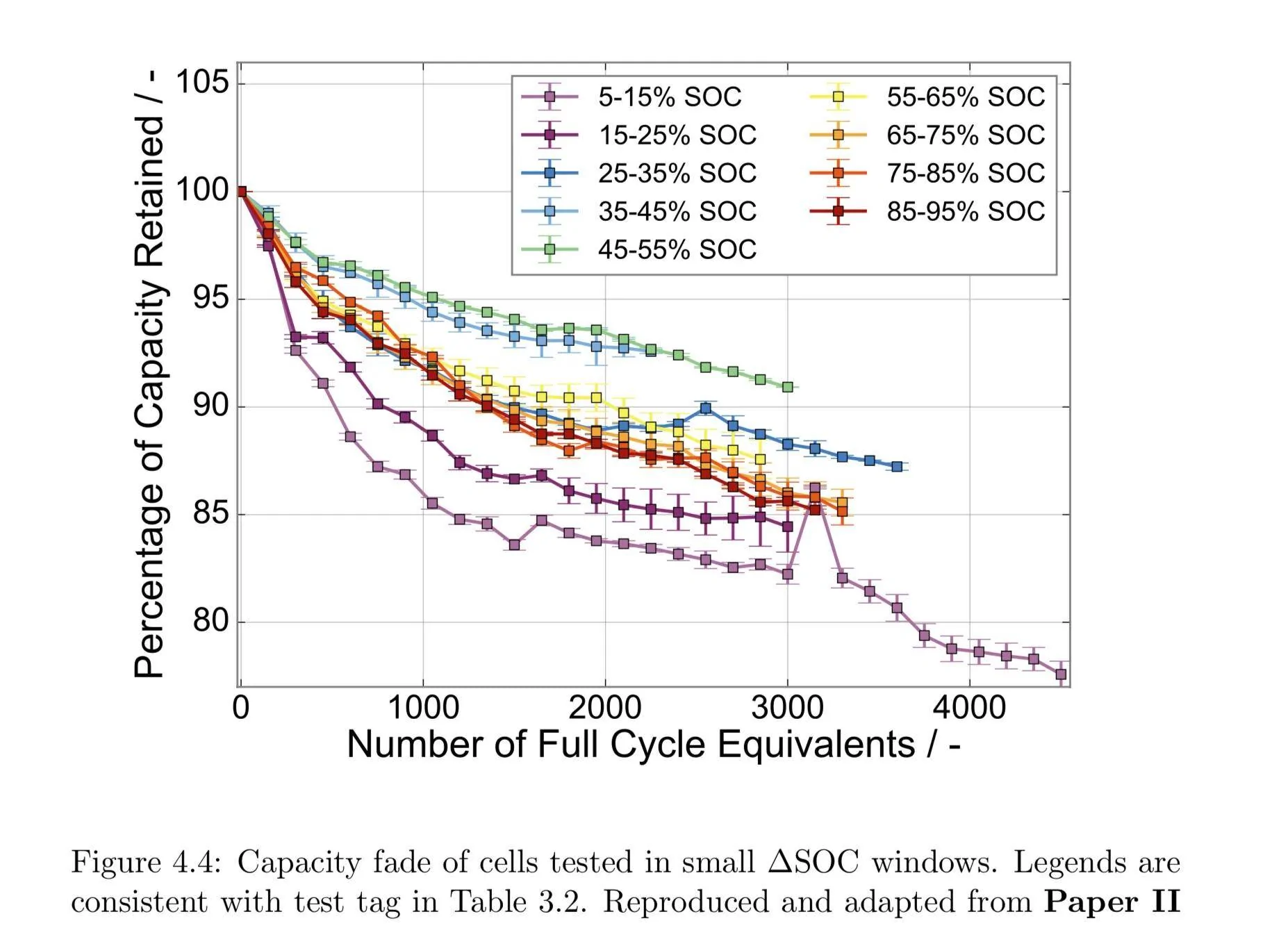

Lithium batteries like to be at storage charge which is typically 50% SOC (what that is for the cell type - ignoring BMS buffers - which is 3.8V cell for NMC/NCA cells).
https://teslamotorsclub.com/tmc/threads/some-new-data-from-research-on-tesla-model-3-cells.311793
Tesla owner with real world data. The degradation isn't too much worse outside the ranges but calendar aging is unavoidable - as in life.
TLDR: Stay around 50-55% SoC.
EDIT: Added image. See how if you stay between 45-55% SoC you can reduce degradation.
