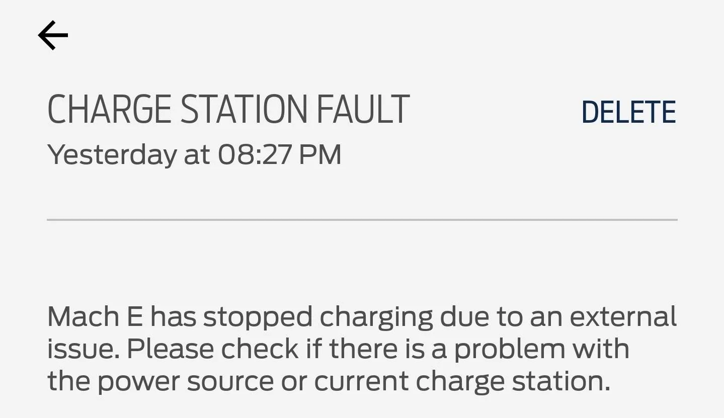

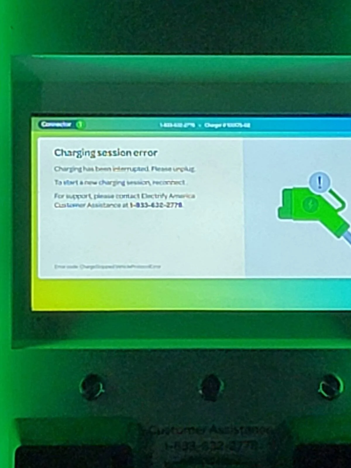

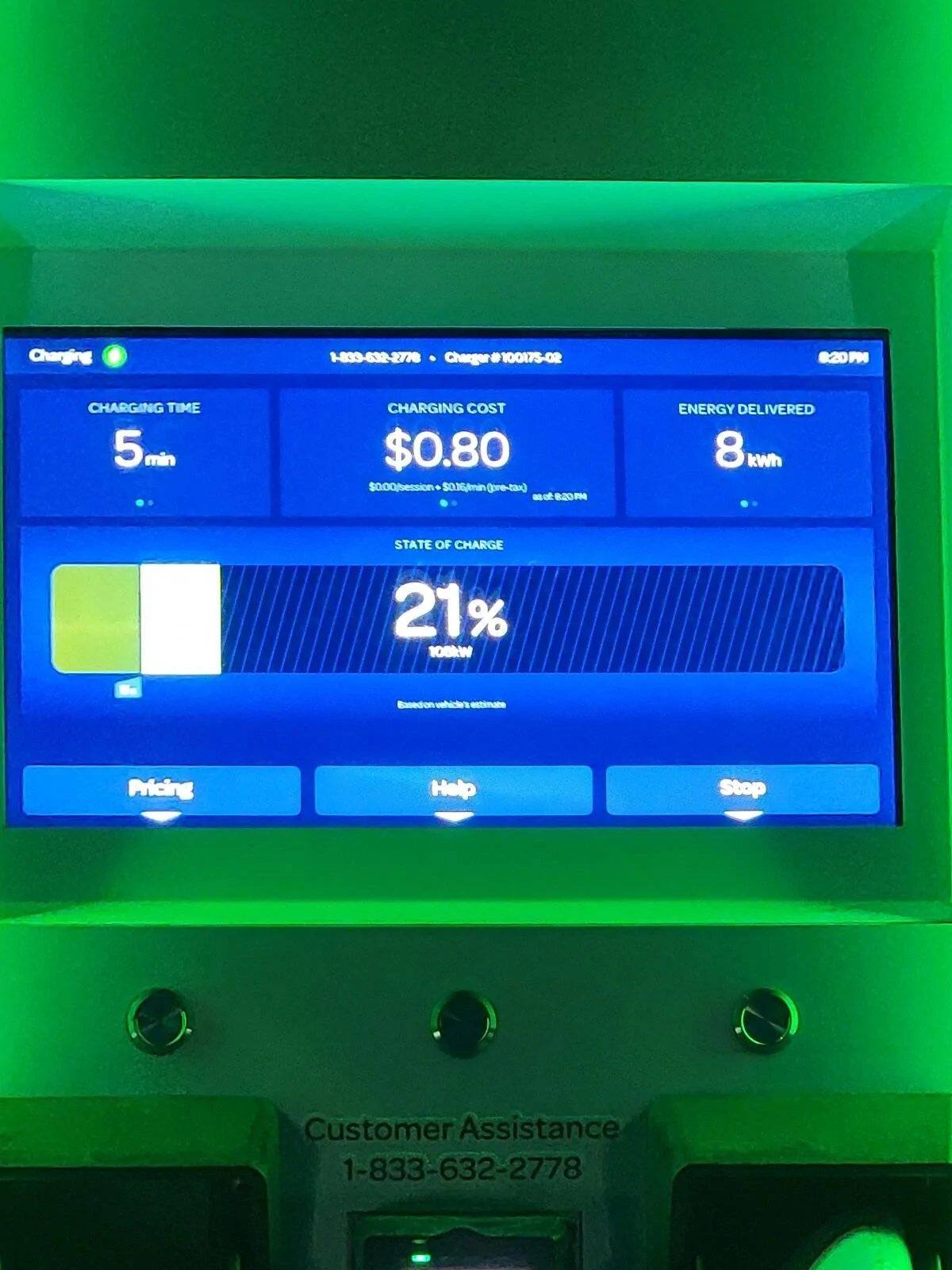

So I've charged at DC Fast chargers 5 times now. 3 times I could only get between 30kw and 40kw, while it was slow, it worked normally. However, the other two I got decent speeds, 90kw and 108kw, but when I get these speeds both times, it errored out at 34%. The car gives an error and unlocks the charge port and then the charger says charging failed. Below are the pics from the EA station. I missed getting pics of the cars error.
I only thought it was weird, because both times I've gotten the higher speeds, it failed at the exact same charge %.
Anyone else experienced this or something similar? One time was EA, and the other time was a non-EA station.
(On a side note, for some reason, this station only charged me $0.16/min. I think it may be because its listed on the website as a 50kw max charger when its actually 150kw)
