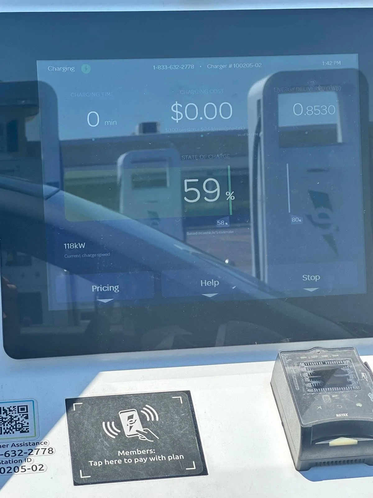

I hadn’t driven the car for a couple of days so I just wanted to go out for a drive, which is the one nice thing about having an EV. You can go out for a pleasure drive without worrying about the prices of gas cause the price never changes at home. So I set a route to the charger which was about 20 miles away. I didn’t know there’s a certain amount of distance you have to drive to precondition how do you know if it preconditions and this is one of those hyper fast up to 350 and the charging level seems to fluctuate between 95 and 115 that sound about right ?
