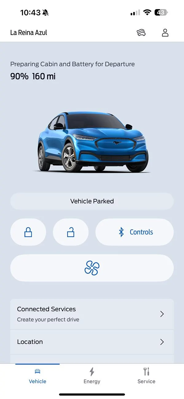

How can you tell if the car has been preconditioned? Say i set up a departure time for an hour from now, how can I tell?
You can hear it. Depending on the temp it will start by conditioning the batteries you can hear the recirc pump working and see the charger is drawing power. The app will also tell you it is doing it. The preconditioning of the cabin you should feel. When it switches to cabin (last 15 minutes or so) you will hear the blower fan and the charger will still be feeding power.

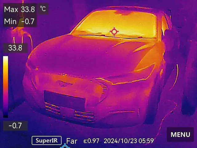

That certainly shows that the cabin is heating but doesn't necessarily show that the battery is preconditioning.
There’s a lot going on behind the grill and inside the front wings and the range was as good as it could be?

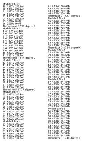

I'd have to see comparable images with battery preconditioning on and off during cabin heating to see if there is a difference.
Teslaeata
Sep 28, 2022
3,495
4,229
Nottingham, England, UK
Did a test last week.
Car has HVB SoH @ 93.5% on 103,500 miles.
At outside temp of 6degC HVB module temps (see attached image) were around 18degC after a scheduled pre-conditioning.
The following morning after a day out and a remote start at 8degC outside temperature, module temps were all around 9degC so probably had some residual heat in HVB from previous day’s road trip and no HVB pre-heating in remote start.

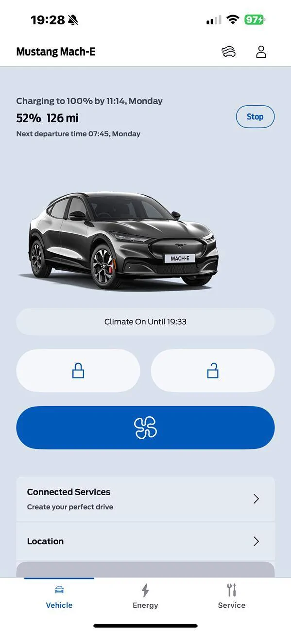

I usually see this about an hour before my departure time:
Ford Mustang Mach-E Preconditioning+ IMG_7866
