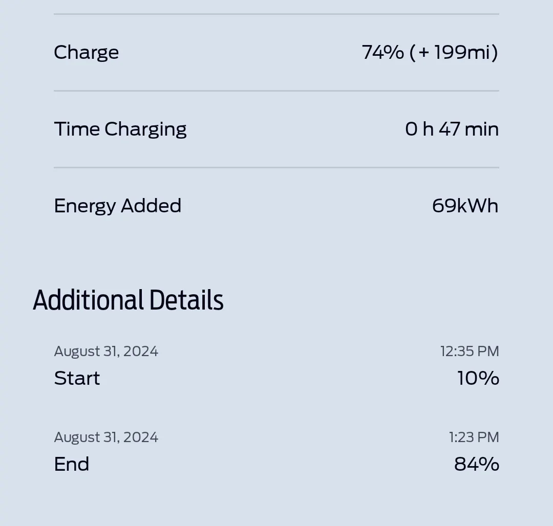

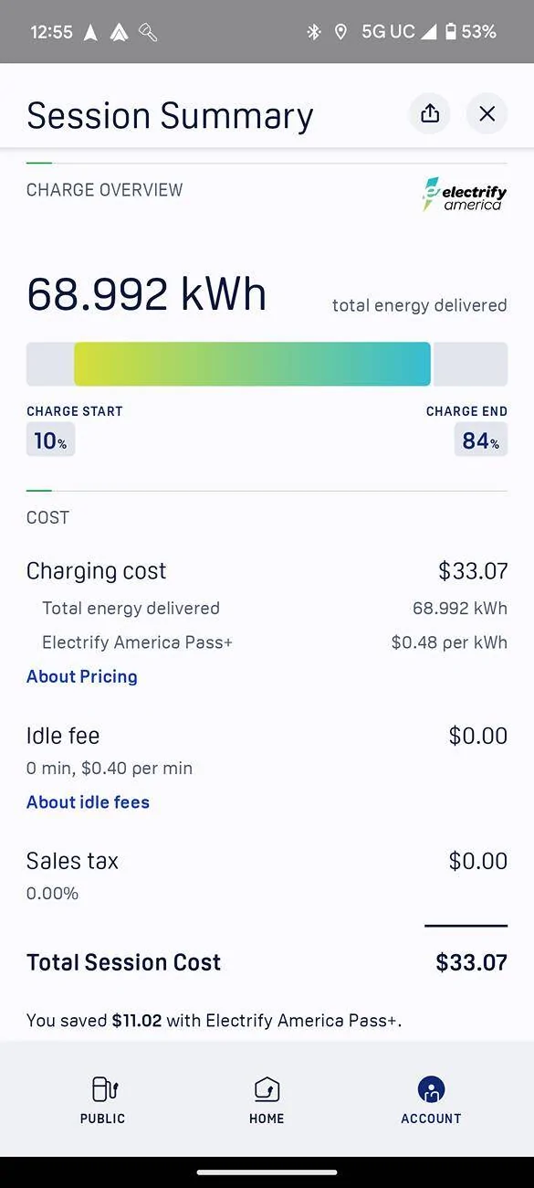

It doesn't seem like the Fordpass app only shows the battery charge, and doesn't account for additional consumers
I've been charging for quite a while, and the whole time I was in the car with the A/C on, it was about 100 degrees outside the window.
I don't see any difference in the EA and Ford pass data.
