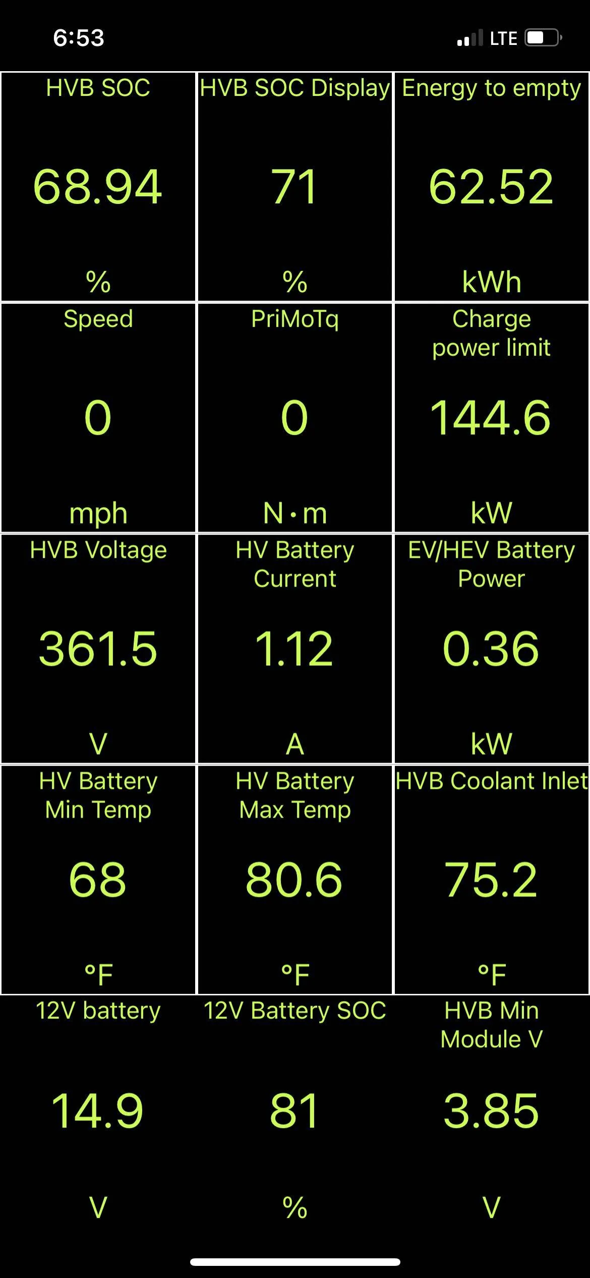

Did a little test. I set the in car Nav to DCFC and there’s a 30 minute time limit. The inlet temp reaches 108 degrees for 30 minutes. After the 30 minutes it went down to 75ish degrees. The charge power limit went from 89 to 144.8. This will differentially help with DCFC.

I believe that was added with OTA 3.6.1.

Did you do a control test without inputing the destination? If your turn on the car, and turn off HVAC while plugged in, it will heat the battery like that without a nav destination.
If you use preconditioning on 120V it will heat the battery for about 30 mins with only 1.1 kW of heat. Battery will only warm up about 4ºC. Better than nothing but not by much. I did a test with that previously.
