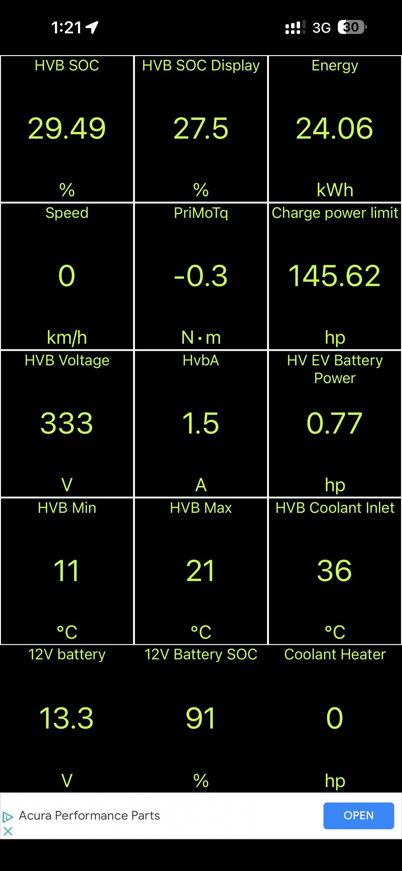

So I did a rough little test for pre-conditioning yesterday. I have a 2021 GTPE that’s kept fully up to date via FDRS so all modules are at their latest versions as of Jan 23, 2022 (i.e 4.1.3).
Test conditions:
Charger is 100km from origin
Vehicle was cold on start
Between -1 and -4 degrees Celsius outside
Clear roads, no traffic cruising at ~120km/h for most of the trip
Initial temp readings:
Had cabin heat running until I was approx. 40km away from the station, that’s when I noticed a slight spike in coolant inlet temp. I turned cabin heat off and when I reached 30km from the station I got a huge spike in coolant inlet temp up to 36 Celsius. It seems having the cabin heat on renders battery heating nearly useless as it shares the heat.
Final temp on arrival to charger:
So good news is it looks like preconditioning is working as designed. Unfortunately, the 150kW stations I went to were refusing to communicate with my car so I had to settle for a 50kW charger which didn’t allow me to test the charge speed.
This all begs the question:
How effective will this be when the temperature is much colder, say -10 or -20 Celsius? Being 30km away from the charger as the sole trigger for preconditioning seems irrational given the multitude of other parameters effecting vehicle range and charge speed.
I also had to disable cabin heat for any meaningful jump in battery temps, how viable will this be in extreme cold without causing much discomfort?

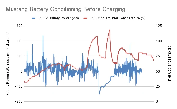

I saw battery pre-conditioning occurring on a trip from Memphis TN to Abilene TX this week. I saw a huge increase in max charging rate requested via Car Scanner app. Prior to pre-conditioning starting, max charging rate would have been limited to 101 kw; when we arrived at EA charger, max charging rate was 149 kw. Initial charging rate on car peaked at 148 kw for about 1-2 minutes then settled in at 115 kw until we got close to 80% SOC. I have more detailed numbers at our hotel. I will try to get them posted tonight or tomorrow. Pre-conditioning started 20 miles from charger.
SpaceEVDriver
Aug 26, 2021
71
2,658
4,787
Arizona
Planetary Science
I ran CarScanner on a spur-of-the-moment trip of ~250 miles during which we charged at about mile 160. After the first 100 miles, we stopped for lunch and from there I asked Ford to navigate to the DCFC charging station, which was about 60 miles away.
Here's a plot of the coolant inlet temperature and the battery power (where negative values mean charging). There were a lot of elevation changes during the trip, so we got some good regenerative braking, but did not see inlet temperature fluctuations during the first part of the trip. There was no massive increase in inlet temperature until we were about 30 miles from the charger. Our peak charging power was 151 kW and some change. You can see the peak dropped quickly, but I don't think I've ever seen it hit 150 kW during DCFC and I do a trip that requires multiple DCFC stops about once a month.
I don't run cabin heat until it's actually cold: below freezing outside and below about 50 degrees inside. There was no cabin heating during this trip until we were back up at 6500 feet elevation and the temperatures dropped down below 32 F.
The trip starting temperature was below freezing (but I started the car about 12 minutes before we left and the battery had time to warm up and the cabin was warm);
the middle of the trip was nice and warm (50s), and the end of the trip got cold again.

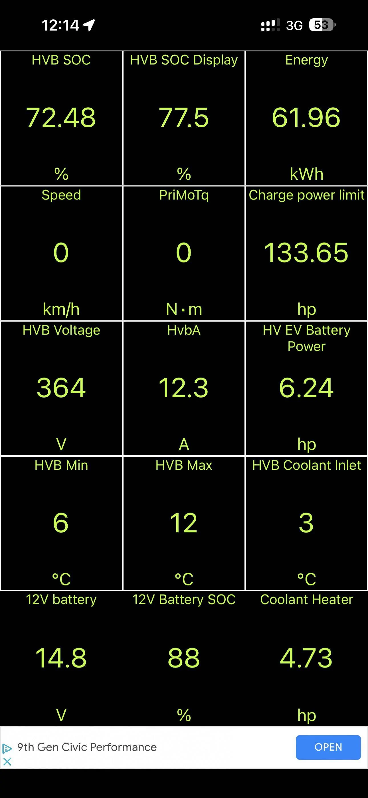

Also, it looks like the car will condition the battery if you're within the proper range of the DCFC and simply ask it to navigate there, even if you're plugged in to your home charger.
This morning, after a cold soak of the battery (HVB and exterior temperature both around freezing), I left the car plugged in to the 120 V Basic AC charger, turned it on, set the DCFC as the built-in navigation destination and told it to take me there. I left the car plugged in and then turned on CarScanner to watch the HVB Inlet Coolant Temperature. This is the result. Note that the temperature reached much higher peak than it did when I had remote started the car the day before (61 F maximum, even after driving a while).
So, it looks like you can use the in-car navigation to precondition the battery before you leave for a long trip or when it's very cold out by setting the immediate destination as the nearest DCFC (if there's one within 30-ish miles), even while the car is plugged in. Basic 120 V AC is not enough to keep the battery from discharging while performing this warming up.
Next test is to see what the departure settings do to the temperature...

Great tip! I'd do this before cold road trip.

I think it would work best if you have a Level 2 (240 Volt) charger. I lost about 1-1.5% of displayed battery state of charge while testing this on a 120 Volt charger. However, other interesting things did happen at the same time, so I think my actual range (not GOM range) increased.
