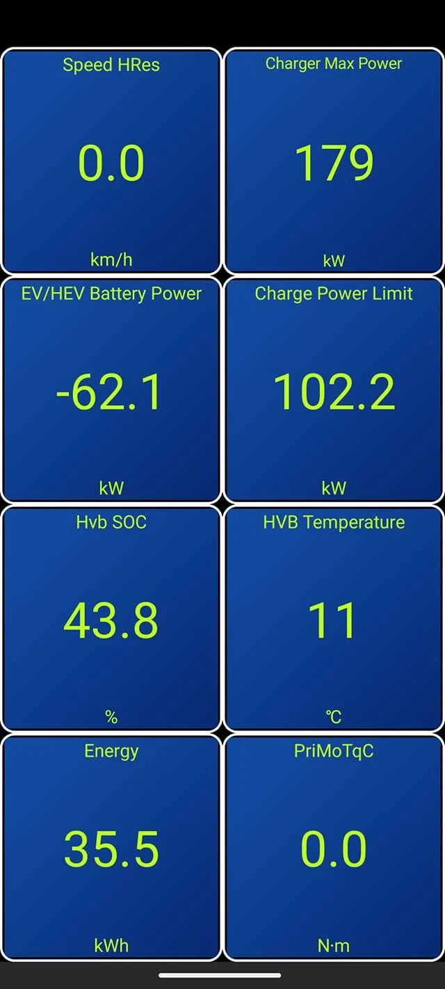

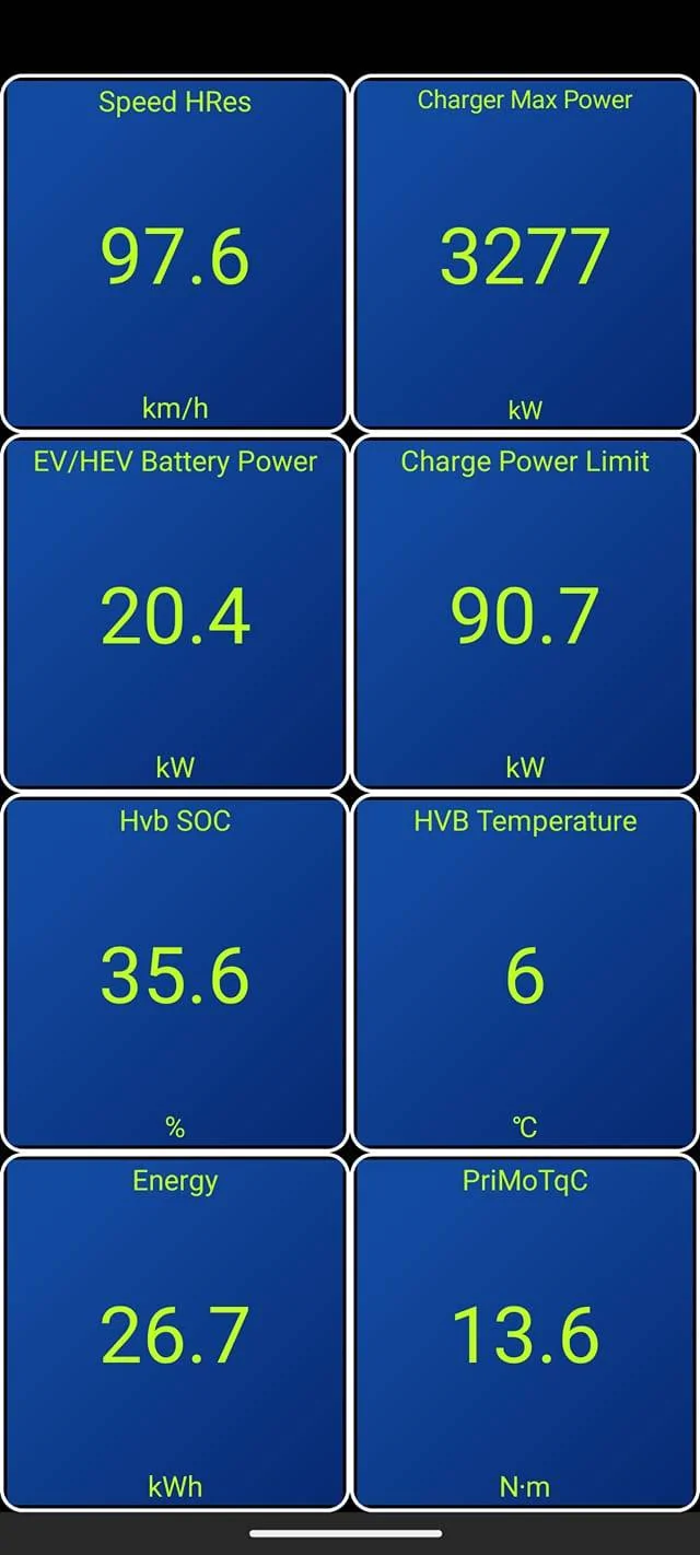

Does it differ really that much in charging time ? Yesterday i arrived with a hvb temperature of 6 degrees celcius (42,80 F), according to my ODB reader i could then charge at a maximum of 90 kWh.
After only adding 8% extra the charging maximum already was above 100 kWh and the temperature was already up 5 degrees celcius.. So when it is colder the car will start slower in charging but heats the batterij pretty quick and then will charge quicker.

It does in really cold temps.

Well yes. If your batt was at temp, you'd be up there at ~150kW charging. So in 8 minutes you've missed out on ~45% of your charge already. If you're doing a shorter stop, say 20 minutes, you'd have to spend at least 50% longer at the charger to get the same energy. As it gets colder it's much worse.
As for the heat pump extra efficiency question, it adds up. Performance would be closer to that of summer as you're having to use 1/4 to 1/2 of the energy in not only battery heating, but for cabin comfort, especially on those below freezing days where it can really matter.

I have a theory: if the charging speed is below the Charge Power Limit shown in CarScanner, the charger is the reason and not the car. I have seen that happen at most of my DCFC stops.
Charging started at 88 kWh and carscanner told the max is 90. So it was on par.
