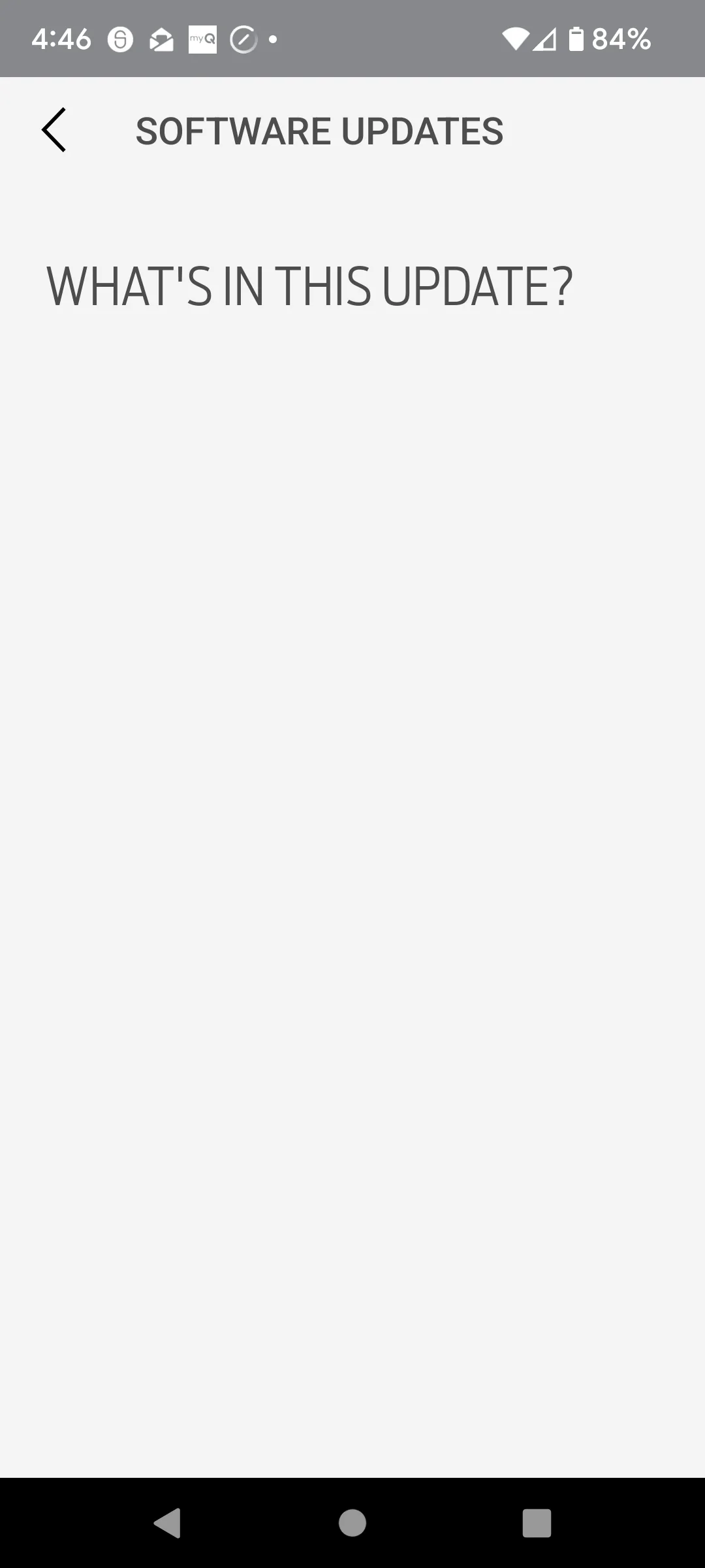

An easy way in the App:
Vehicle >> Features and Settings >> Software Updates >> Recent Changes
Click on the date it has listed below recent changes, and it should tell you what the last update that was applied is. That is your current version. The only time I would expect those could possibly differ is if you went to the dealership and had an update manually applied or manually did an update yourself. If you're just getting OTA updates, whatever is listed there should be your current version.
Ford Mustang Mach-E DCFC preconditioning is it coming???? Screenshot_20230123-164651
