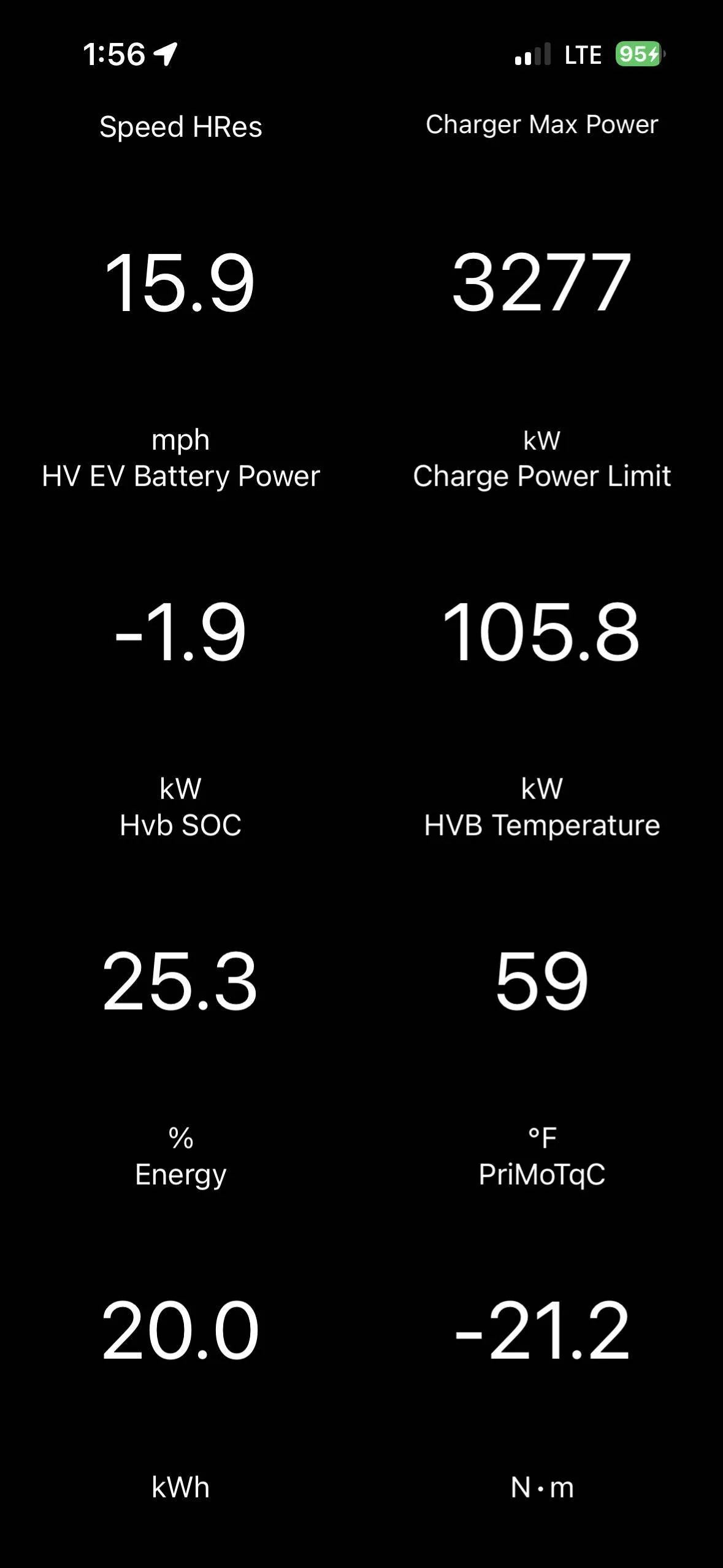

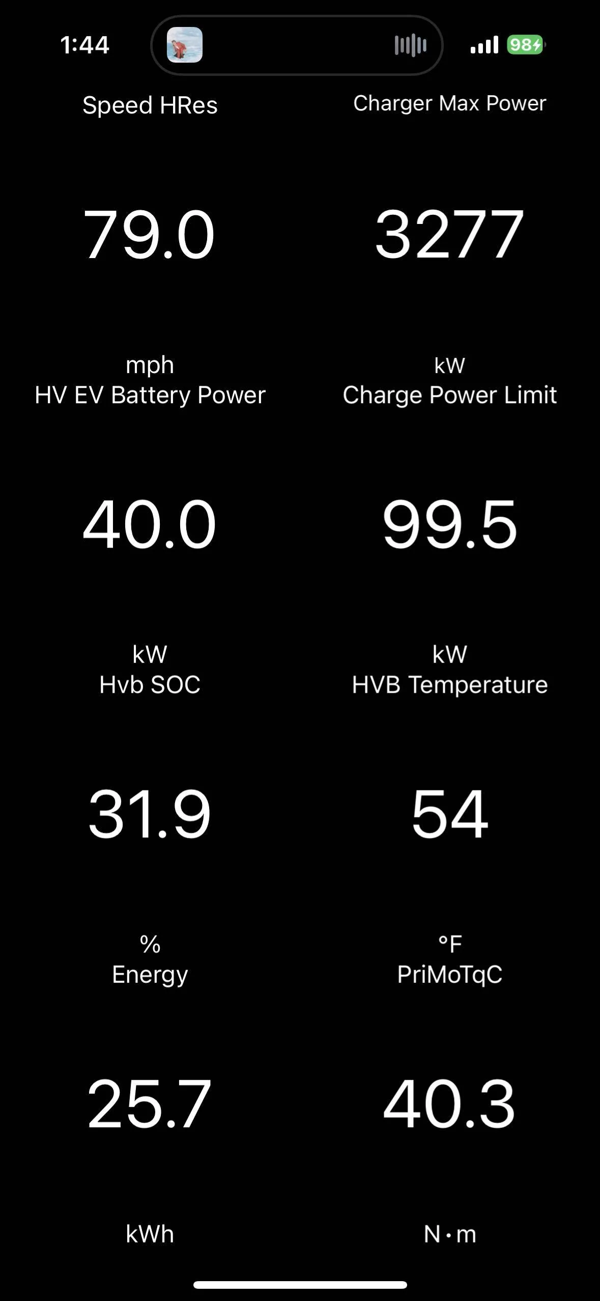

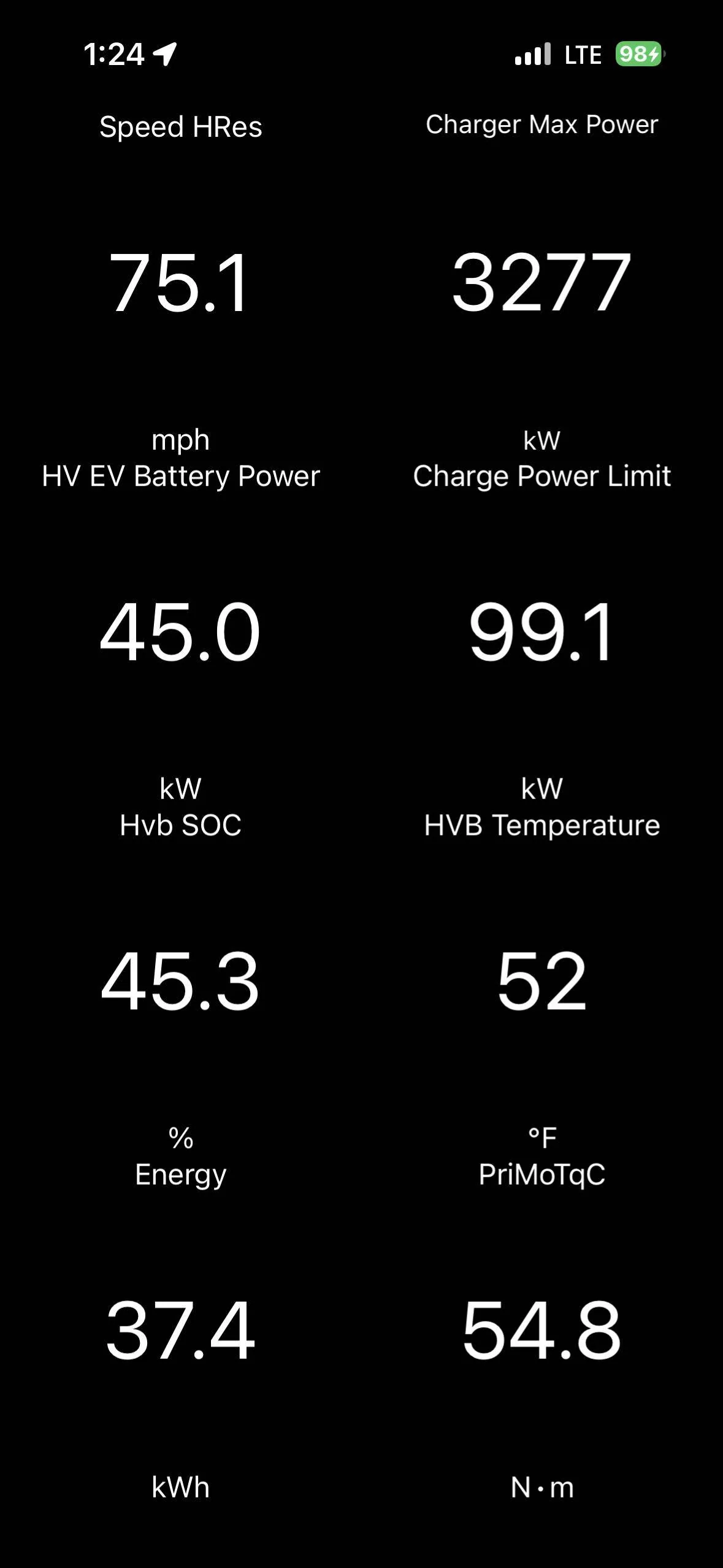

Well I have 4.1.2 and have a 200 mile trip tomorrow in 25 degrees. We’ll see. I never use Ford Nav but I guess I will tomorrow!
What temp should the battery be and how can I track it? What’s the best app? I have the OBDLink MX.
Might be working.. 26F out.
1:24 - 52F
1:44 - 54F
1:56 - 59F - rolling into Electrify America charger.
1:24 - 52F
1:44 - 54F
That could just be normal heating from regen, you need to monitor coolant inlet temp to verify it’s being heated. Should be 60+°F usually while heating.
