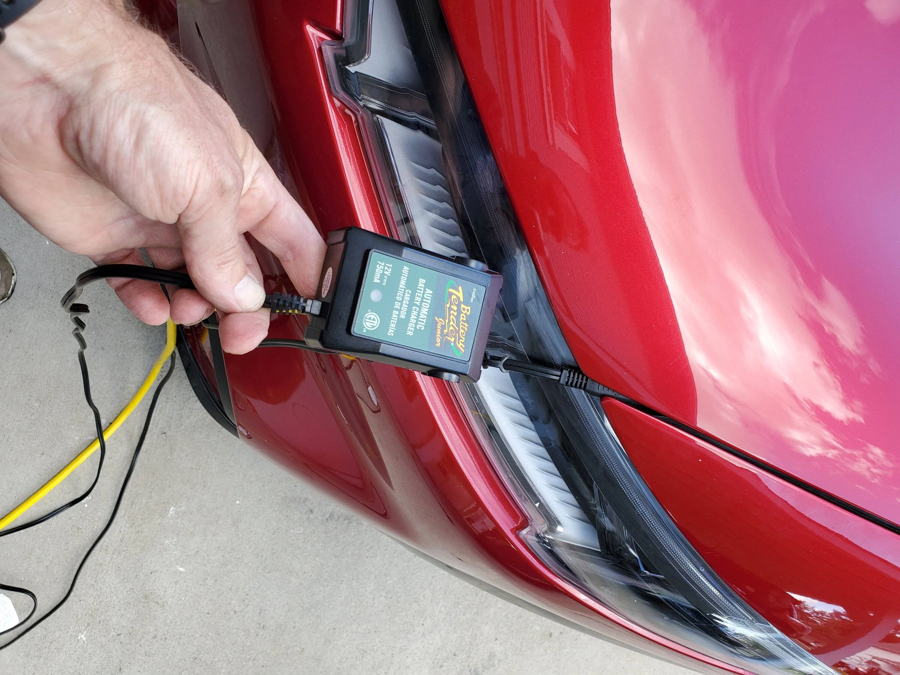

Run a trickle charger cable out the front. Hook up when needed or when car sits at nigjt

Do you just let it dangle there against your headlight when driving?
You can tuck it upward more under the hood. A long nose plier can pull it out. It is true the hvb and dcto dc inverter will charge the 12v battery. However, I drove 65 miles back from from the dealer with low milage 2021 Certified Premium and got a low 12V battery message on my Ford Pass. This 12v trickle charger floats on and off monitoring and saves some wear and tear on the charging port.
