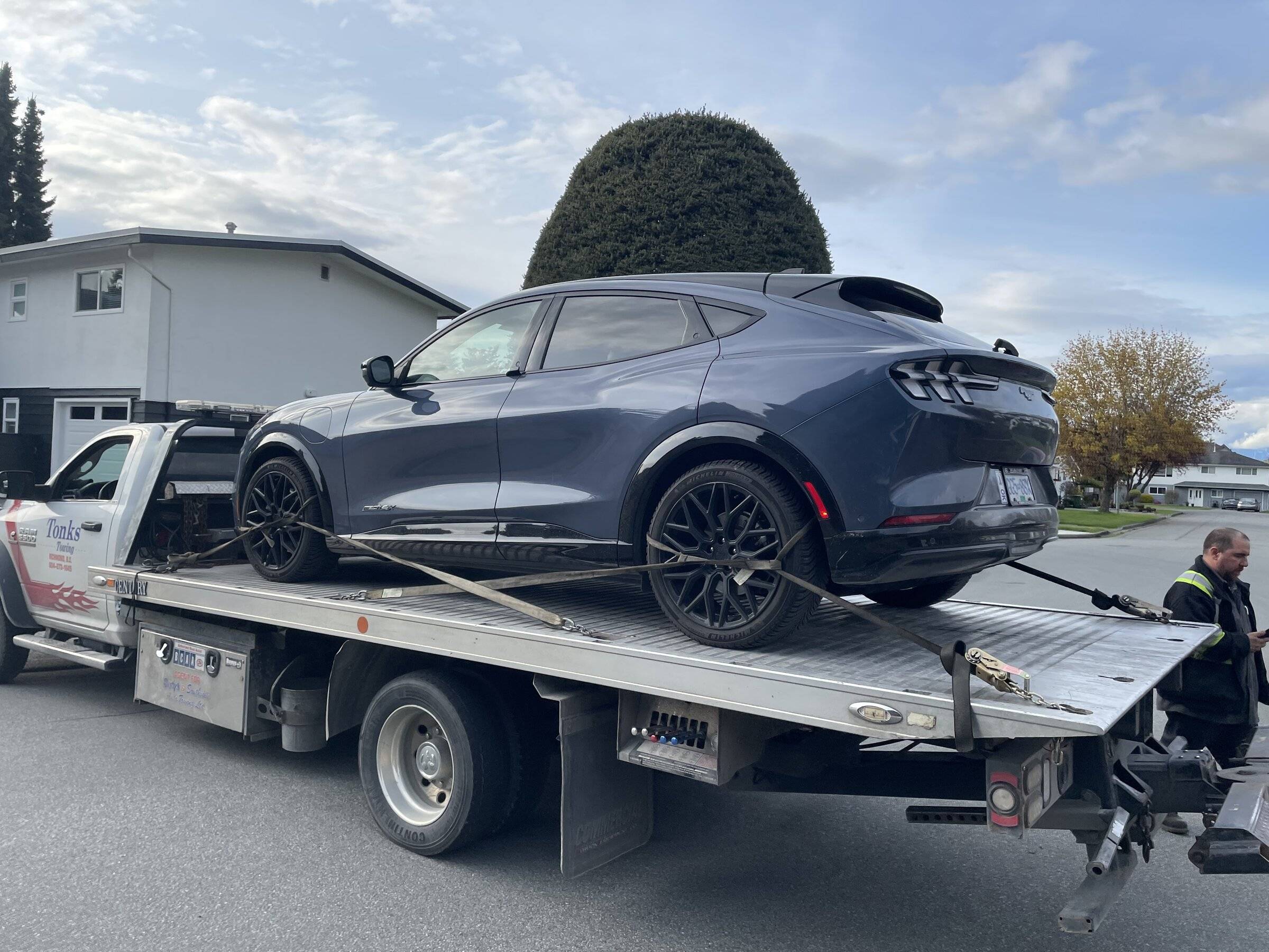

Ford Mustang Mach-E Dead while driving. 8A46001E-21DE-4839-A5CB-F186C2411AD2
same issue. will update when things happen. Thankfully had done everything for the day, got home and then charging fault. Went to move and got stop car fault.
I’ve been faulted out of drive electric week.
Called dealer, 12volt dropped to zero (was 12 at home and then down to 11volts when on the truck and then shut down). Good place to go I guess.
They say it will take them two days to even be able to get it in to the shop to look at.
No rental replacement.
if it dropped to ZERO, and screens went dark, I'd guess Dealership should pull the Frunk tub and check the nut first. If that's good, move on to the HVBJB.
