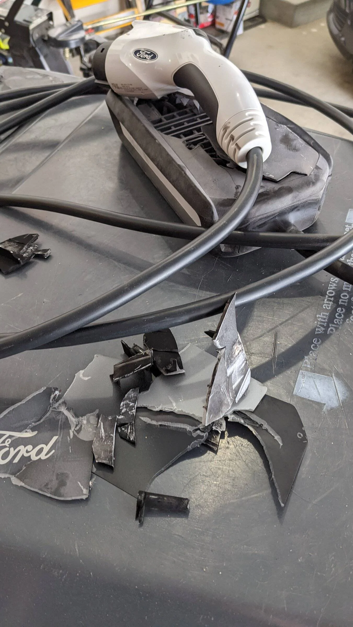

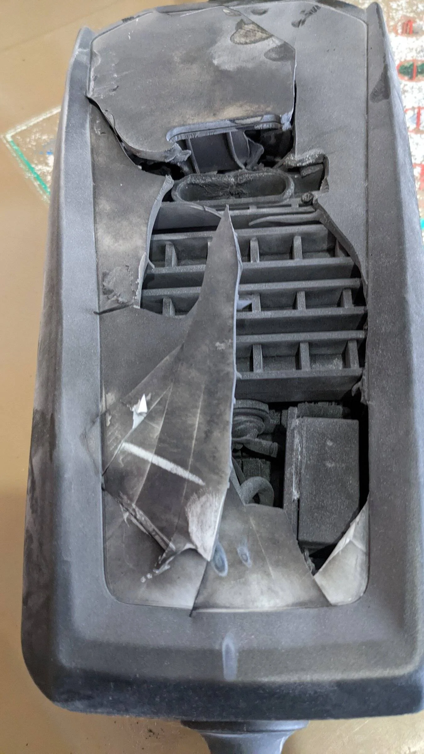

I posted about mine elsewhere, but yes, I'd say it was likely "defective". Dealer replaced it as well.
Ford Mustang Mach-E Defective Ford Mobile Chargers? PXL_20220218_150905206.MP
Ford Mustang Mach-E Defective Ford Mobile Chargers? PXL_20220218_151549925.MP
To annotate this further from this post, the mobile charger exploded after power was restored, tripping the main breaker multiple times and welding the 50A breaker closed so power could not be disconnected. Then it started on fire. Catastrophic failure.
To be fair from the chain of events it sounds like there was a major power surge at the house that caused the catastrophic failure, not the charger that caused the power loss.
Still scary though! I wouldn’t want anything to explode or catch fire under any circumstances.
I am in the camp of, no surge, or minor surge.
