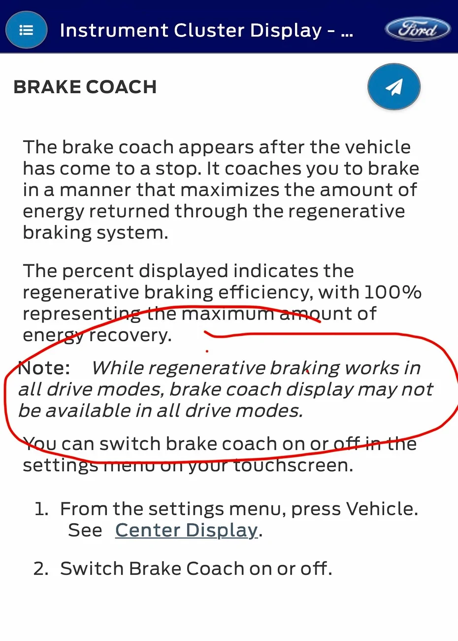

(EDIT: If you are in Engage mode and have the Brake Coach on you can see it in action. If you can get it to 100% (by lightly braking) then you are basically getting the same regenerative breaking as using 1 Pedal and stopping with just lifting off of the accelerator.)
I would like to see the brake coach post efficiency when I am using adaptive cruise control or blue cruise with the ugly stopping function vs one pedal slow down to a stop.
I typically release adaptive cruise control when I know I'm coming to a stoplight to control the stop better.
Me too, I find it really strange that you only see it in Engage mode, not even in Whisper or Unbridled.
The closest explanation I can come up with is that Engage mode is the closest to how an ICE car feels and this the "teaching mode". But it would be really nice to see the same kind of information all the modes and in situations like what describe.

Ok, now I'm curious. Perhaps they are configured differently in the UK? In 2pd on my NA 2022, there is no noticeable regen with the feet off the pedals. It just coasts. If you are pointed down a hill, it will pick up speed. It is the same as shifting to neutral. Both my MME and Lightning work that way in 2PD, so if there is any regen, it is negligible.
In your's, do you actually feel the regen drag in 2PD with no feet on the pedals?

I doubt MME’s are configured differently in this respect in UK, no noticeable regen is not no regen
Ford Mustang Mach-E Differences Found in Range Capacity When Using 1-pedal Drive vs. Not Using it IMG_9457
The statement is absolutely true. On my MME in 2PD, regenerative braking is applied when you press the brake pedal. There is no regenerative braking when I release the throttle in 2PD. This is the difference between 1PD and 2PD.
