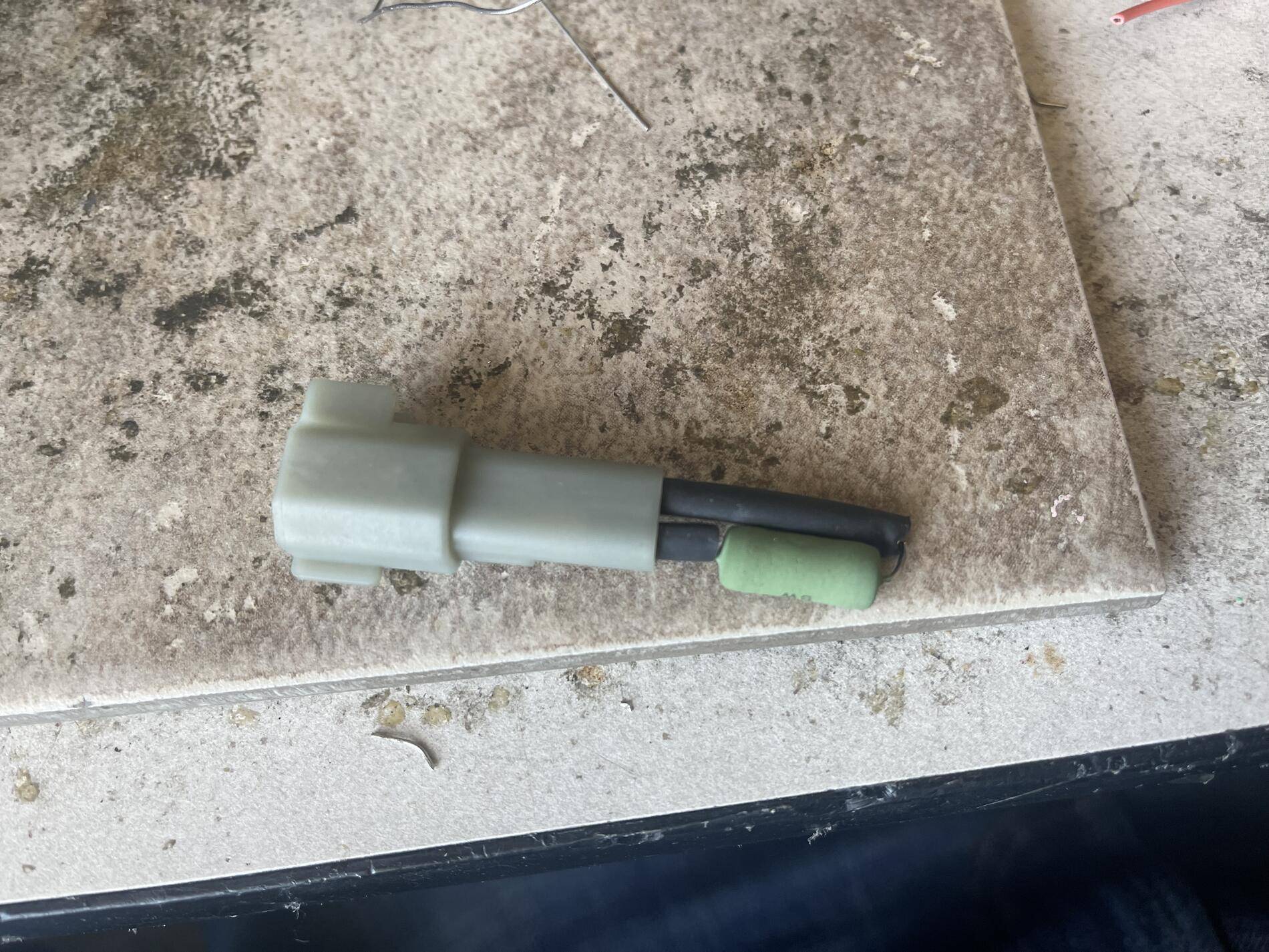

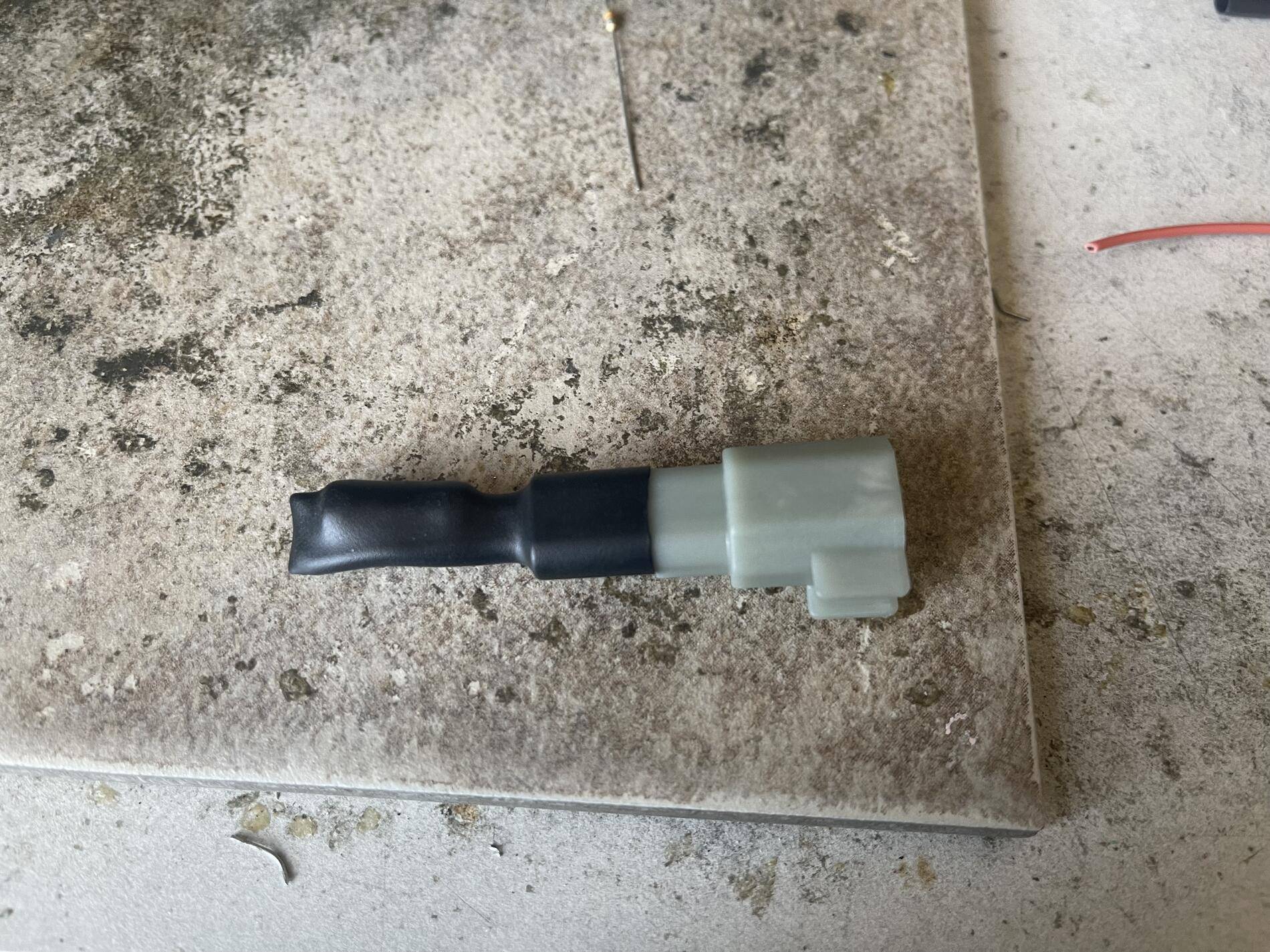

I made what I like to call the 'beeper deleter'. No, it's not for sale since technically it is illegal to defeat this, but if you're interested in making your own I can give you some simple info via PM.
I simply found the mating connector and stuck a 5w resistor in there then sealed it up with adhesive heat shrink and some electrical tape for good measure. I haven't installed it yet but it should work just fine.
Now that’s really slick! What is the connector name/type and size … and where are they sold? I’d like to do the same!!
Somewhere in these 23 pages the parts are specified. If you can't find them, let me know and I will see if I can find them for you. And I think there is link to the site that makes something like this and sells them.
