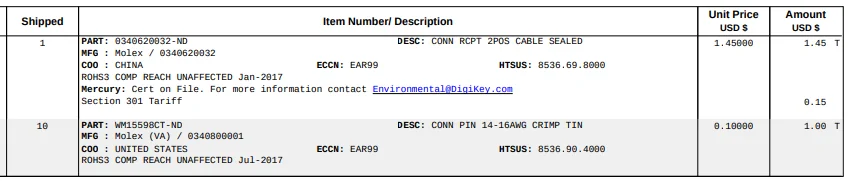

Somewhere in these 23 pages the parts are specified. If you can't find them, let me know and I will see if I can find them for you. And I think there is link to the site that makes something like this and sells them.
I’ve already trudged through the 23 pages a couple times and don’t recall seeing the connector part number and/or supplier.
As your pic shows, and as you said: “I simply found the mating connector.” So if you could just simply look up what you bought and from whom, I think that would be really super helpful to many … and especially to me! ? Thanks!

I think the matng connector was provided on either the Newark or Digikey site. I will look for it tomorrow...

You may want to reference the thread I created for adding a volume control to the pedestrian speaker. It includes the male part number I ordered from Newark. That one plugs into the speaker.
https://www.macheforum.com/site/thr...et-when-i-want-diy-instructions-photos.24840/
The female one plugs in to the car wiring and is what is needed for the beeper deleter, I think. It has been a long time since I did the mod so I suggest going under the car and confirming. Or just buy both the male and female and use the one that fits.
The female connector was not available from Newark when I purchased, so I got it from Digikey.
Molex Connector Part Number - 34062-0032 | Molex (connector)
Molex Connector Part Number - 34080-0001 | Molex (pin)
I ordered 10 pins since they are easy to damage, and I wanted extras in case I messed one (or more) up.

Edit: I just checked through all my installation pictures and I am 99% sure the female connector above is the right one for the deleter, not the male one. The male one is only needed if you want to connect to the speaker and send sound to it, like I did.
