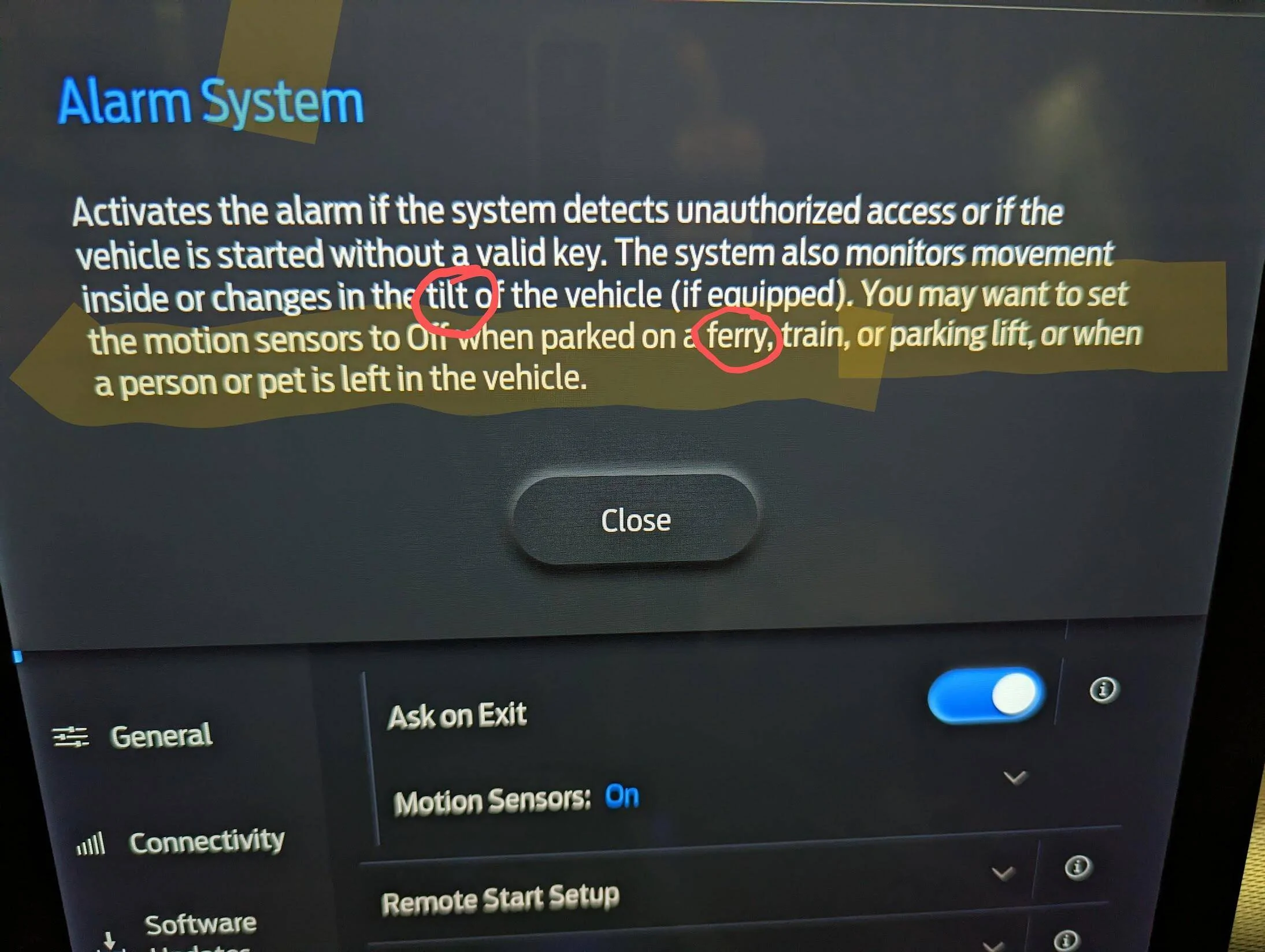

That said, I did look into the Vehicle alarm settings, and the description is confusing and contradictory. When I tap on the below "i":
Ford Mustang Mach-E Disable inclination (tilt) sensor 1678598381987
...I see this screen, which strongly implies that turning off motion sensors should also turn off the tilt sensor:
Ford Mustang Mach-E Disable inclination (tilt) sensor 1678598537487

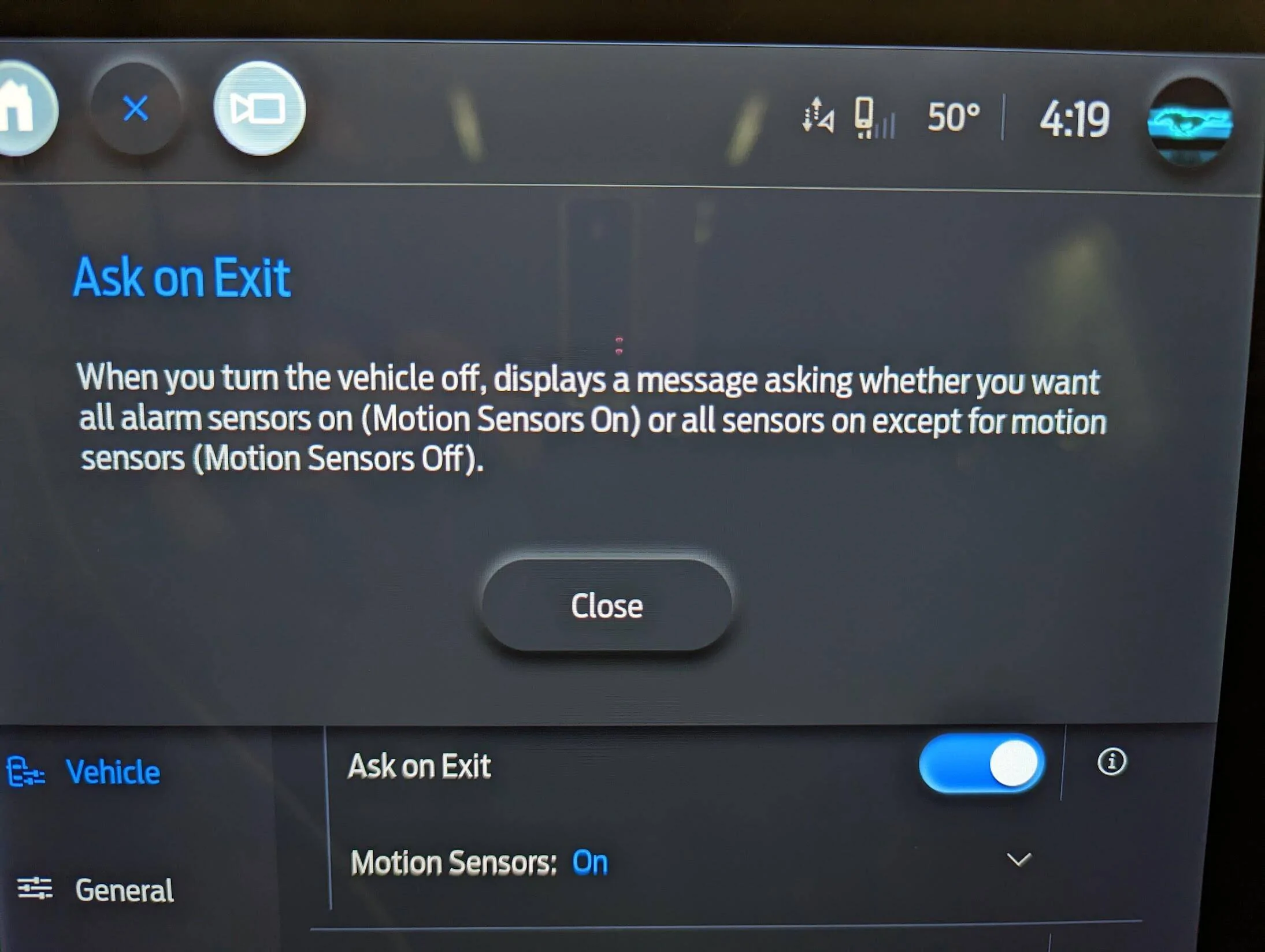

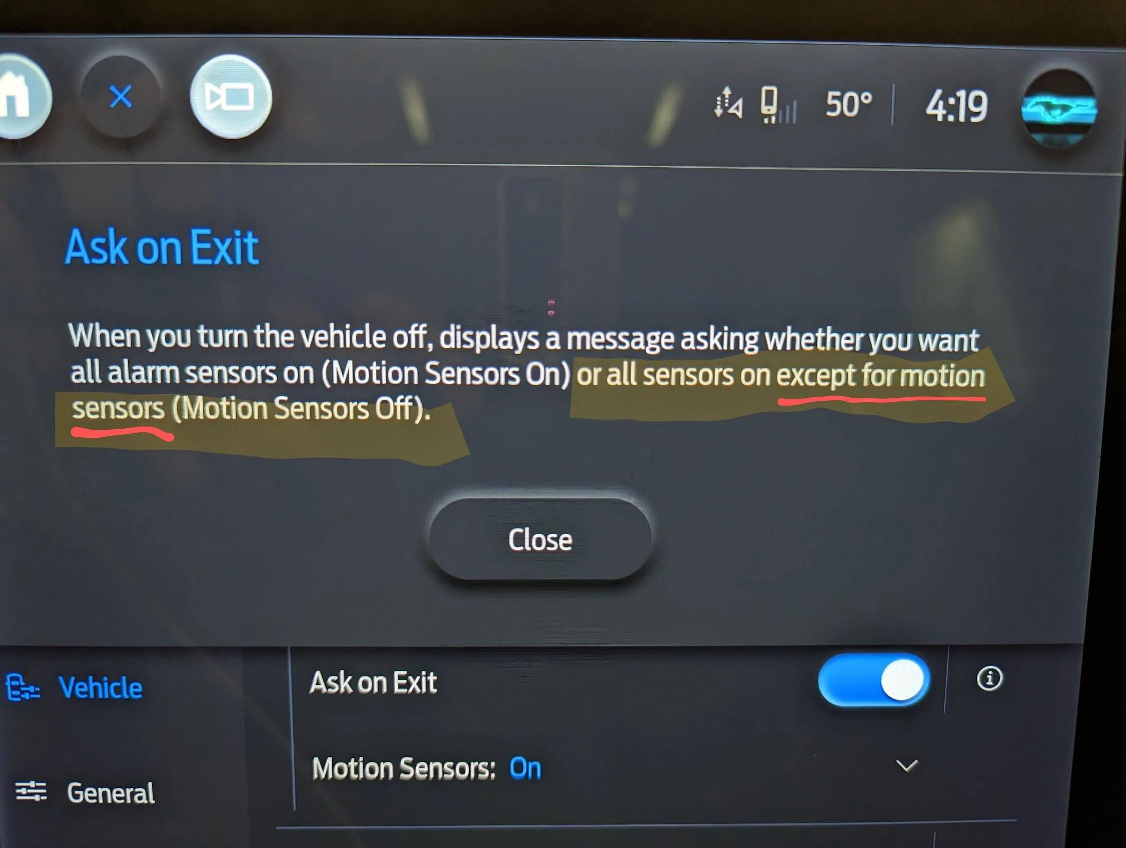

However! Tapping on the "i" next to "Ask on Exit" contradicts this implication, as it says:
Ford Mustang Mach-E Disable inclination (tilt) sensor 1678598689150
So which is it, @Ford Motor Company ? Is disabling motion sensors supposed to disable the tilt sensors, or not?
