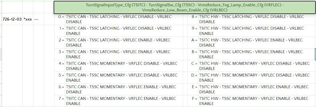

I don't think I have much more to add here. This is obviously not a huge issue, but it's an annoyance every now and then.
I might try flipping that bit for the latched vs momentary turn mode if I find myself with Forscan at some point.
