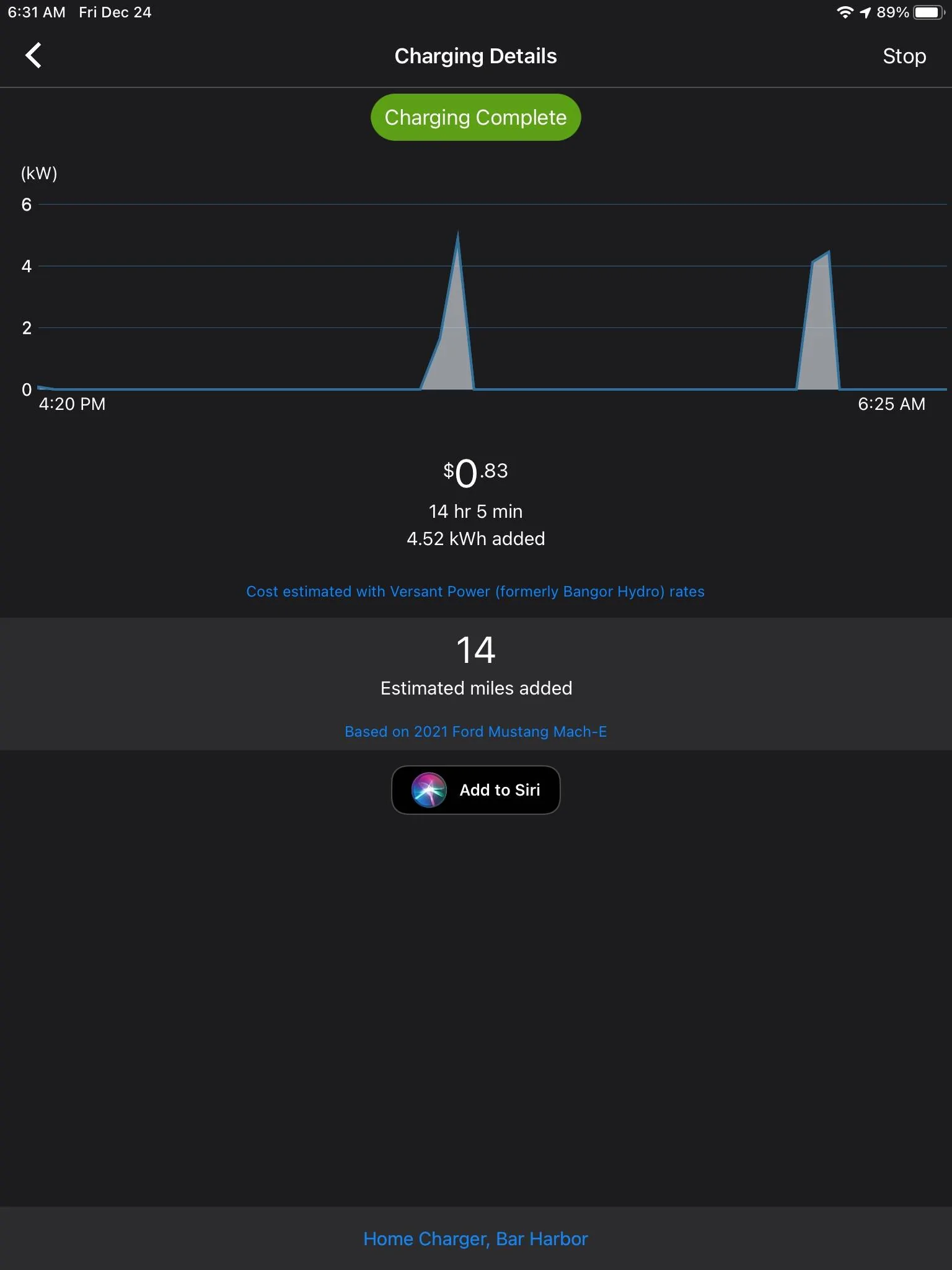

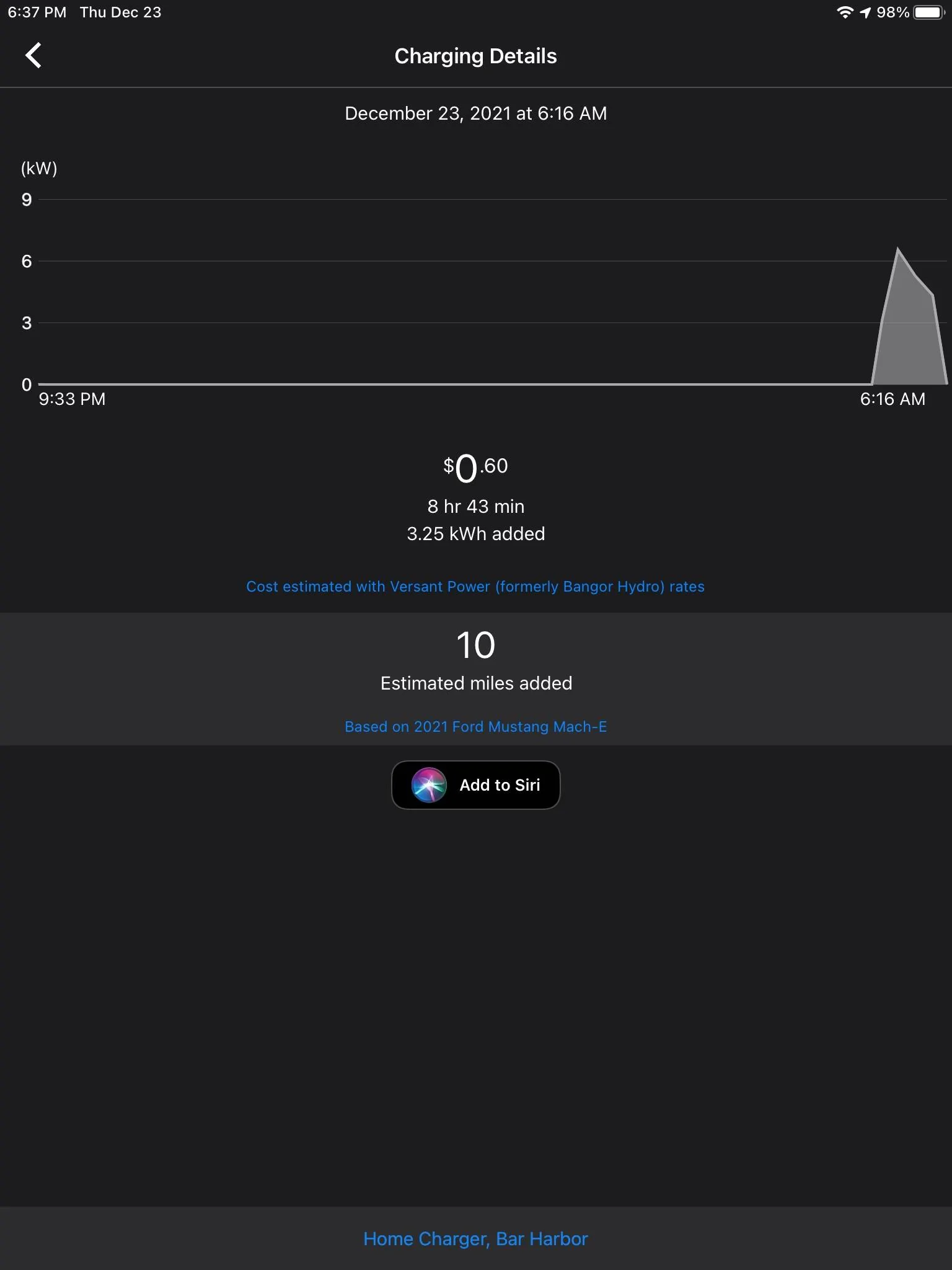

Here is night battery conditioning below 10f (automatic) and a morning precondition power curve just below I left for work.

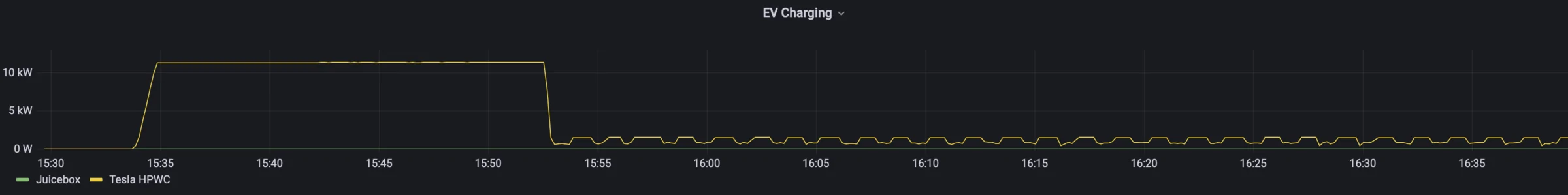

I left my MME in the On state since I wanted the car running so I could run some tests. At the start of my session I was drawing 11.3kW but once it hit 80% SOC it dropped to 1.5kW (climate control calling for heat) and 700W (no heat called for). Garage temps were likely in the 40s, outside was in the 20s today, seat and steering wheel heat were off but I left the radio on so the car would not be lonely.
