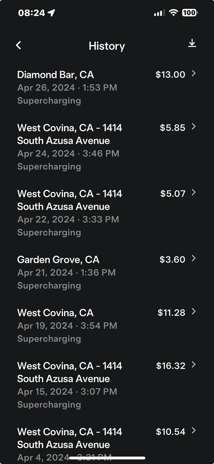

I've got the Tesla app. I'll have to use it for now until I figure out the P&C issues. Thanks.
Make sure before you use the Tesla app that you have connected your credit card and verified your billing address.
First time I tried using the Tesla app, with credit card connected, the app requested address verifications.
I use the Tesla app exclusively even though I have P&C - to get the Tesla member discount rate.
