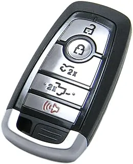

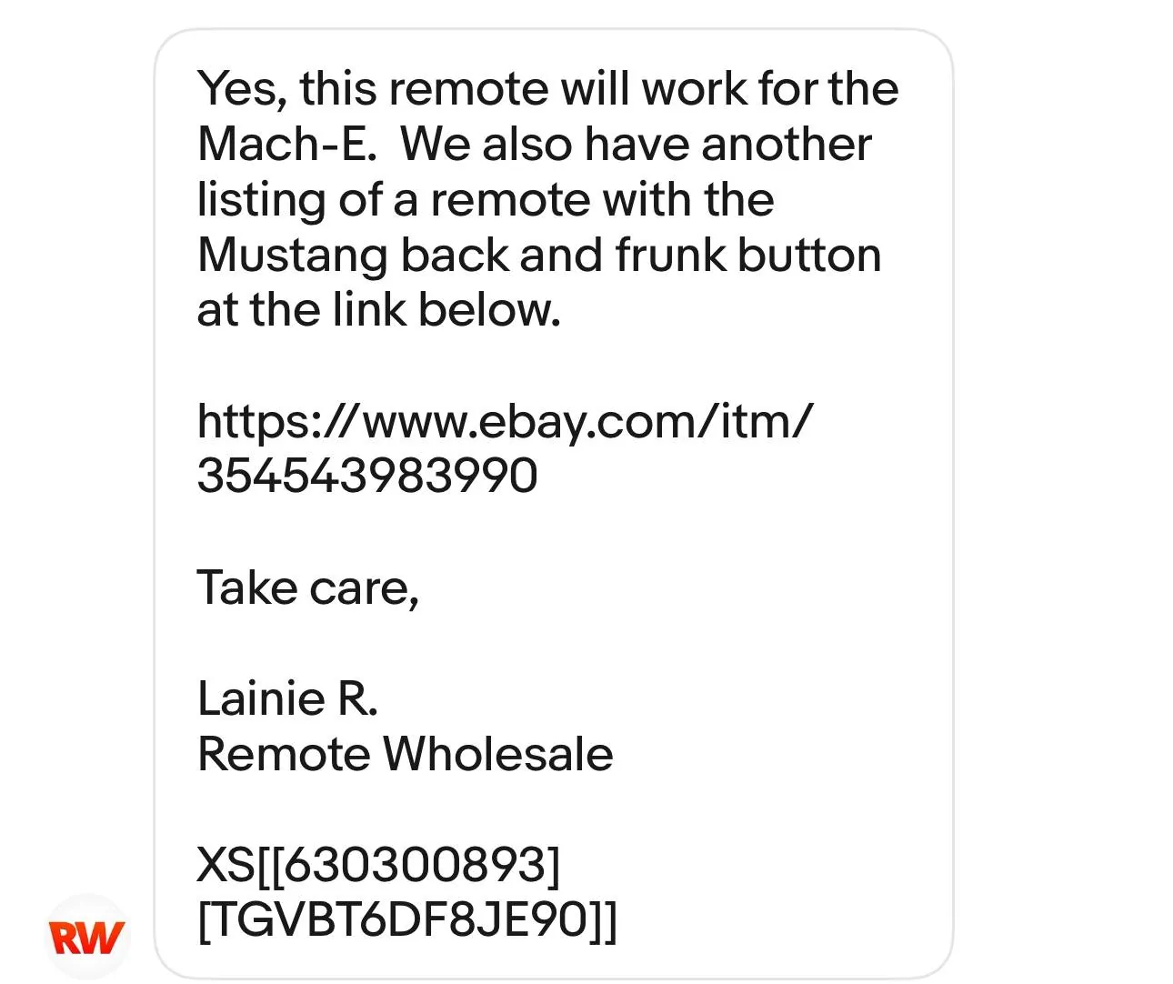

That same company told me if it looked a little deeper you’ve seen one for your Mustang . Oh well that’s me measure once cut twice what he sent me if you’re interested.
The one for the lightning I got coming works, but it’s just doesn’t have the Mustang on the back and the front trunk on the button. It’s got the pick up truck. It’s fine.

True, but note that is not new, and is $125. You can buy a Lightning key (new) for $80 and a shell with needed button for $13 from the following sites:
https://northcoastkeyless.com/produ...ey-fob-remote-fcc-m3n-a3c054338-pn-164-r8304/
https://www.ebay.com/itm/285089737724
You will have to do the button swap yourself, but it isn't hard. I swapped the back from one of my existing fobs to the 5-button one, since the existing fob is now for emergency use only.
I suspect the item you quoted is actually a Ligntning fob with the button and back switch performed by the seller.

My 2021 manual does not say anything other than to contact a dealer. ?‍♂?
I actually never looked at the link eBay sent me for the Mustang version of the key that I ordered, which was for the lightning, which will work, and I’m glad I didn’t , For the Mustang is like $130

Probably. Make sure with the vendor that it operates in the 315 MHz spectrum. If so, it’s the same key I have. ??
Took a couple of tries, but it works Ta da!
Like I said, they did have the one for our car, but it was like another $50 so this one’s fine.
I think the reason I messed up the program in the first time is it looked like he put in the original key and then the new one he got and then the original it’s actually original your second key and then the third key key I just didn’t see it at that Time I was looking at the video.
