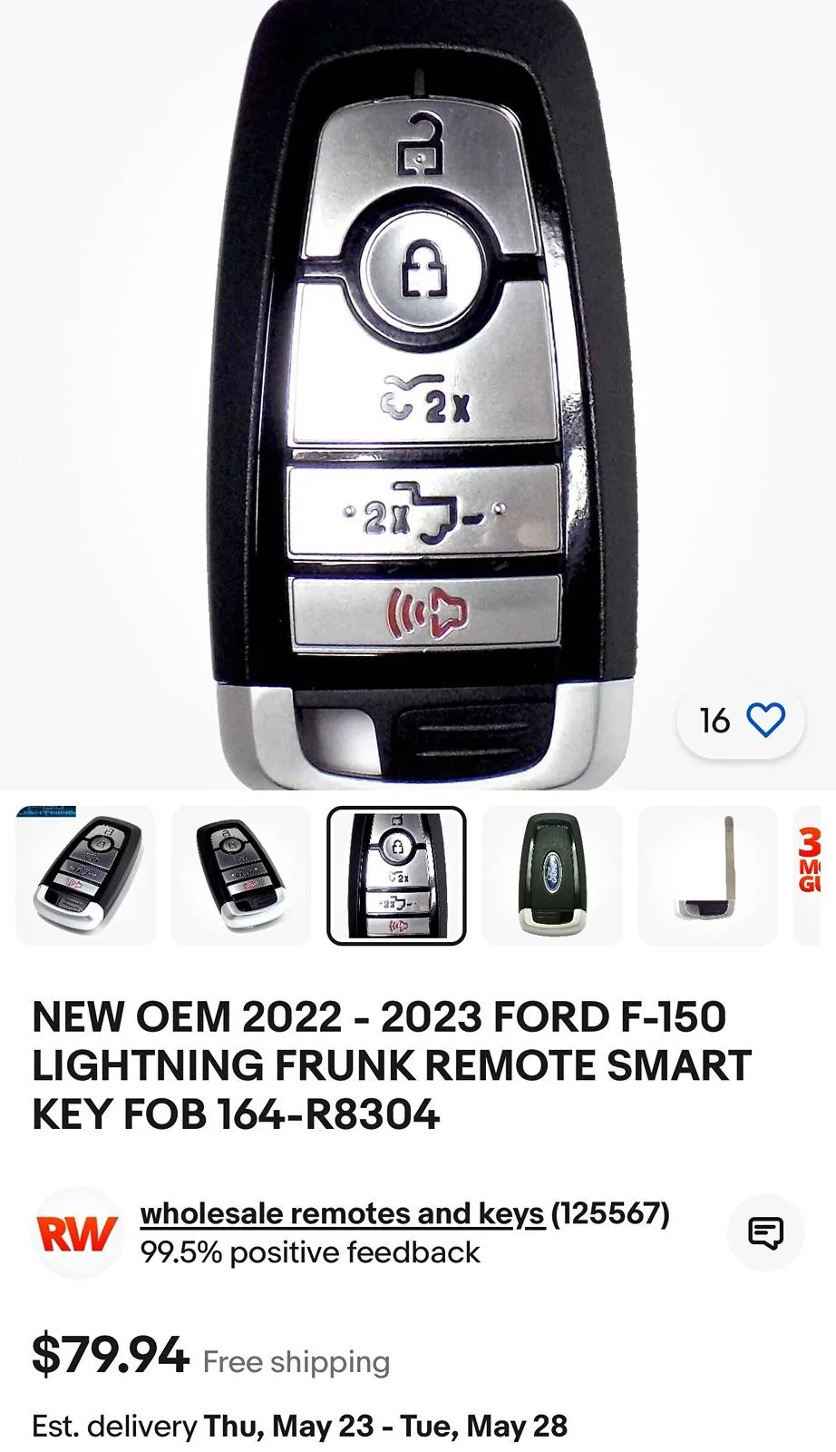

I bought a 5 button remote on eBay, followed the YouTube directions above with no success. After loading the 2nd fob in the counsel I don't see "factory keycard code" so the 3rd fob doesn't get programed. Not putting foot on the brake, tried with seatbelt connected and not connected, in WIFI router range and not. Any other suggestions?
What frequency does the remote operate on? If it’s not 315MHz, it won’t work. It needs to either be a MME key or a 2022-2023 F150 Lightning key. ??

The seller does not state the frequency just that it is compatible with the 22-24 Lighting. But I'm not getting that far,
The sell doesn't state the frequency just that it is compatible
with the 22-24 Lighting, https://www.ebay.com/itm/175666996092
Unless it wants to sense all 3 fobs, I don't think that's the issue. After inserting the 2nd fob I don't get "factory keycard code".

Will this work?
Probably. Make sure with the vendor that it operates in the 315 MHz spectrum. If so, it’s the same key I have. ??

Waiting on response!
FYI, I searched for the same key and this manufacturer had this information
  • Ford Part Numbers: 164-R8304 , 164R8304 , NL3T-15K601-EB , NL3T15K601EB
  • Strattec Part Number: 5944000
  • FCC ID: M3N-A3C054338 , M3NA3C054338
  • IC: 7812A-A3C054338 , 7812AA3C054338
  • Frequency: 315 MHz
  • Battery: CR2450
  • Emergency insert key, same as: 164-R8168, 5929522
  • Reusable: Yes
  • On Board Programming: No
  • 5 Buttons: Lock, Unlock, Front trunk release, Power tailgate, Panic alarm

#46 is for 4 button, I bought a 5 button (link is on #77). #71 is the same procedure as the YouTube video, no go. I'm wondering now if with my 2 functioning fobs, my phone is setup as a key, maybe the 4th is corrupt? Called my local dealership, they still don't offer a 5 button fob, even for the 24 Mach-E??? Service say for $75.00 they would try to program the Lighting with no guarantee.
