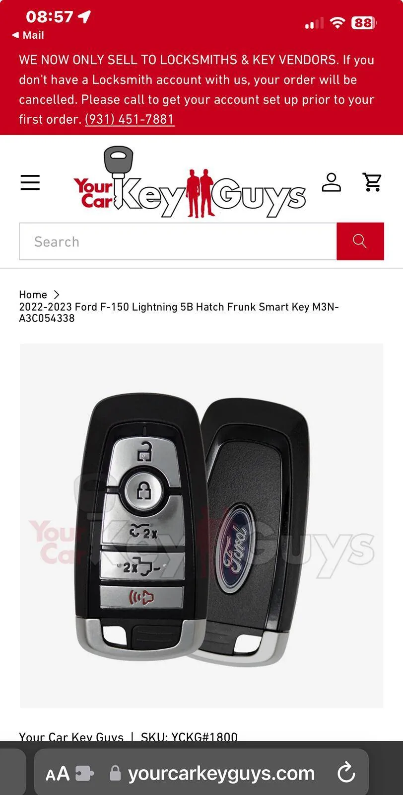

Instead of paying $80, pay $65. I bought the Lightning fob on sale for $56 during black Friday.
Lightning key with frunk and trunk buttons $70 - https://yourcarkeyguys.com/products...htning-5b-hatch-frunk-smart-key-m3n-a3c054338
Mach-E key with only trunk button $65 - https://yourcarkeyguys.com/products...e-black-logo-smart-key-4b-hatch-m3n-a2c931423
I figured this was a good idea and I was going to go grab one or two of the fobs with the frunk button, and this came up on the website☹

That is a very recent change. Wasn't there when I posted the link.
