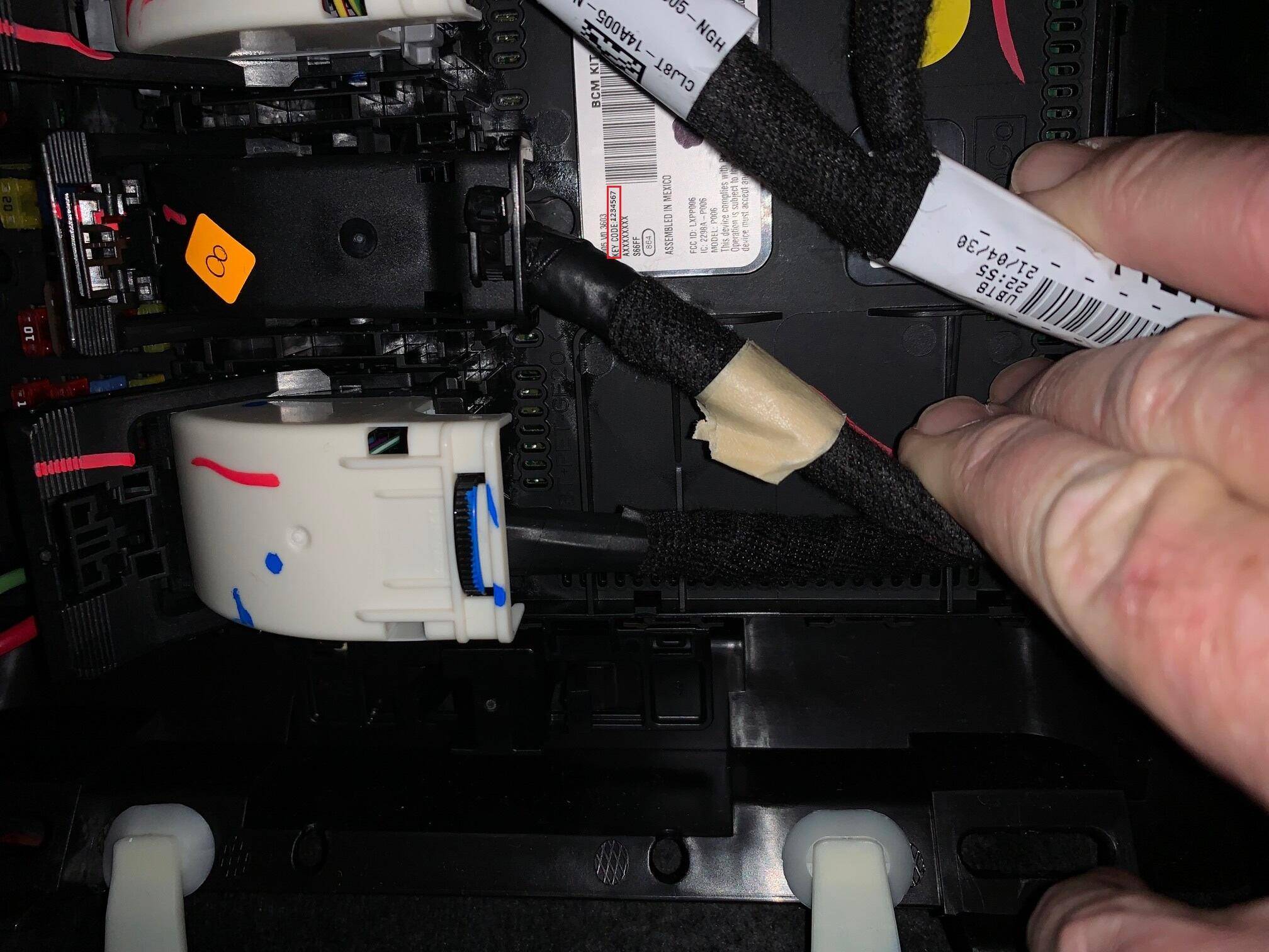

Passenger side footwell (on LHD cars). Pull up and back on the panel on the floor to reveal the BCM module with the code printed on the sticker (red box) . In the US only 5 of the 7 digits are used. In other locales all 7 numbers are used as the door code.
Worked a treat and I now have my code. Cheers.
I lost the card on a previous Ford that I owned. I stopped at my dealer and they connected and gave me the code. It took 5 minutes and there was no charge.

Left hand footwell of a RHD (proper driving position) car.
Well it’s good to know that from now on we can just tell people to look behind the panel in their passenger side footwell regardless of what country they’re living in and that’s where they’ll find the code.
