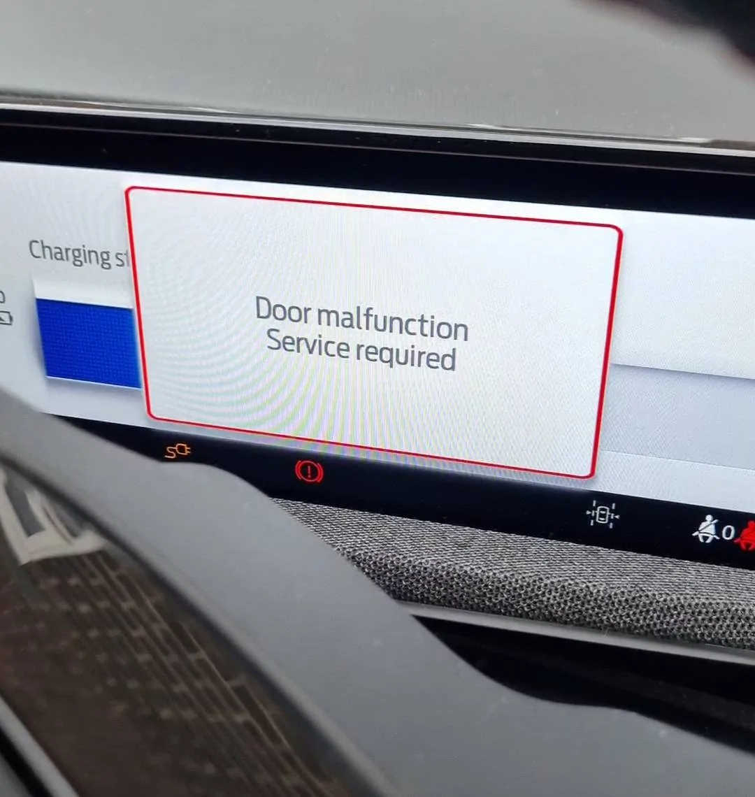

Hello everyone,
I have the same issue. After my 2021 Mustang Mach-E had been parked for three weeks due to a holiday, I received the door warning. I had never experienced any problems before that.
The message is: Portier Storing, onderhoud z.s.m. (Door fault, service required).
Ford Mustang Mach-E Door Fault - Service Required Afbeelding van WhatsApp op 2025-08-14 om 20.01.04_373eaece
All doors are working fine and lock properly.
The car currently has 52,800 km (about 32,800 miles) on the odometer.
I’m based in the Netherlands. I visited the local dealer, who advised me to keep driving and see if the warning disappears on its own. It has now been more than a week.
Has anyone already found a solution for this?
Thanks in advance for any help!
