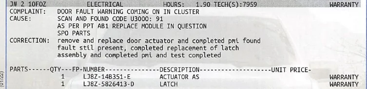

We have 5,800 miles on our 2022 MME and have had the door-fault-service-required for a while. Initially it seemed somewhat intermittent at first but now shows up every time we start.
Called the dealership where we purchased and we like - they are a smaller dealership - their 1 EV mechanic had recently left so we called another dealership and were surprised to be able to get an appointment for the next day at 8:30AM.
Today we took to dealership and were told they would have the car back by 3PM - we (wrongly) assumed with an appointment they would be able to do the diagnostics at the appointment time and we could wait - they did provide a courtesy shuttle.
Got a call around noon indicating that we needed to have the right rear door latch replaced - then the bad news - they did not have this in stock and they called only to find the part was back ordered they had no idea of when it would be available.
They again provided shuttle service to the dealership - a bit of confusion - was told to go to cashier to get key fob - turned out never made it there and was a the service manager keyosk.
They had the car charging on their 1 charger. - added 22 miles in about an hour.
I asked for the code they found - they described as general electrical issue - however on the printout where they reported they had ordered the part there was a "A99" which may have been the code for the right rear door latch - I've seen other codes in this thread in the 9x range.

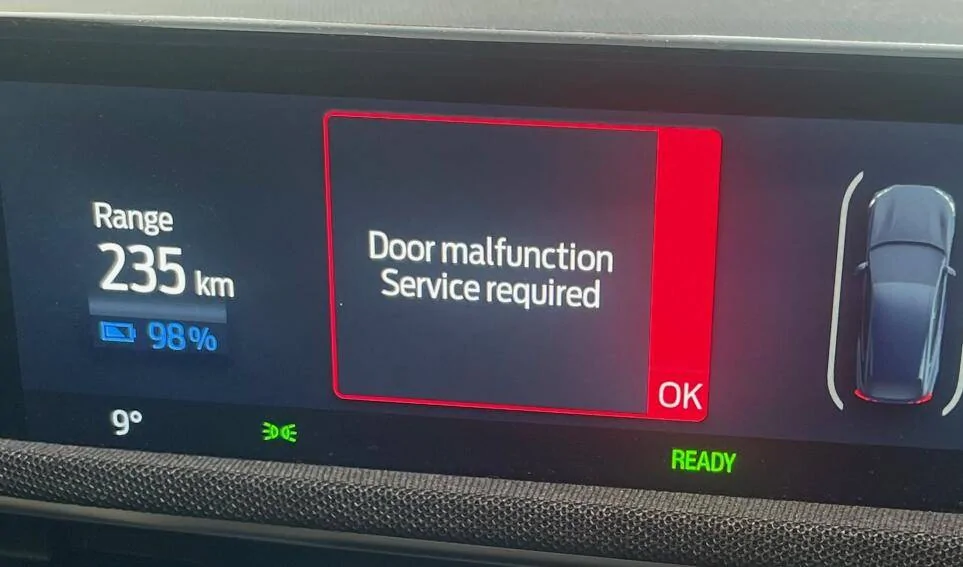

My fix. No longer need to press OK
Code U3000: 91 This was the rear driver side door. It took a few months here. Good thing not longer as I was starting to wearing out the OK button ;). Really not sure why the error as the door opened and closed fine. Maybe it is not locking? I never tested that as there was not much I could do about it if that was the case. I would just know that was the case which I really did not want to know. Never flew open on me which is good.

I finally got mine in for service. Looks like they need to replace the front passenger latch control module since it still errored out after reprogramming. They ordered the part and were cool enough to let me drive it like this so I just gotta wait for the part to come in and take it back for a quick (hopefully) replacement. All covered under warranty too. They also did Recall 22B28 which I thought I already had through OTA, but I guess I was wrong.
