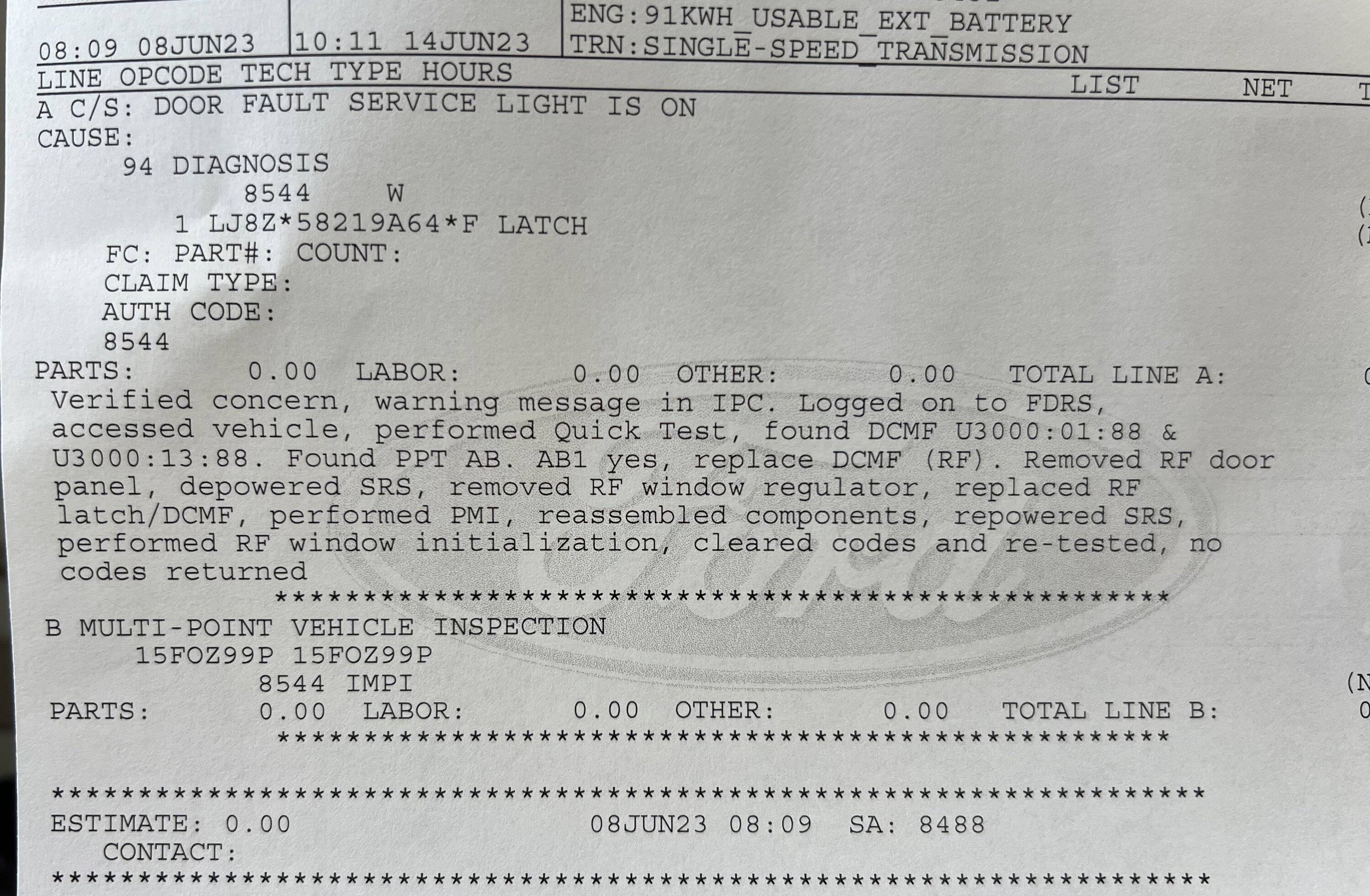

It took longer to get through the service center than I would have liked, but my problem has been resolved by or perhaps coincidentally with the replacement of a door latch. I wasn't asked "which door?" ?
Ford Mustang Mach-E 'Door Fault' Service Required IMG_2605
RF is your right front door. I guess they figured it out. :)
