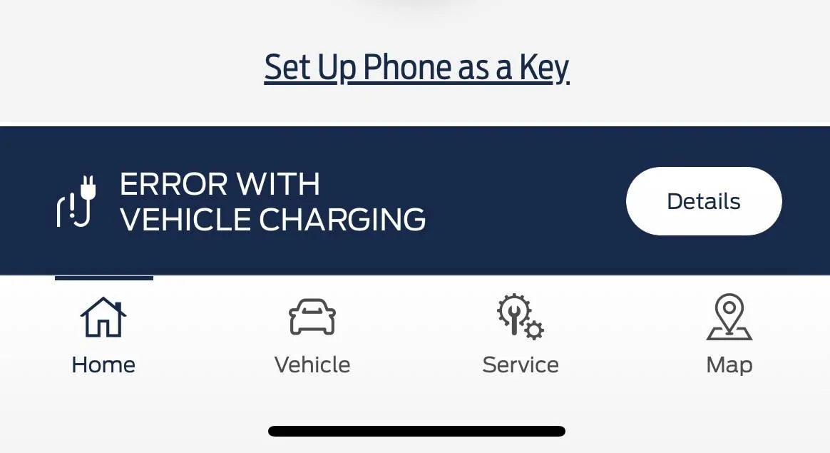

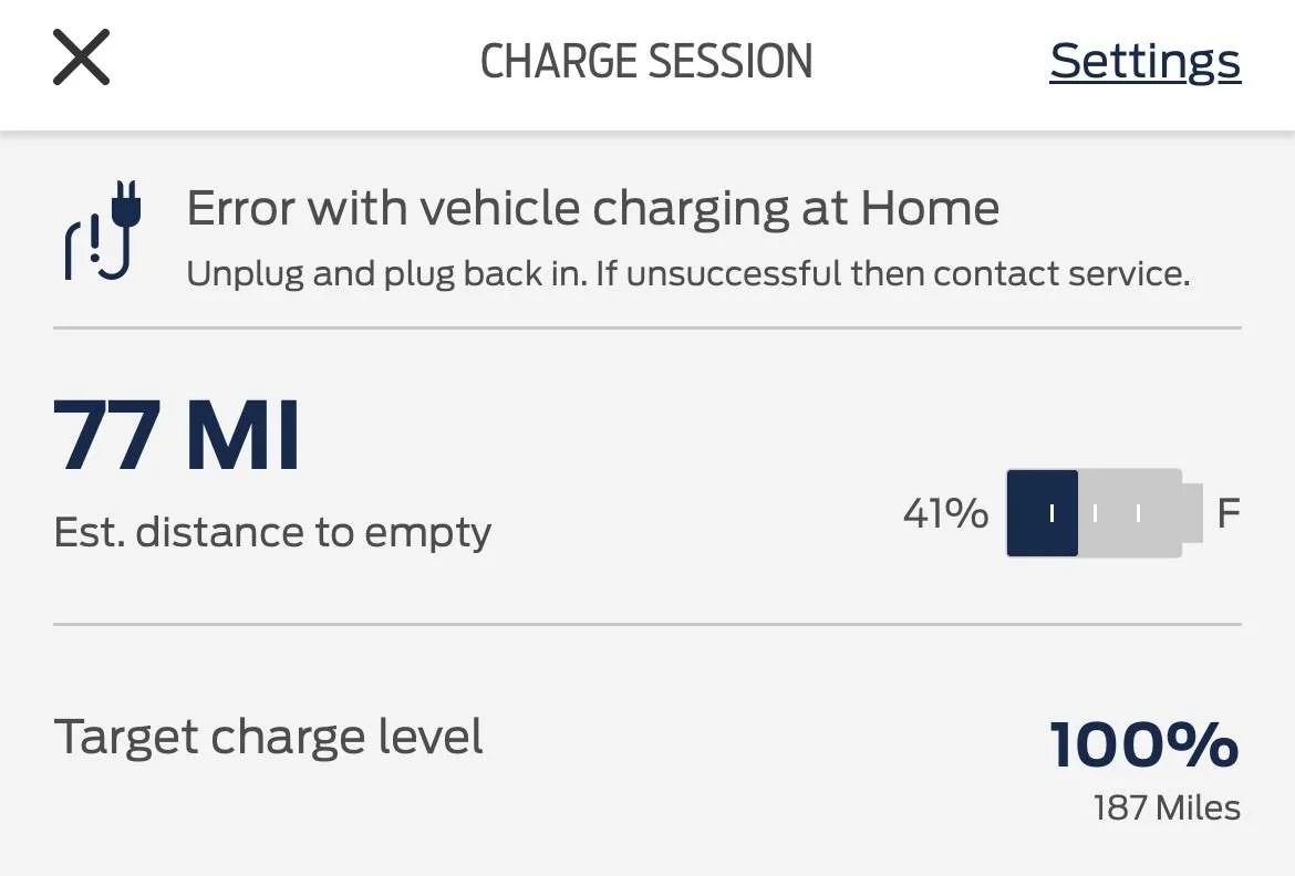

Plugged in my car last night and ten minutes in got an alert in the app that there's an issue with the charging. I went out to try re plugging it in but no dice. The LEDs at the charging port that normaly blink blue, were all red.
Am using the ford home charger which has the usualy blue LED.

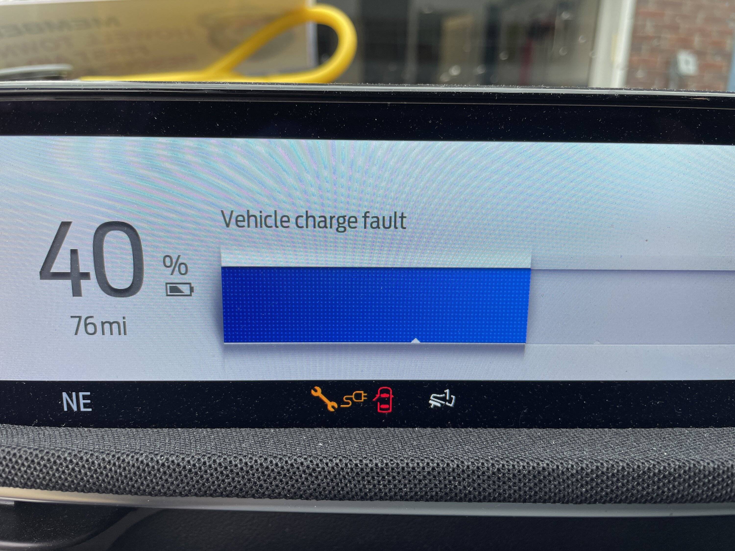

When I turn on the car I get a service message (vehicle charge fault.
Scheduled an appointment at ford tomorrow morning.
Anyone encounter this or know what would cause this error?
Error message in the app:

Service message in the car:

Yep got the exact same thing yesterday. 4.2.2 installed while the car was charging which created this problem. I was hoping it would clear itself by leaving the car alone for a few minutes but no luck. Luckily I had more than enough charge to take it to the dealer. They are on it now. BTW when I get it back I’ll turn off the automatic software updates! I’m done with that!

Happened to me right after 4.2.2
turuns out my Autel charger had not updated its Software.
once I updated software everything worked fine.

Happened again to me today After a few days of working ok. The Ford portable unit worked ok.
called Autel and they said there was a wireless connection issue that would cause a problem.
doesn’t make sense to me but reset my router and reset Autel and it’s working well again.
one more fault and it’s a new EVSE for me.
